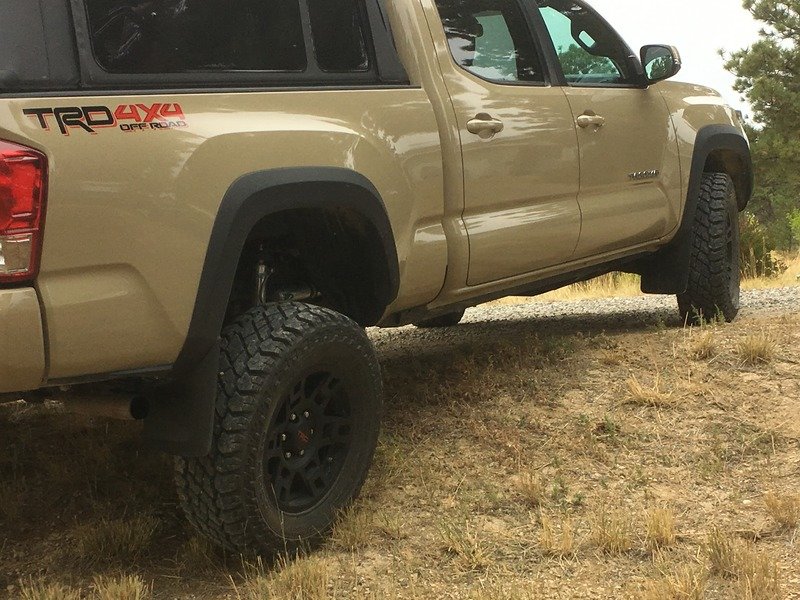

    Not sure if this is the right way to copy from another thread-https://www.tacomaworld.com/threads/new-bilstein-6112.358258/page-9

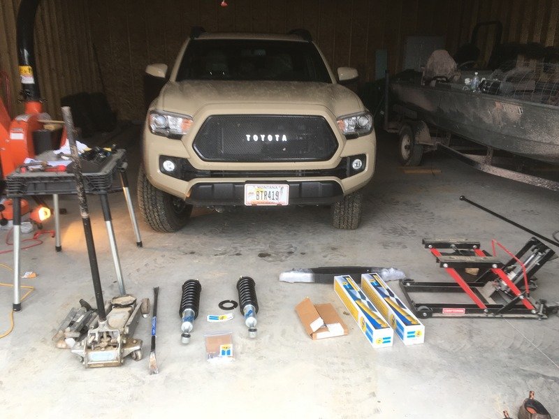

    I just installed 6112/5160 combo on my 16 TRDOR DC this past weekend. YotaDan was very helpful in this process- thank-you very much!
    Very nice riding combination. I would put them a definite BIG notch above stock. Not jarring, very capable on and off road. I took it out on a nasty piece of road up in the forest above my house and pushed through some serious whoops, mud holes, ruts etc- I'm pretty impressed. Road manners are spot on terrific as well.

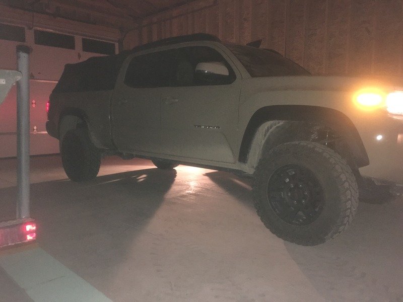

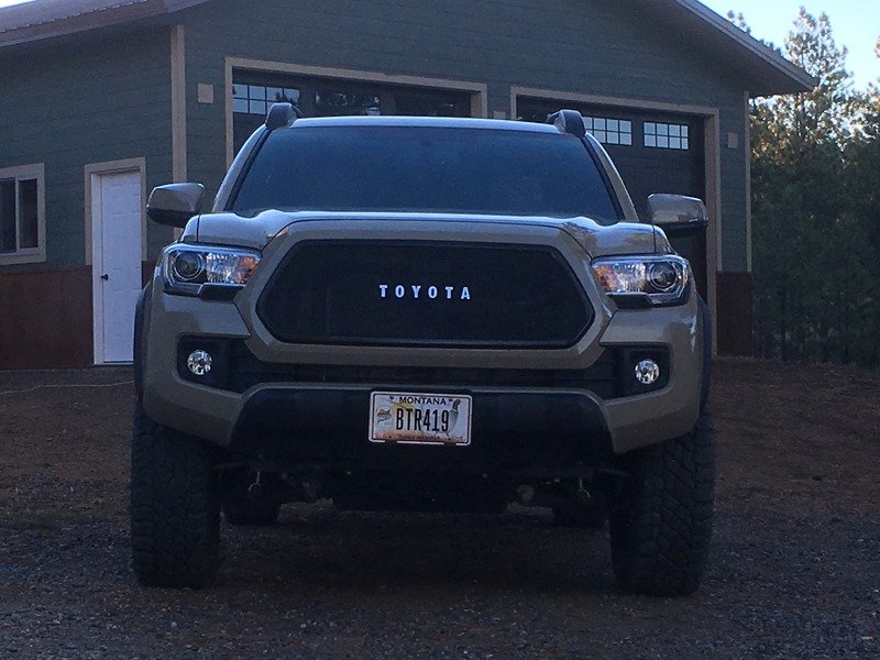

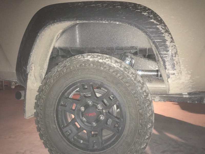

    I went on the mild side- 6112's set on notch 3 and a 1/4" spacer on the drivers side. Nice even measurements, basically gained 1.5" in the front (as advertised). I ran the Wheeler's prog 3 leaf add a leaf in the rear and gained 2" lift back there ( I removed the factory overload). I suspect it will settle to about 1.5" rear lift as well. Stock UCA's and I got it aligned yesterday and it all came into spec just fine.
    I run 265/70/17 Cooper ST/Maxx (E Load) tires on TRD Pro wheels, and I'm going to stay right at this size for the foreseeable future. What is interesting that this tire ran pretty harsh on the stock shocks- you could definitely tell it was an E rated tire. It's now virtually unnoticeable with the 6112/5160 combo. That was a pleasant surprise.
    C36D7442-CF65-48BE-A1BE-C82E8A280938_zps_4a8e36c4680bad96817ad1353093d44b6013e9e7.jpg
    No lights in my new shop yet- dark photos after install-

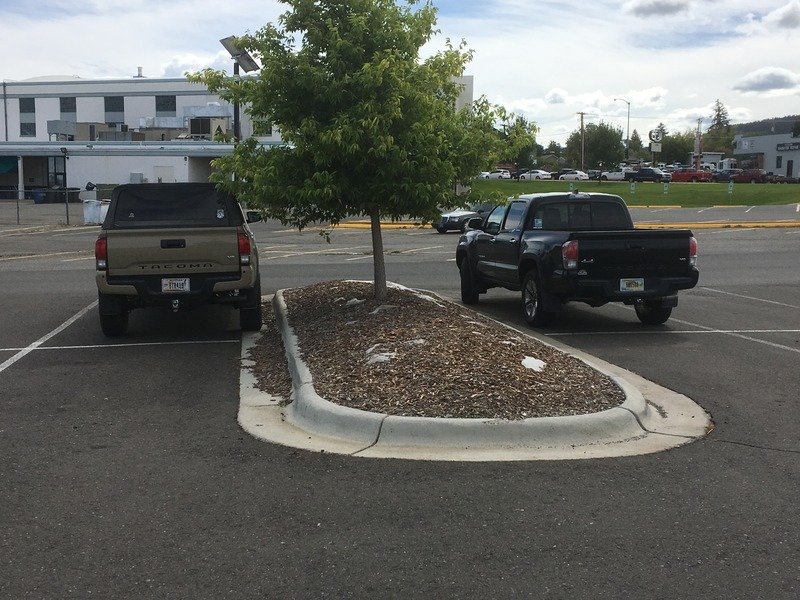

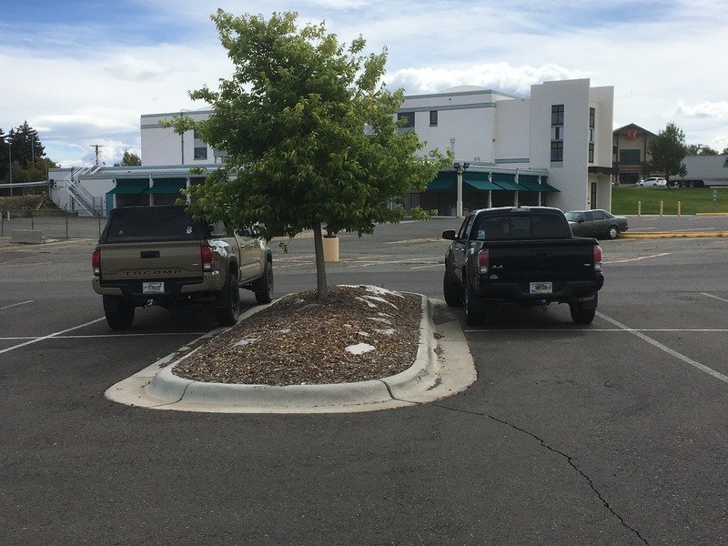

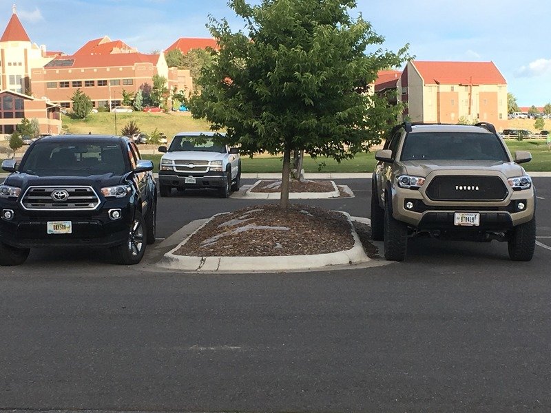

    Had a chance to park next to a 2016 Limited Tacoma at work-

    And there you have it

    Looks good with the 1.5 in of lift. Looks like a capable setup also.
