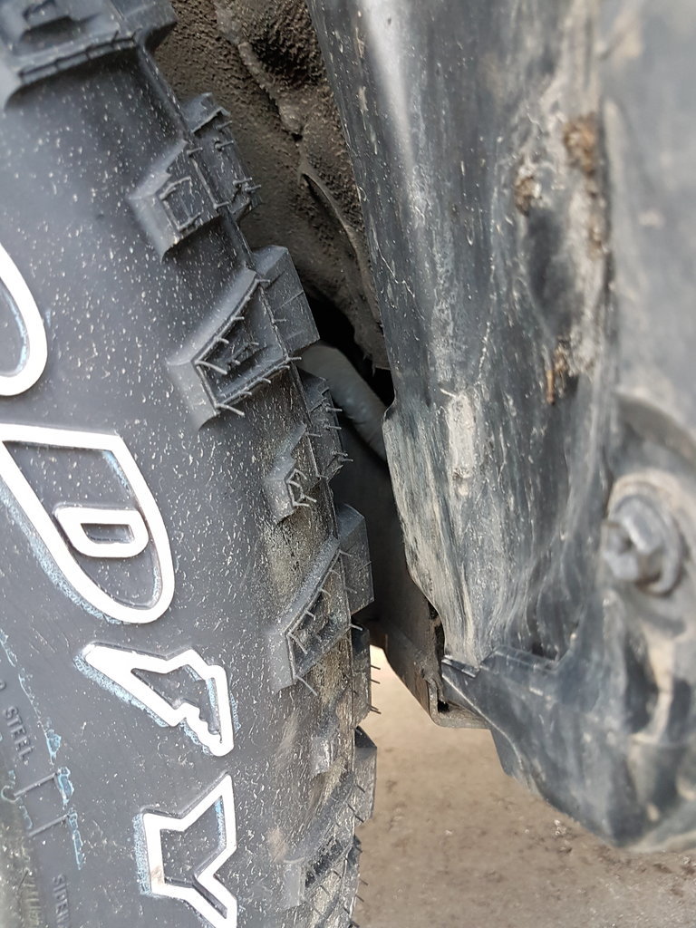

    So Joe - you're running (265/70r17) duratracs on a 17x 9 wheel with a 0 offset? And it only rubbed on the mudflap a little? Am I correct in assuming the 0 offset pushed your tires out quite a bit from stock, out past the mudflap edge?
  5. Sep 6, 2017 at 12:42 PM
    #45
    Joe23
    Joe23 Canuckistikian
    Oct 5, 2015
    #165909
    11,299
    The Great White North
    2017 TRD Off-road DCSB
    mine are 17 x 8
    4.5 back spacing
    Still have the picture from when I got them and posted about it here.
    That spot with all the dirt on it on the inside,is where it was rubbing.20170419_165756.jpg

    Appreciate the info... Stock suspension, I assume?
    Looks like my stock 17 wheel from toyota has 5.5" of BS on a 7.5" rim. I can now add your data of 265/70r17 on 17x8 ET0 to my pool of combinations that should work to my "accepted rub/ mod level". Not exactly a 17x9 setup, but a lot closer information than stock!

    You could probably just trim that plastic piece I was rubbing on but I really didn't care to find out I just removed the mud flaps lol.
    They rub too much off road anyways so meh.
    Originally kept the rears but they are also gone now as I broke one off road so just removed the two.
