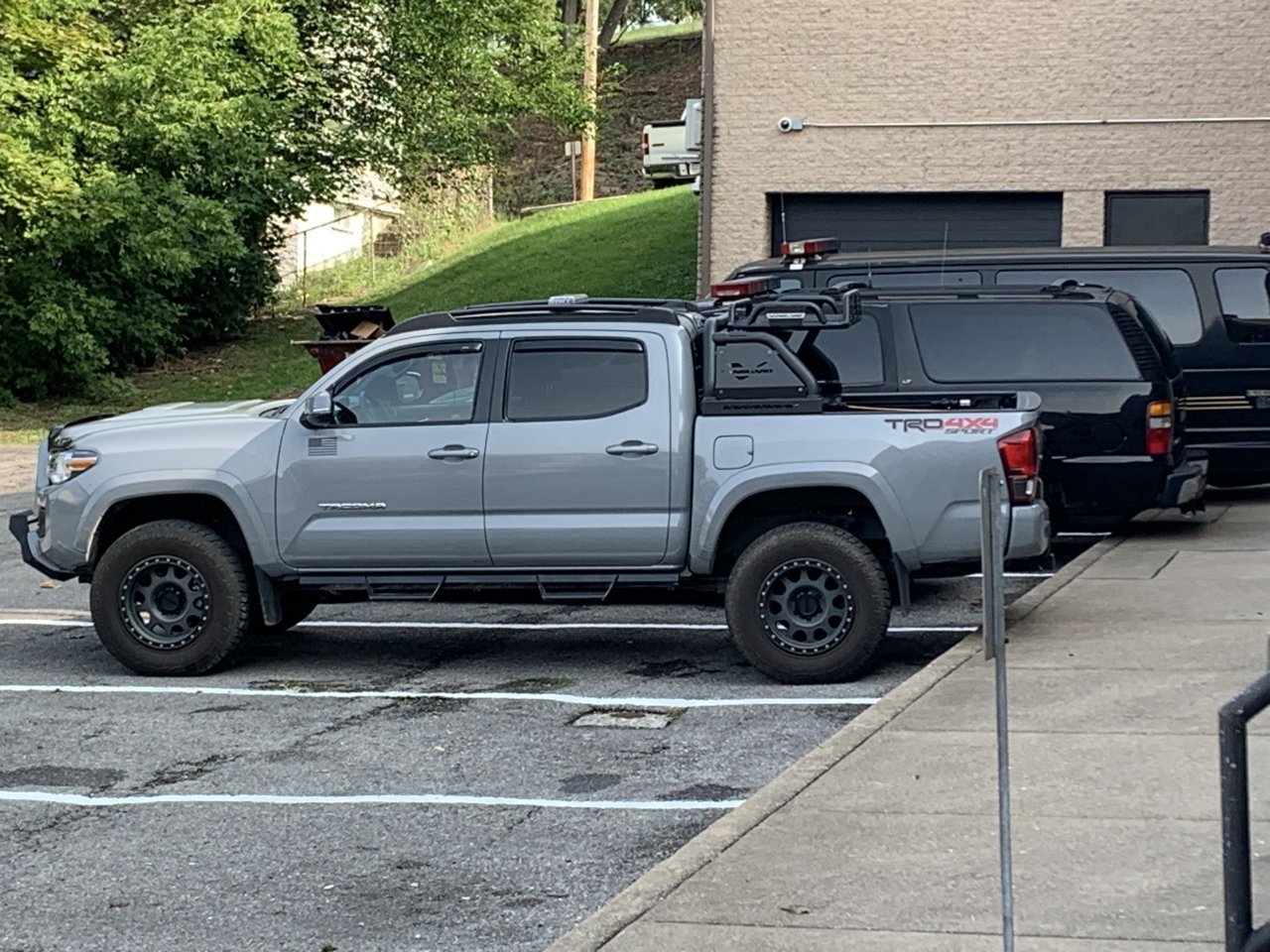

    39
    Robert
    Wanting to leave California
    5100's, ICON 1.5 rear add a leaf, train Horn, LED light Bar, hardwire front camera, LED headlights, taillights, and interior.

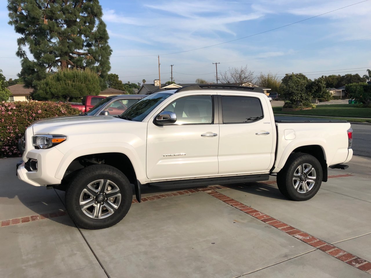

    I'm running the Limited 18" that came on the truck. I'm not an all black rim guy and until these get bent no reason to buy others.

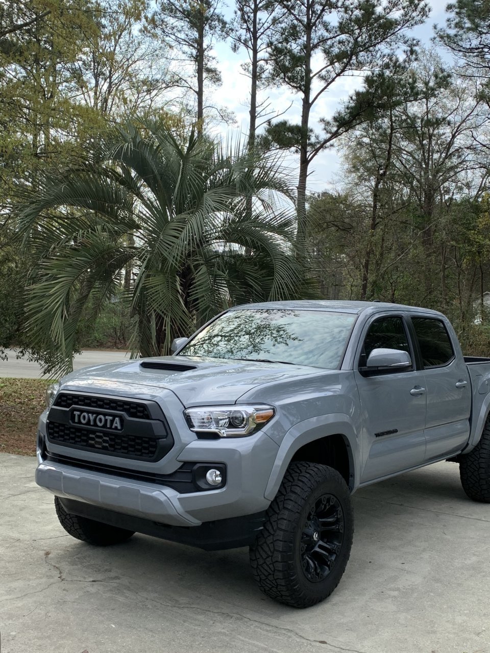

    Tacocop74
    Tacocop74 Member
    Apr 19, 2020
    #325252
    18
    Paul
    2019 Tacoma TRD Sport 4x4
    Vanguard Roll bar
    Found this thread late, but I am running 265/70R18 on my 19 sport (with an OME 2 inch lift with Dakar leaf springs). Tires are Ironman All Country A/T’s. Again bit late but I hope it helps

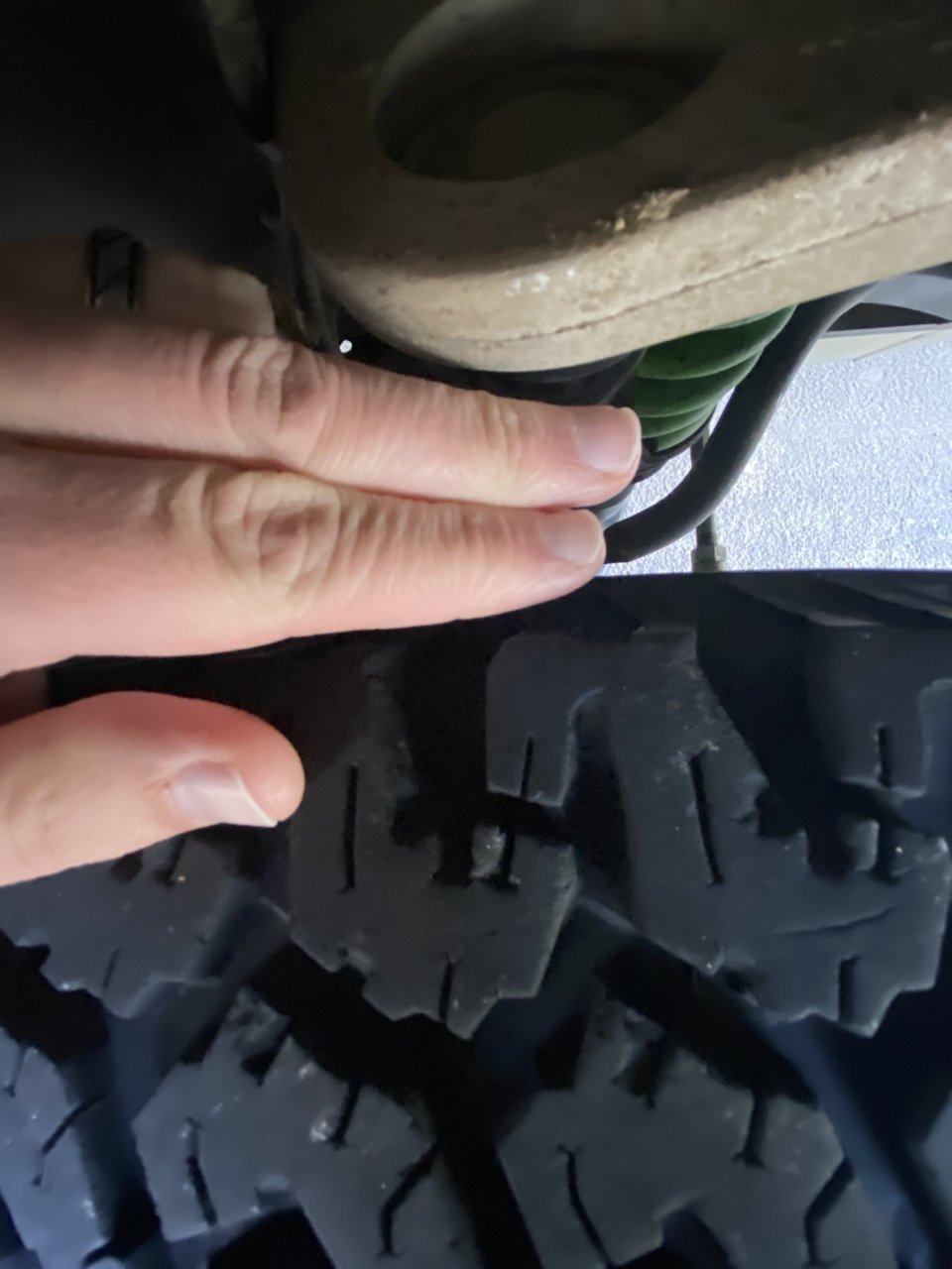

    My guess is you will be close but I'm thinking you will be okay if you stick with 265 widths. You already are almost .750" further away from the UCA than the wheels I have now. My wheels are not as wide as yours. They are OE wheels though and have a +30 offset. With 265/65-18s on these OE wheels I had a half of an inch clearance to the UCA. That was with pretty much a factory alignment.

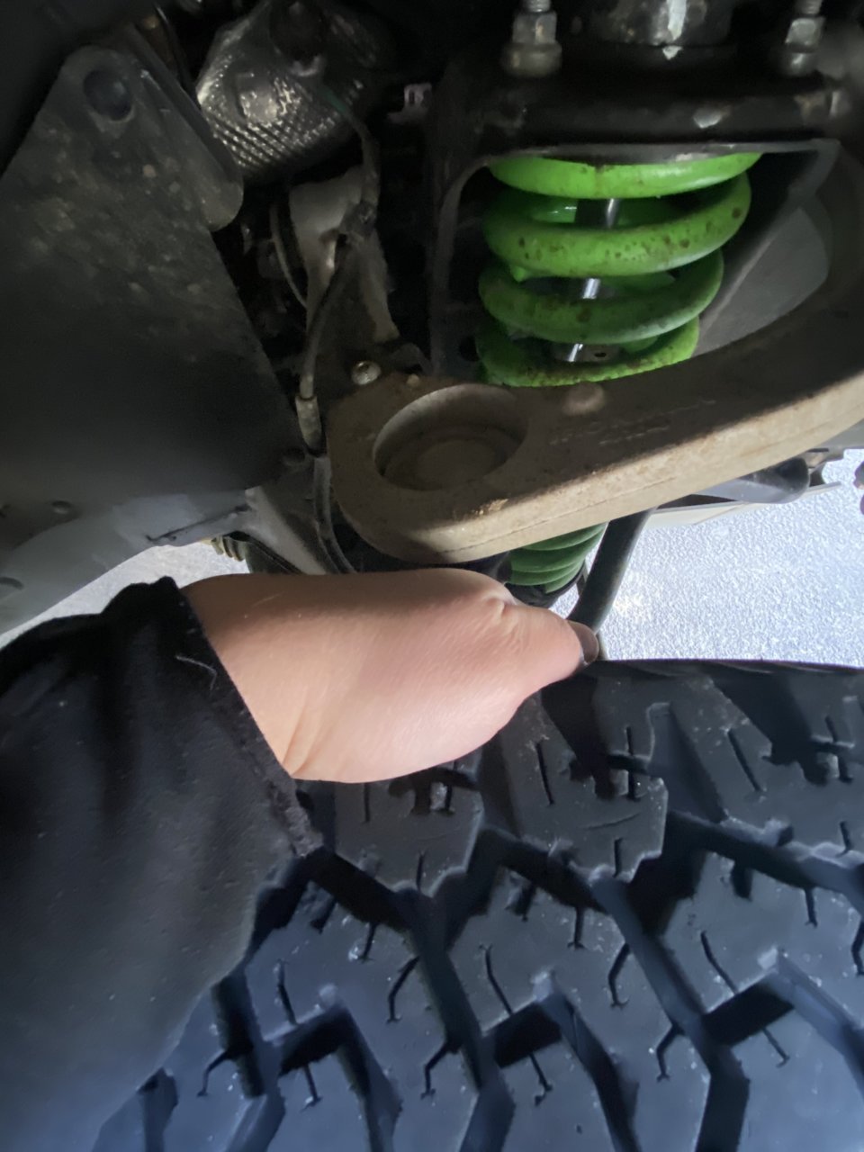

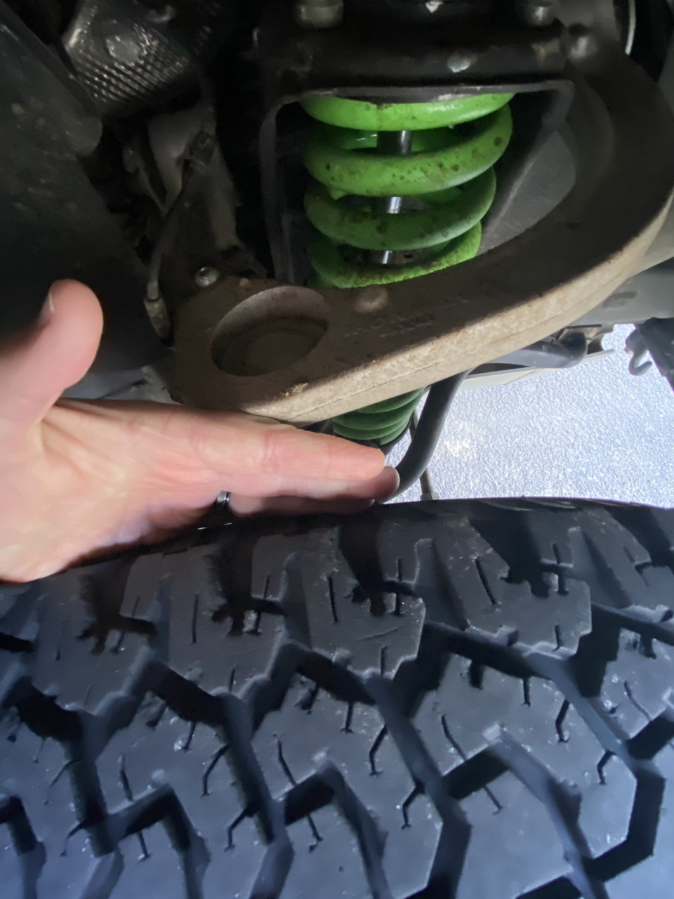

    That makes sense. decided to try this out and post it here for future interest. With the 5.5BS of the 18x9+12 and a 265/65/18 BFG KO. Here are photos of the gap. I have over an 1” space from UCA to sidewall.
