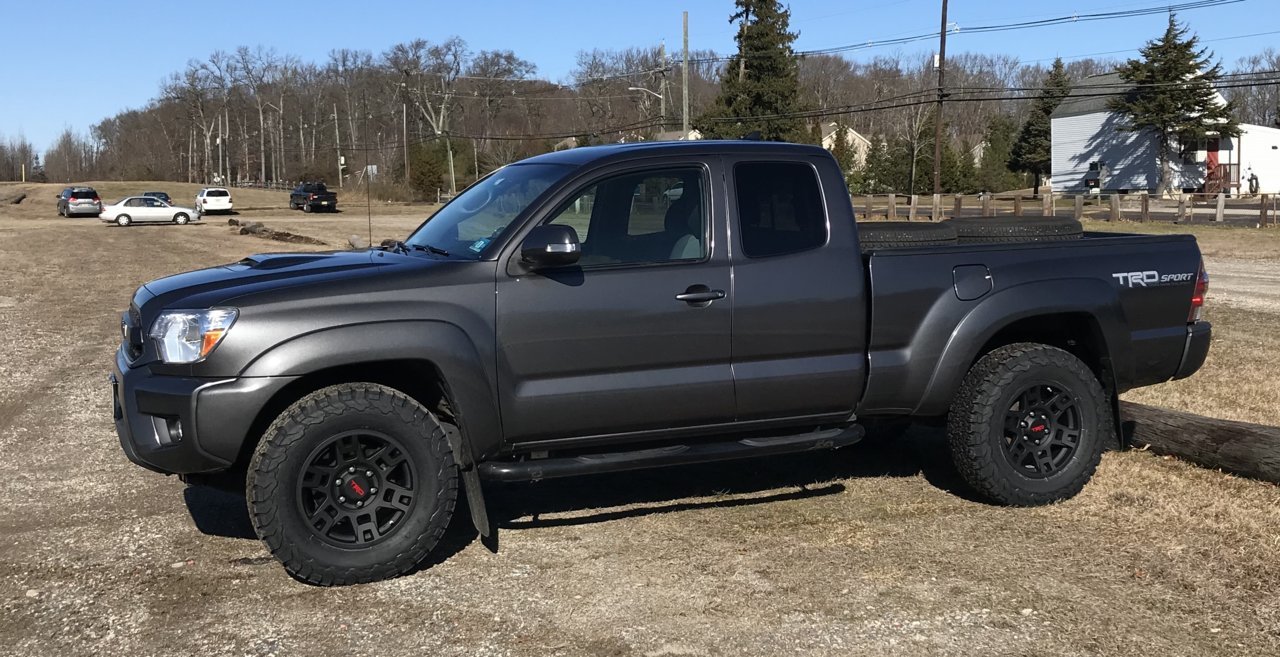

    I got my 265/70R17 C on the TRD PRO rims at stock height. I took off the small flaps in front on the front tires before I had the tires installed, so I can’t say if they rub on them, but the front tires do rub slightly on the inside “bulge” of the full mud flaps at full lock. I may take them of and do some alterations.

    I removed the full size front mud flaps and now have no rubbing.
    I also prefer the look of no flaps. I’ve had full-size fords prior to my Tacoma and they never had flaps, I understand the paintwork takes more of a beating, but time will tell. Never had an issue with my fords, plus I’m not pulling half the sh1t I did in my first full-size...blame that on maturity or lack there of!
