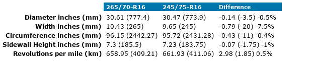

    In my opinion one of the downsides to the all terrain style tire I'm thinking of getting is that they weigh 15 pounds or more than my current tires. I'm not sure how much of an impact this will have on my mpg, but I'm sure it's not all that good. So I thought what if I get a narrower tire with a larger aspect ratio? The outside diameter is only slightly less, the width is .79" smaller.
    This is what the tire calculator came up with
    Will these fit on my 2003 Tacoma V6 TRD 4X4 stock rims? Does my reasoning make sense or should I just stick with the stock size? Also I have a minimal 2.5" lift via Bilstien 5100's a rear AAL.

    Make sure the tires you're looking at are compatable with the wheel width you have. Otherwise, at least for 2nd Gens, both of the tire sizes you listed are stock sizes. As long as the wheel isn't too wide for the 245 series tire, I see no reason why you can't go with that sized tire.

    Good Point, I wasn't considering that not all tires are exactly the same even if they are the same size.

    Please remember tire calculations are meaningless. One particular 245/75 could be taller than another 265/70. Look at actual sizes of the tires you are interested in.
