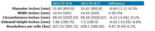

    They're damn near the same as a 265/75R16 (slightly smaller actually). When and where are they hitting the frame?
    from the online tire size calculator
