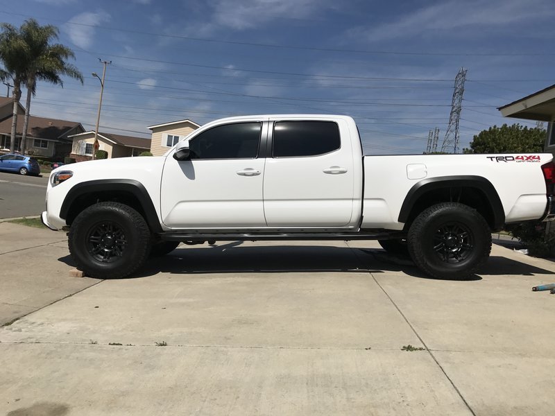

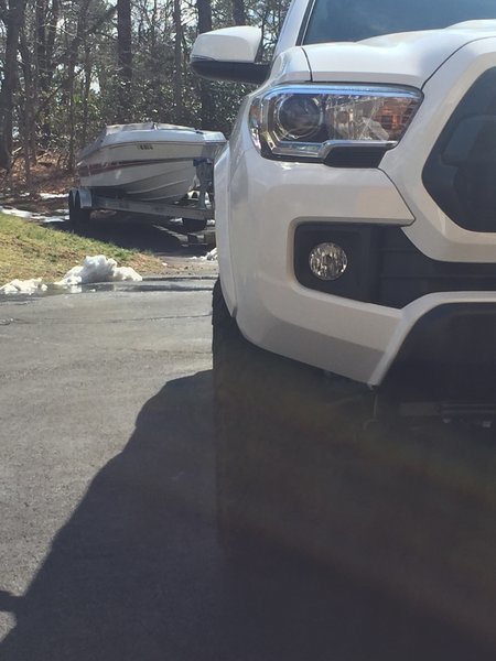

    They should fit without a lift. Had mine on with stock suspension and it was fine but now have bilstein 5100s at .85 and this is how it sits.

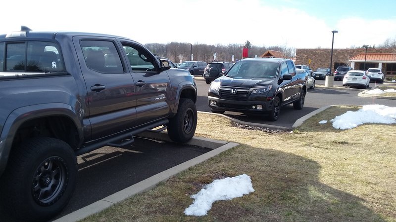

    5100s with 885s and Icon progressive AALs in the rear with 5100s set to ZERO... 265-70-17s
    Oh and threatening a Honda ... the Honda came with a murse... I checked, there were actually 2 of them in front passenger seat, quivering ( <-- see what I did there?).
    Edit:
    was like that b-4 lifted AND did not rub.

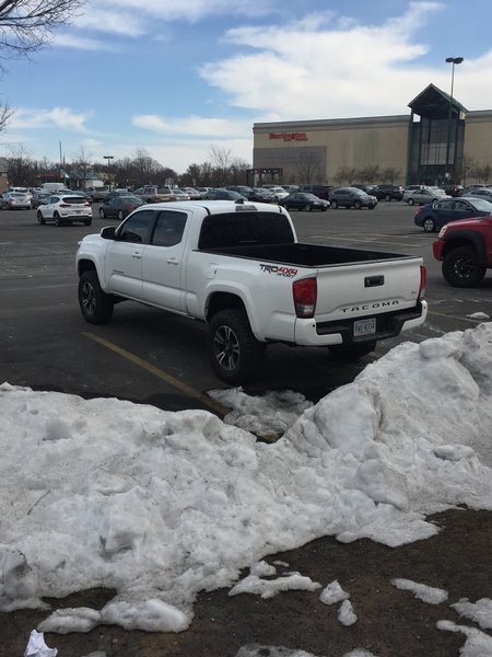

    265/70/17 bf Goodrich k02. 5100 all the way around, ome 887 coils, single deaver AAL. 2" and some change lift. Oh and I needed wheel spacers 1.25 spider trax. IMG_6770.jpgIMG_6693.jpgIMG_6775.jpgIMG_6764.jpg

    Its gonna come down to the wheels with this tire size. You can see above, stock OEM wheel he needed to push the tires farther away from the truck so he installed spacers. On my wheels with a -6 offset no problemo.... does the same as spacers without the spacer.

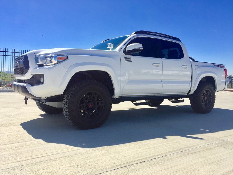

    Dremeled out hood scoop. Added new wheels. PlastiDipped grille/hood scoop/fenders/front bumper lip Falken Wildpeak AT3W Method Race Wheels NV305 Icon Vehicle Dynamics Stage 1 Suspension Kit
    Falken Wildpeak AT3W: 265/70R17
    Stock lift

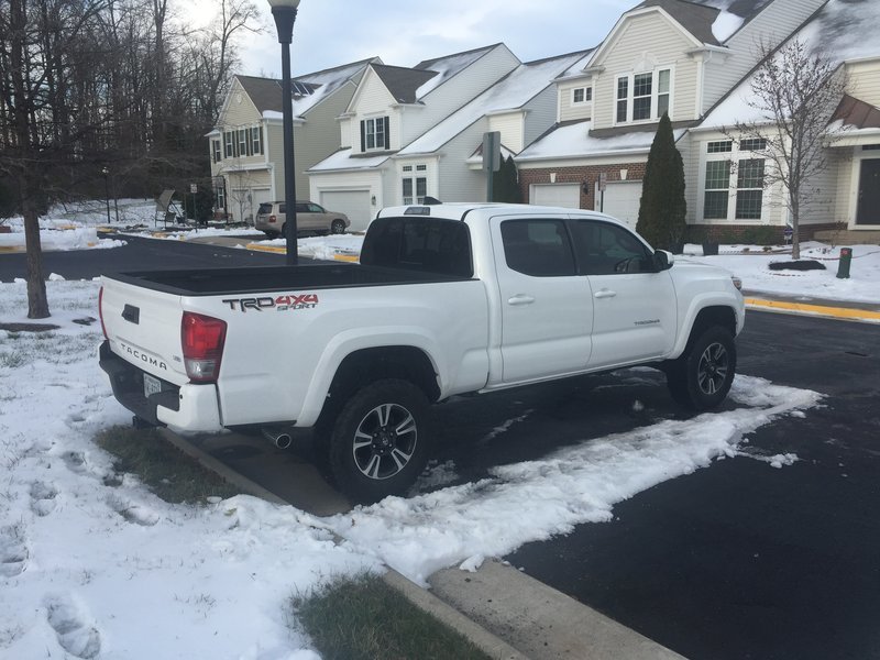

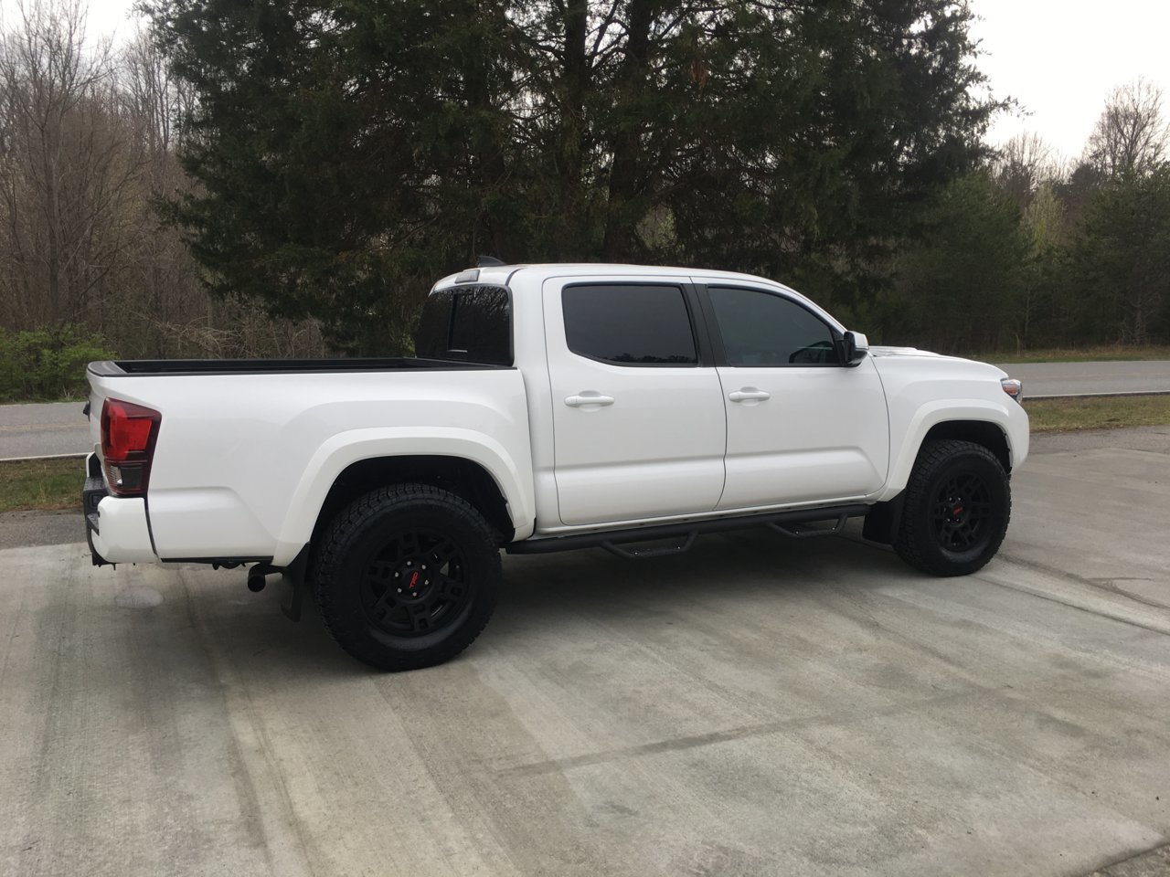

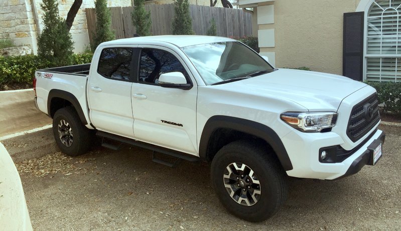

    I purchased my 265-70-17 Falkens before I lifted. I drive TRD OR, I had major rubbing issues. I’m good to go with a 2” lift.
    I did put after market wheels on with -12 so that likely had something to do with it also.
