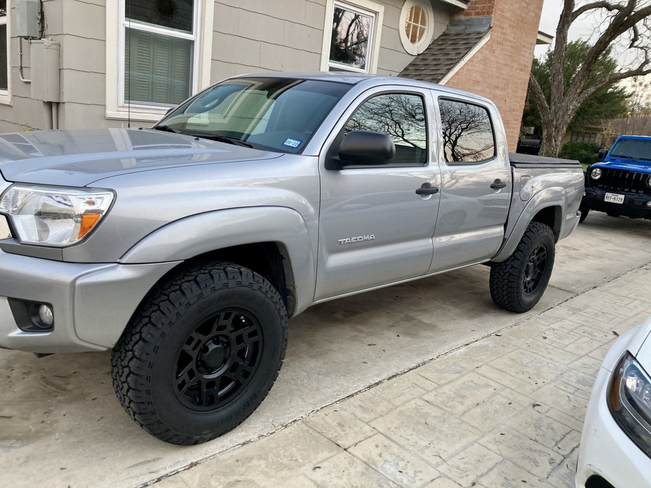

    I just did 4runner TRD pro wheels PN: PTR20-35110-BK on my STOCK 21 Tacoma DCSB OR with 265/70/17 KO2's and I dont rub street driving at all. I have my mud flaps too. Not sure about when I go offroading. But so far no rubbing at all full lock to lock.

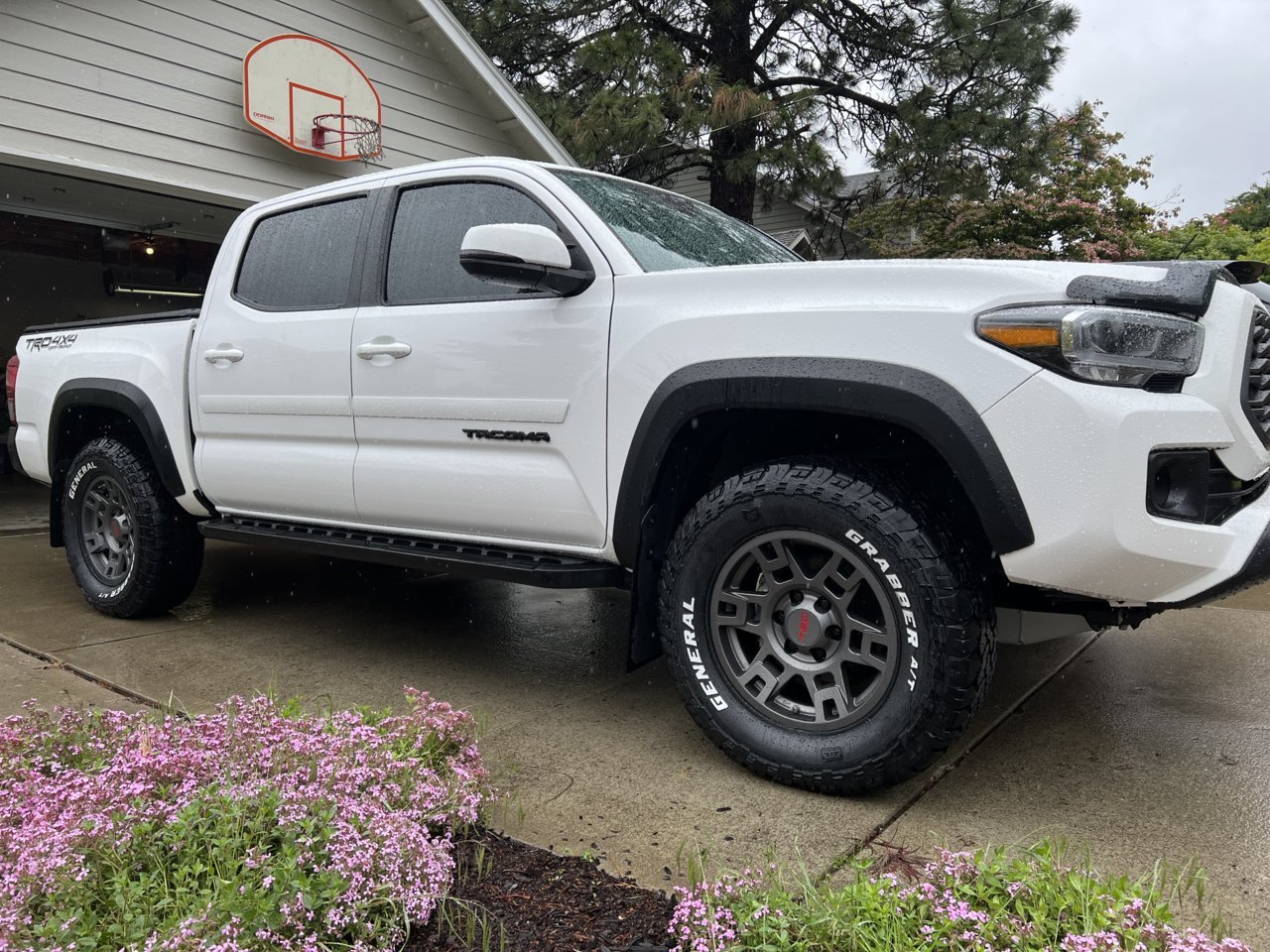

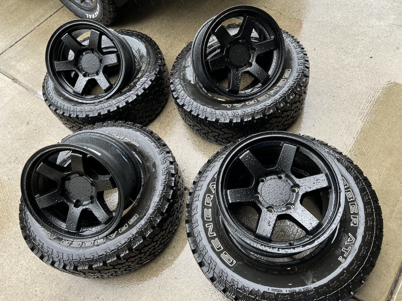

    FAE5807F-7757-4C2D-A800-4913D2326F4C.jpg Stock susp with 265/70/17 General Grabber ATX SL load and RokBlokz, No rubbadubdub! I should have gone this route in the first place. Now I have to sell these…

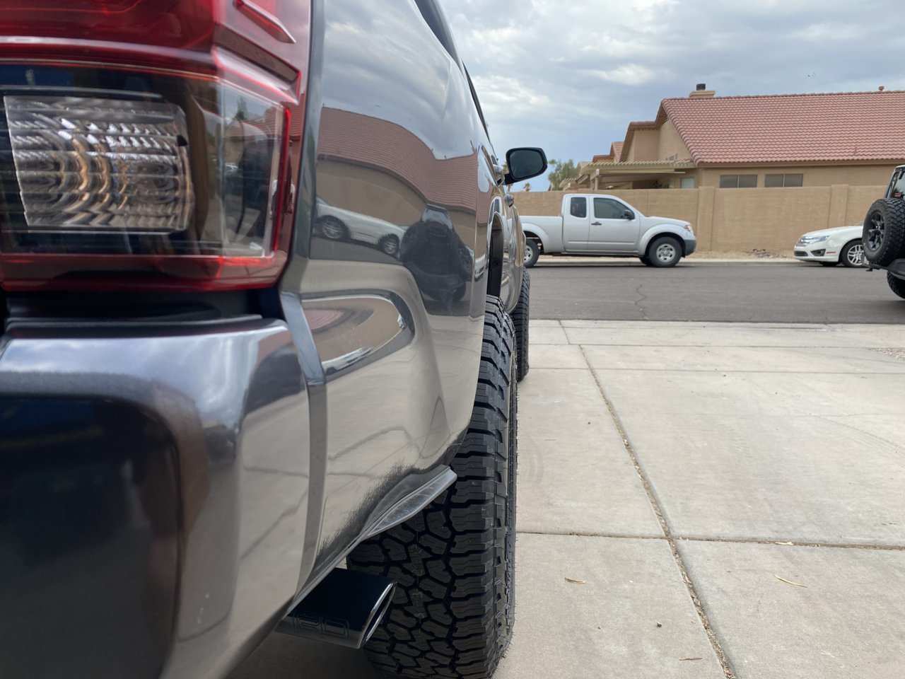

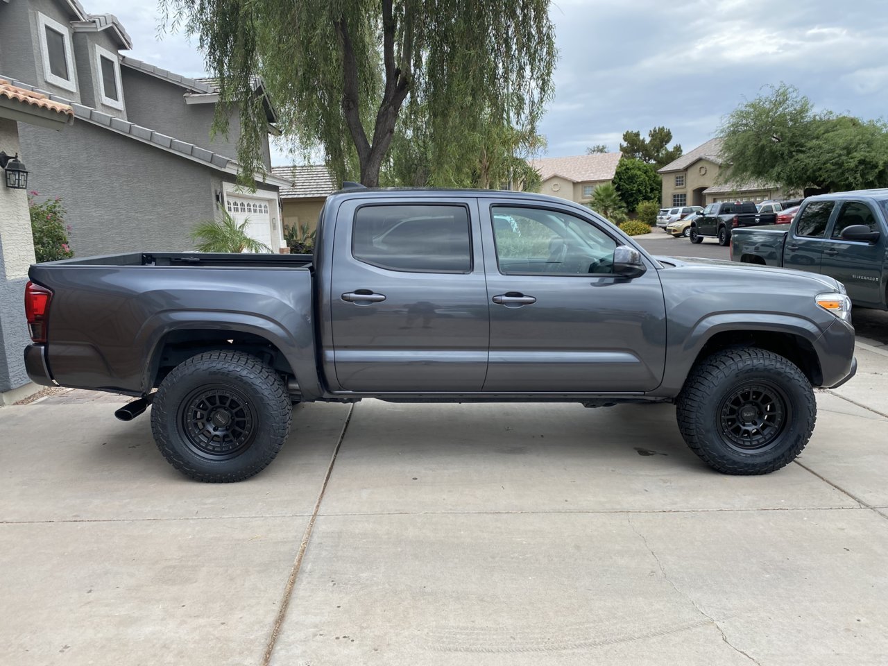

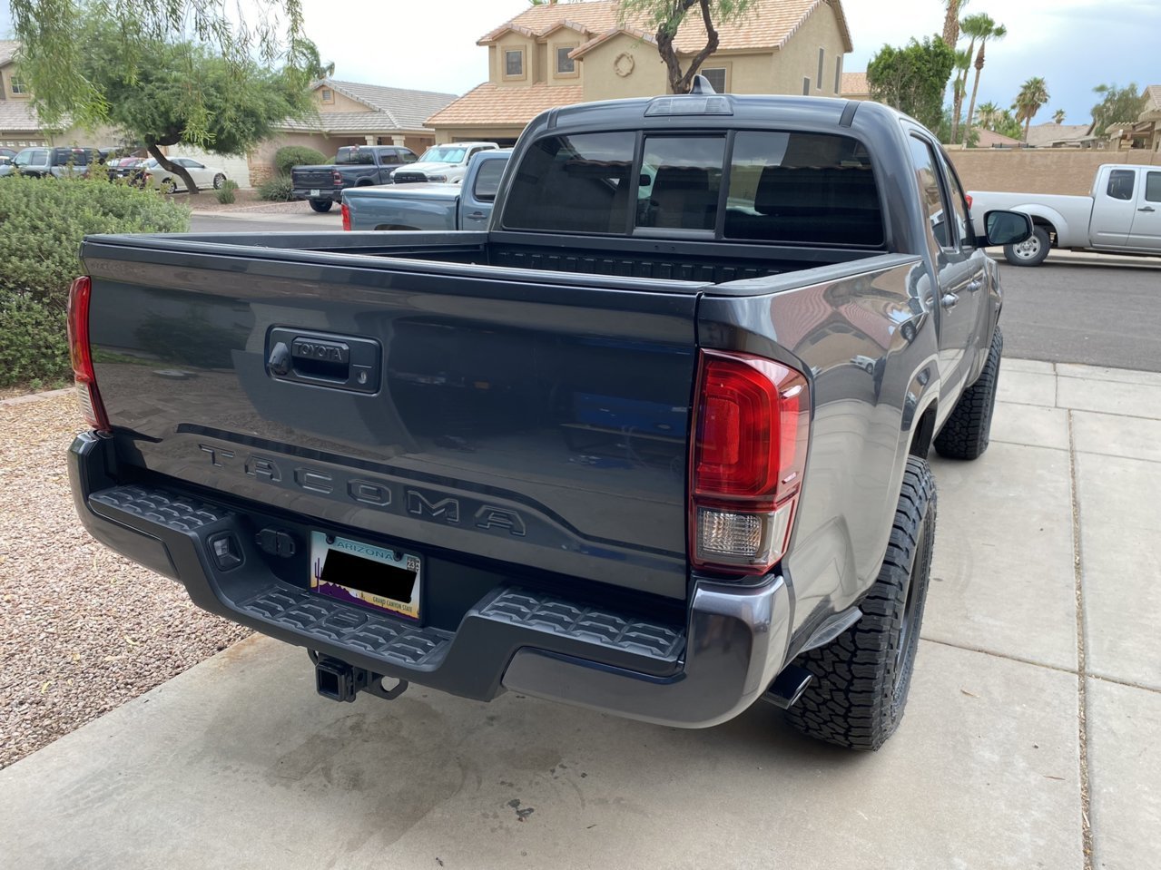

    Just put these on today
    41E910DA-F11B-40D2-B5A8-CB63794125D6.jpg F063BB09-DB60-44D2-8B60-DF91817B15EA.jpg 584D9208-AAD4-4806-B45B-E44A4031546F.jpg
    KMC Canyon KM719 17x8.5 0mm offset with Falken Wildpeak AT3 265/70/17
    Haven’t taken it off-road but and have not had any rubbing on the streets
    Update:
    Did some wheeling today on a moderate trail and had the suspension flexing without any noticeable rubbing. Closest the tire got to the fender was about 1/2” from what I could see

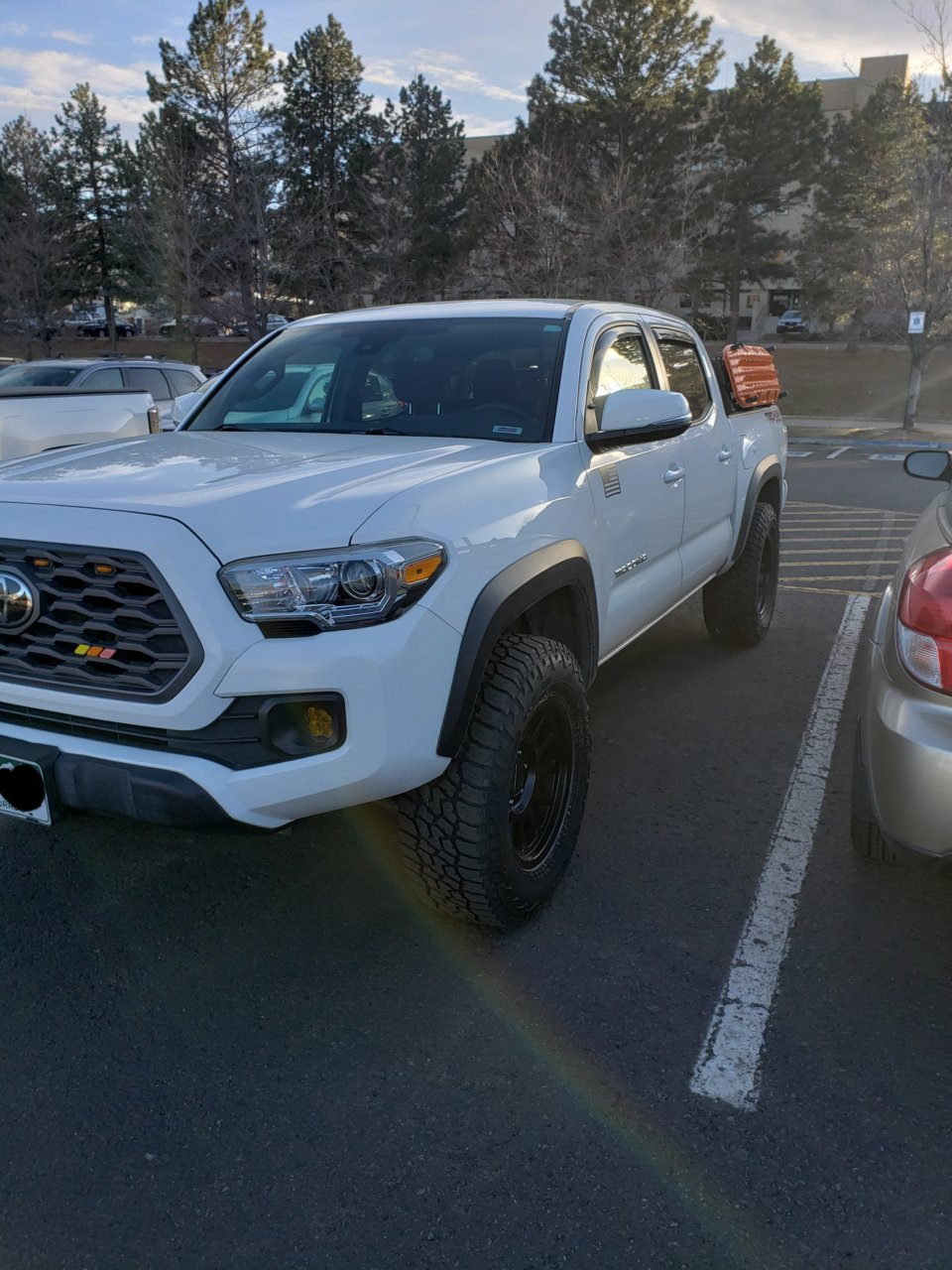

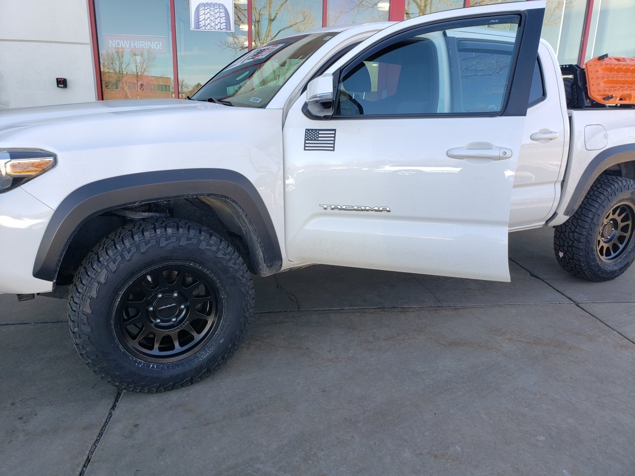

    Just got em on 265 70 17 falken wildpeak at3w on method 703s in black, 17x8.5 with no rubbing:)

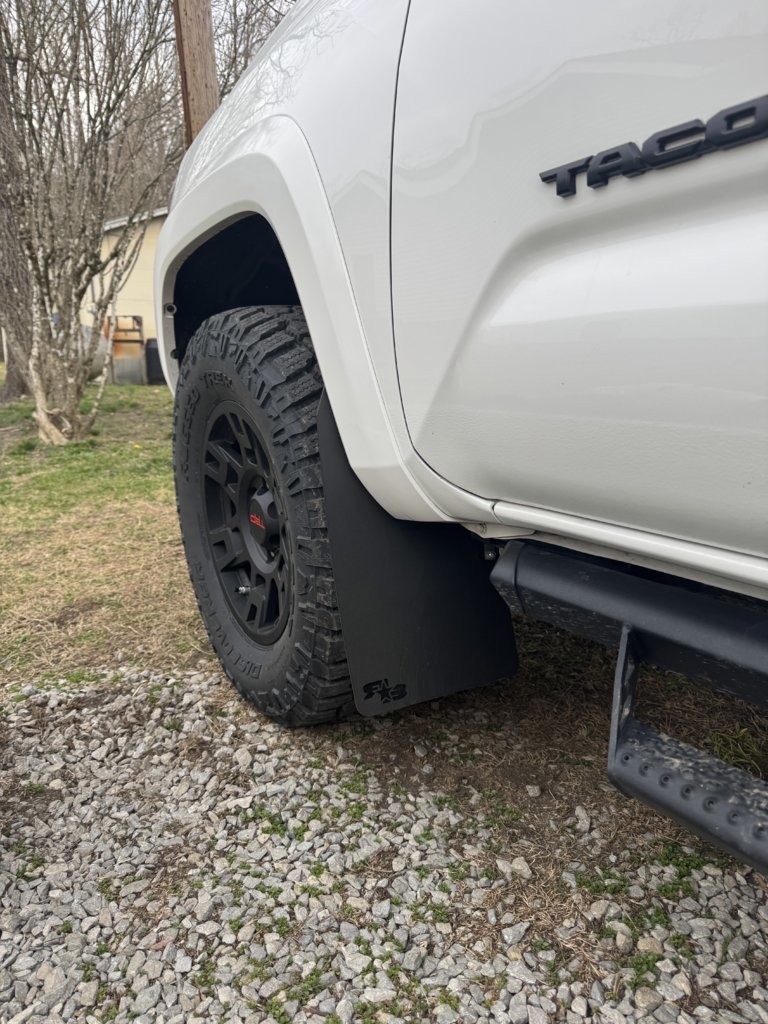

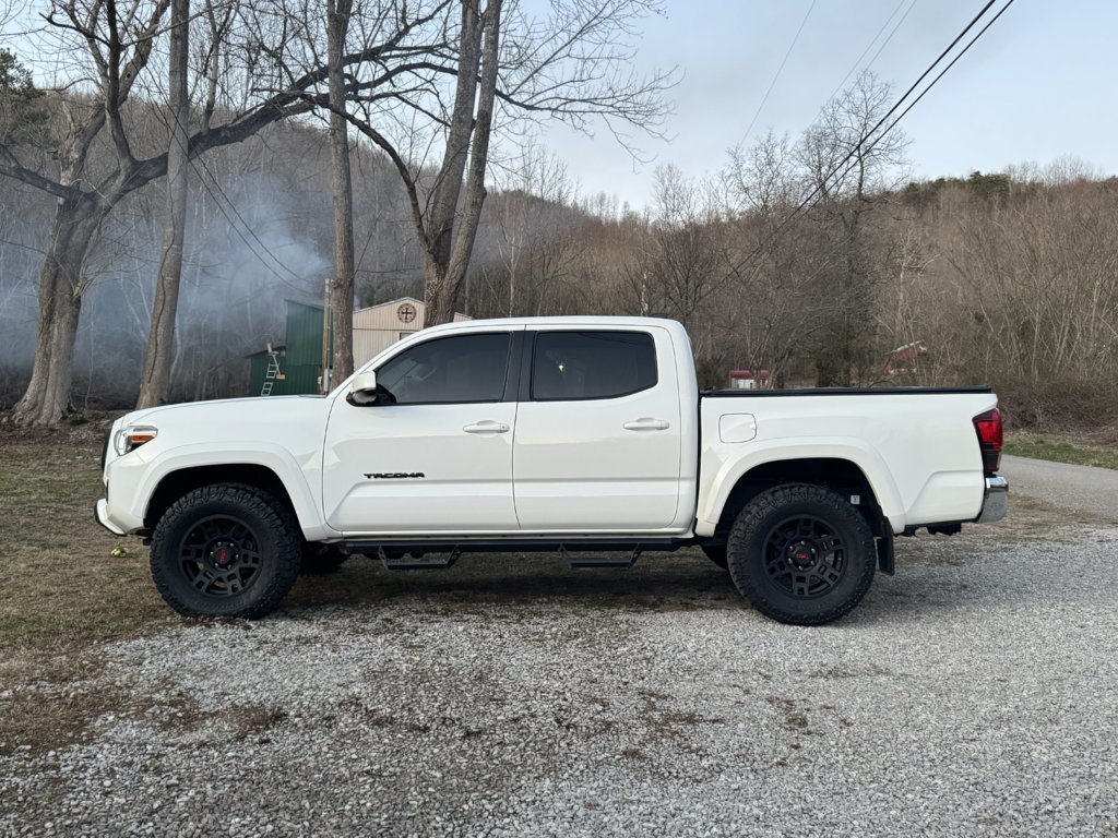

    265/70R17 Cooper Rugged Trek on SEMA wheels

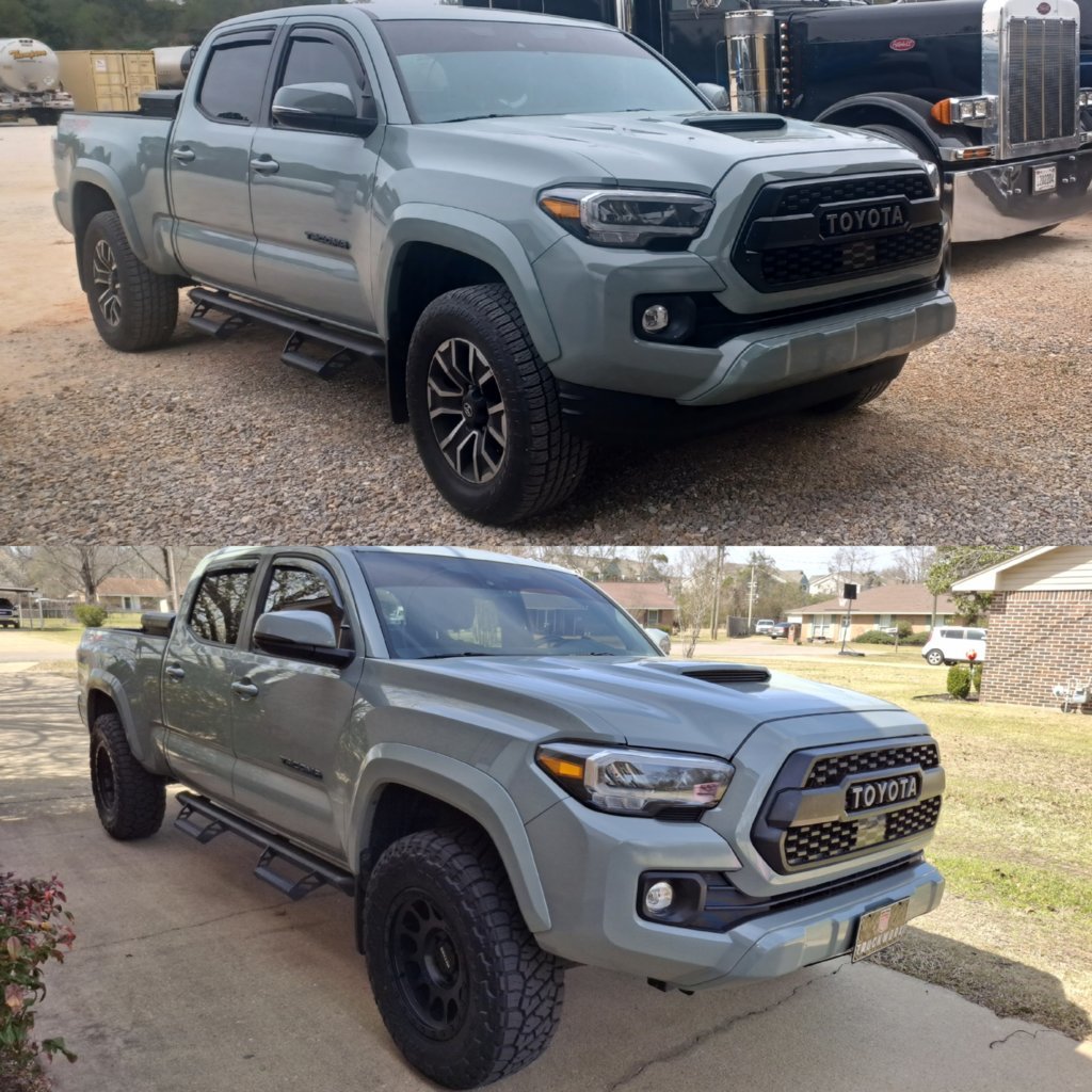

    265/70r17 Mickey Thompson Baja Boss
    17x8.5 -10 Black Rhino Shogun
    Slight rub on stock mudflaps if no adjustments, I am swapping out for Rek Gen flaps

    The Cooper Rugged Trek is almost a true 32” at 3.89”. My stock mud flaps didn’t fit comfortably either. Going to put a set up Rokblokz on tonight hopefully

    Looks good! What brand mudflaps do you have? I just put 265 70 17 on too and my Rek Gens started rubbing. Might need to heat gun it too or find a different brand.

    I put Rokblokz on mine and have no rubbing, but my wheels are also +4 offset

    Oh perfect! I have the exact same wheels as you (TRD wheels) with +4 offset and Falken AT4’s. I’ll probably pick up some Rokblokz then. Thank you!
