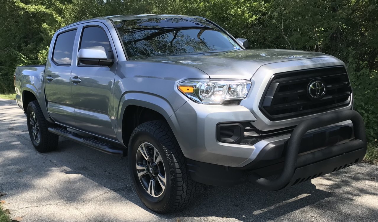

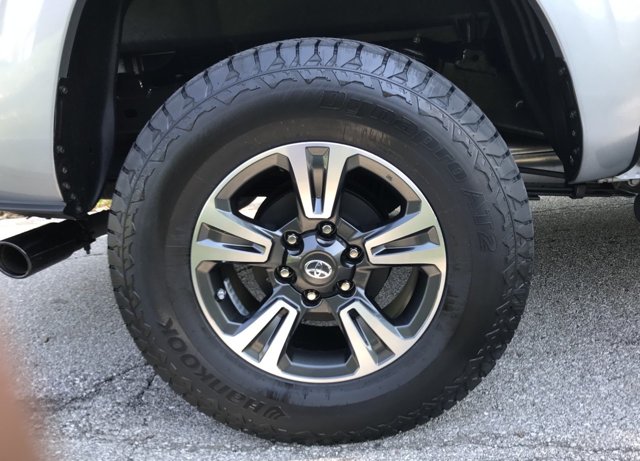

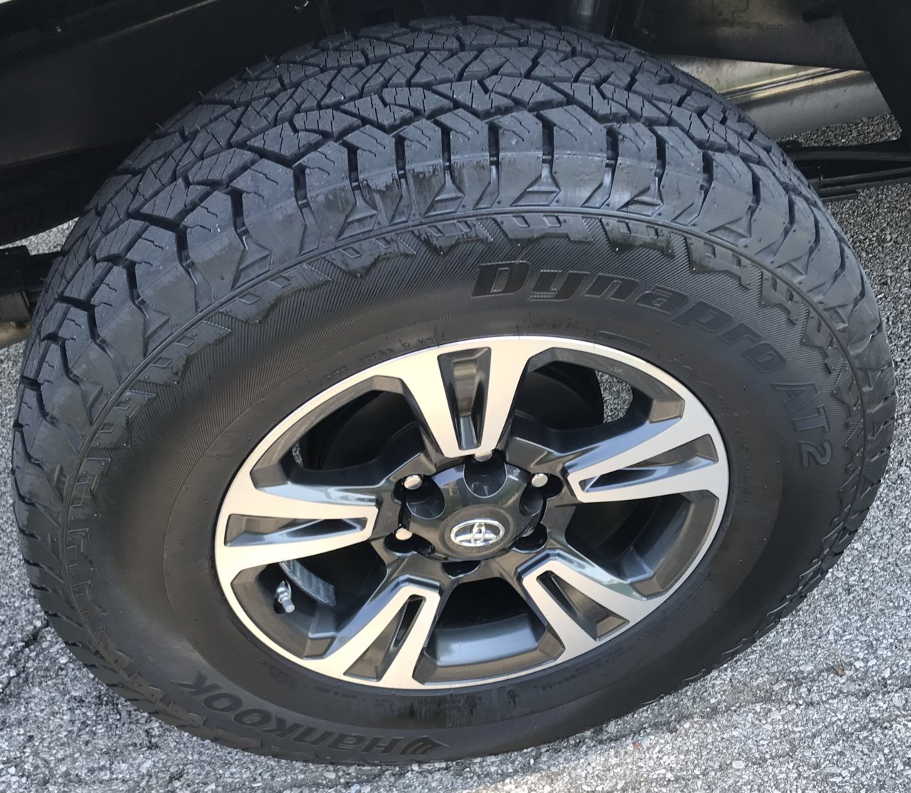

    Follow up: I had the set of Hankook Dynapro AT2 265/70R17 tires put on a few days ago. Discount Tire installed them and said there was no rubbing at all when they tested although the computer warned them there could be:) I've driven her around for about 100 miles through turns, a little off road and bumps here and there. No rubbing! The Dynapros feel great. Lots of grip in the pouring rain we had a few days ago and a soft ride it seems like compared to old tires. Only 1MPH difference when I compared the speedometer to a GPS one. Why Hankooks? First off, the price was less than $130 per tire and the warranty is amazing. I just replaced the Hankook tires that came stock on my wife's Explorer we bought 3 years ago and the tires were wonderful including through the rough Midwest winters we get. I attached a few pics. They look much more aggressive than my old tires. We'll see how they do on the snow, which will be here in a few more months. Taco New Hankook Tires.jpg Taco New Hankook Tires 3.jpg Taco New Hankook Tires 2.jpg

    Your truck looks great.

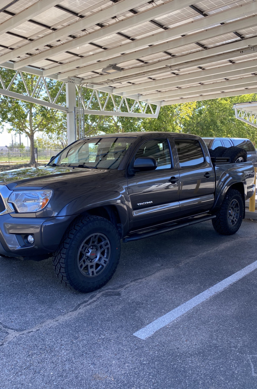

    I just did the same thing today. TRD gun metal 17’s and GY 265/70R17 Duratracs. They removed the front mud flaps because they said they rubbed.
    Were you able to fit the same size spare underneath? I still need to buy a spare.

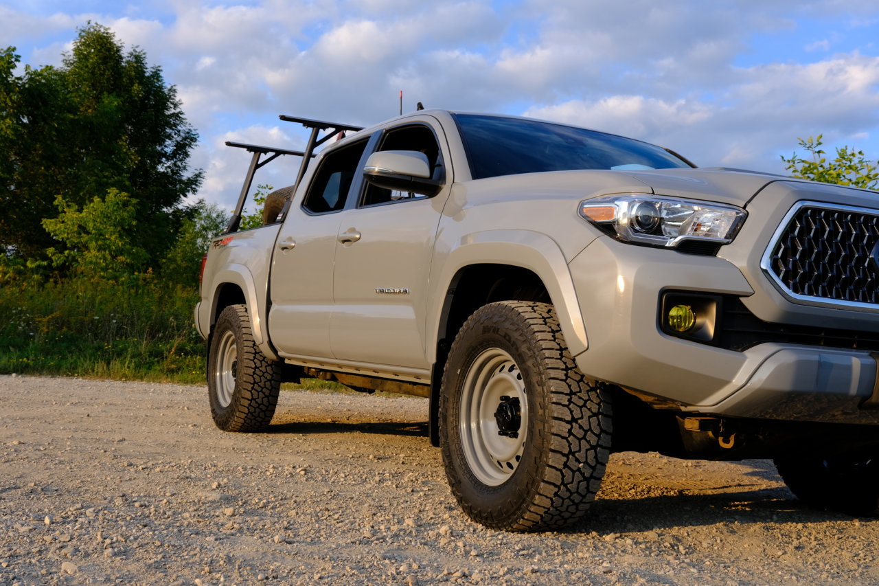

    265/70-17 falken wildpeaks on FJ cruiser steelies. Same 7.5” width as the stock sport rims but a +14 offset instead of the stock +32 offset.
    I get a little rub on the front mudflaps near lock when the suspension compresses.

    Cool wheels!

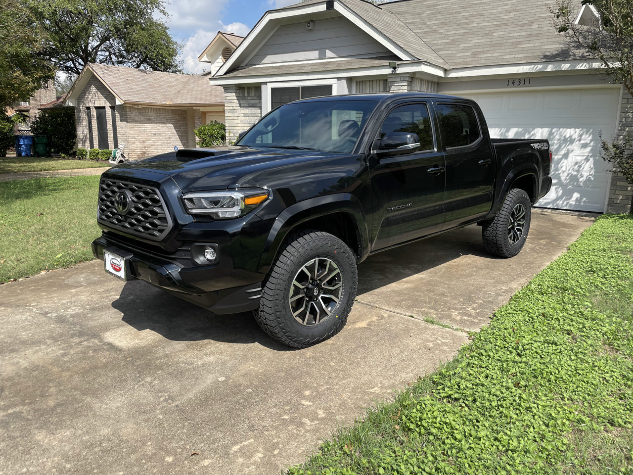

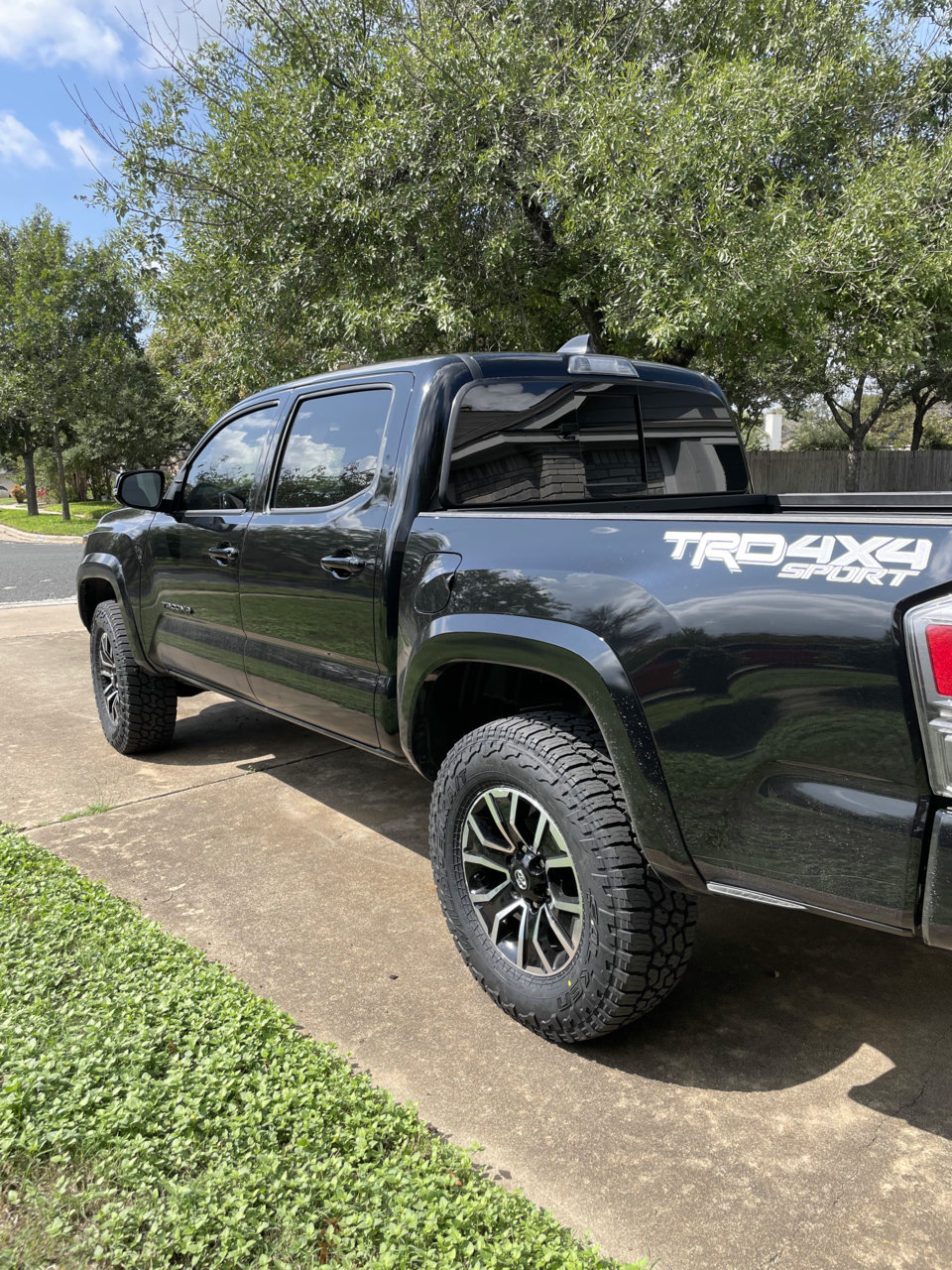

    265/70-17 Falken Wildpeaks

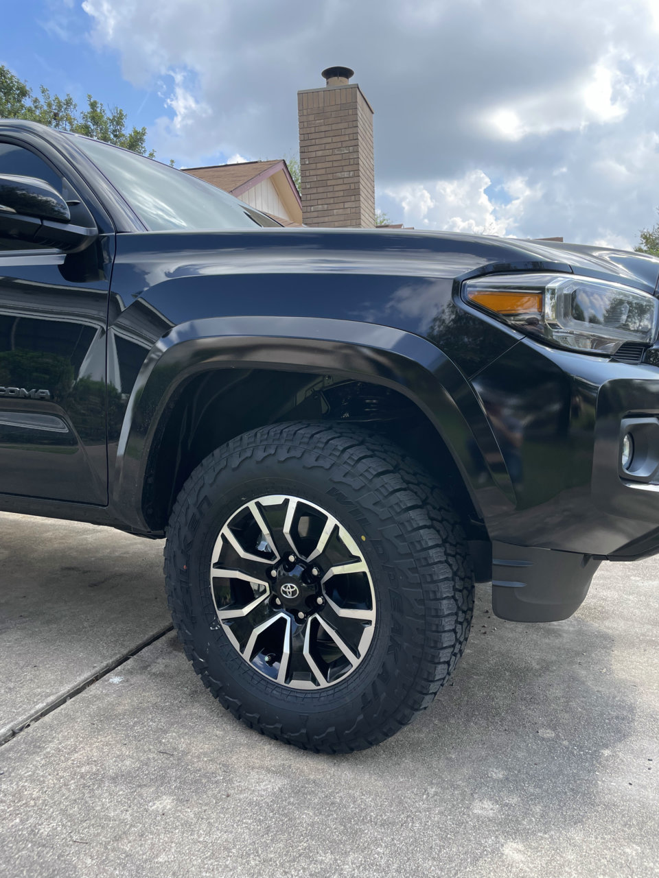

    265/70-17 Falken Wildpeaks on stock rims and suspension. No rubbing at all anywhere but I don't have mudflaps.B18E3136-D2B4-4EAD-9132-18773349E4F9.jpg 9346D19A-23A4-4EB6-8150-9CD20395E96F.jpg 86253C42-C3FE-4464-ADEA-2474DD2344D4.jpg
