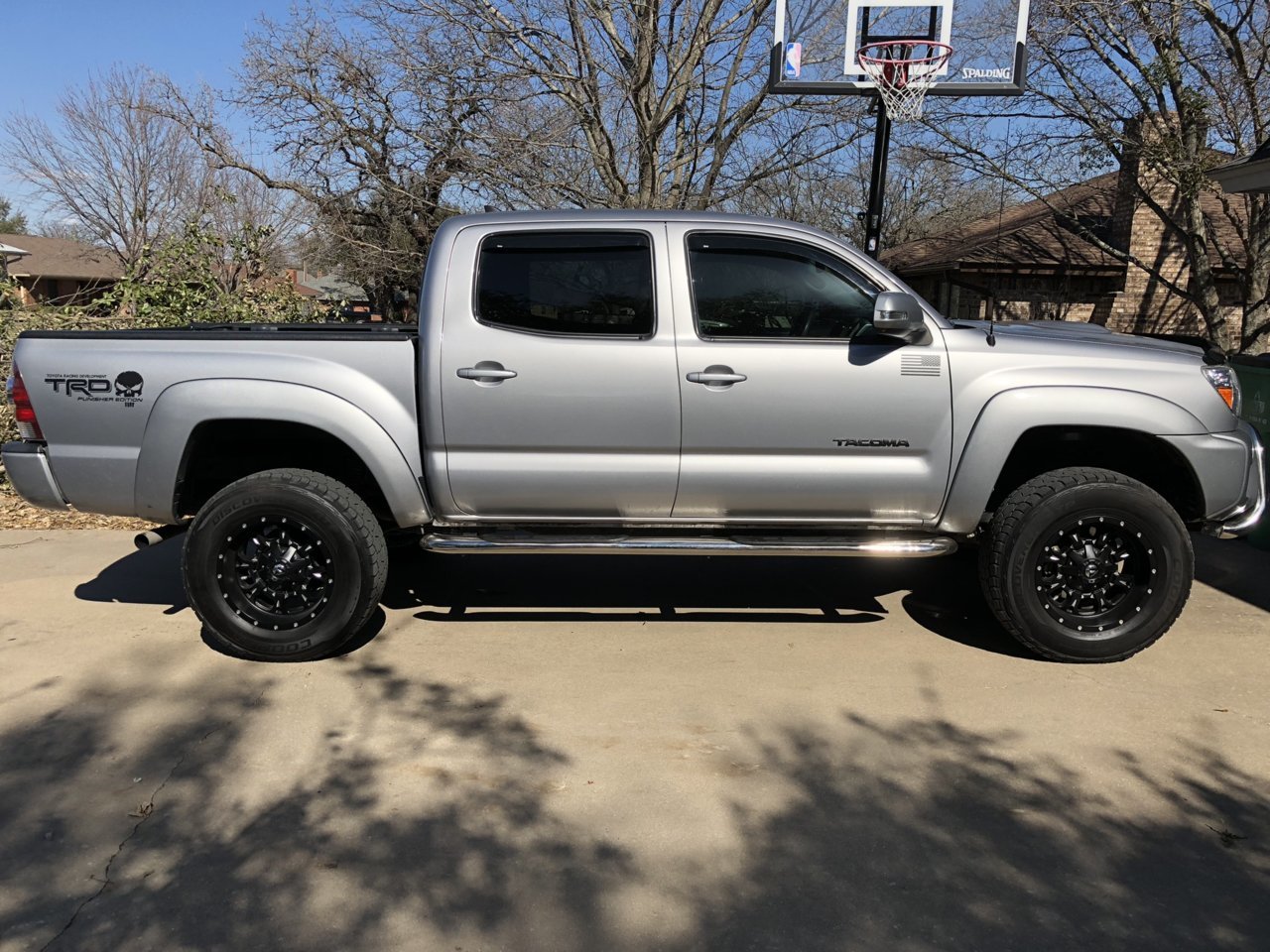

    2015 Silver Tacoma TRD

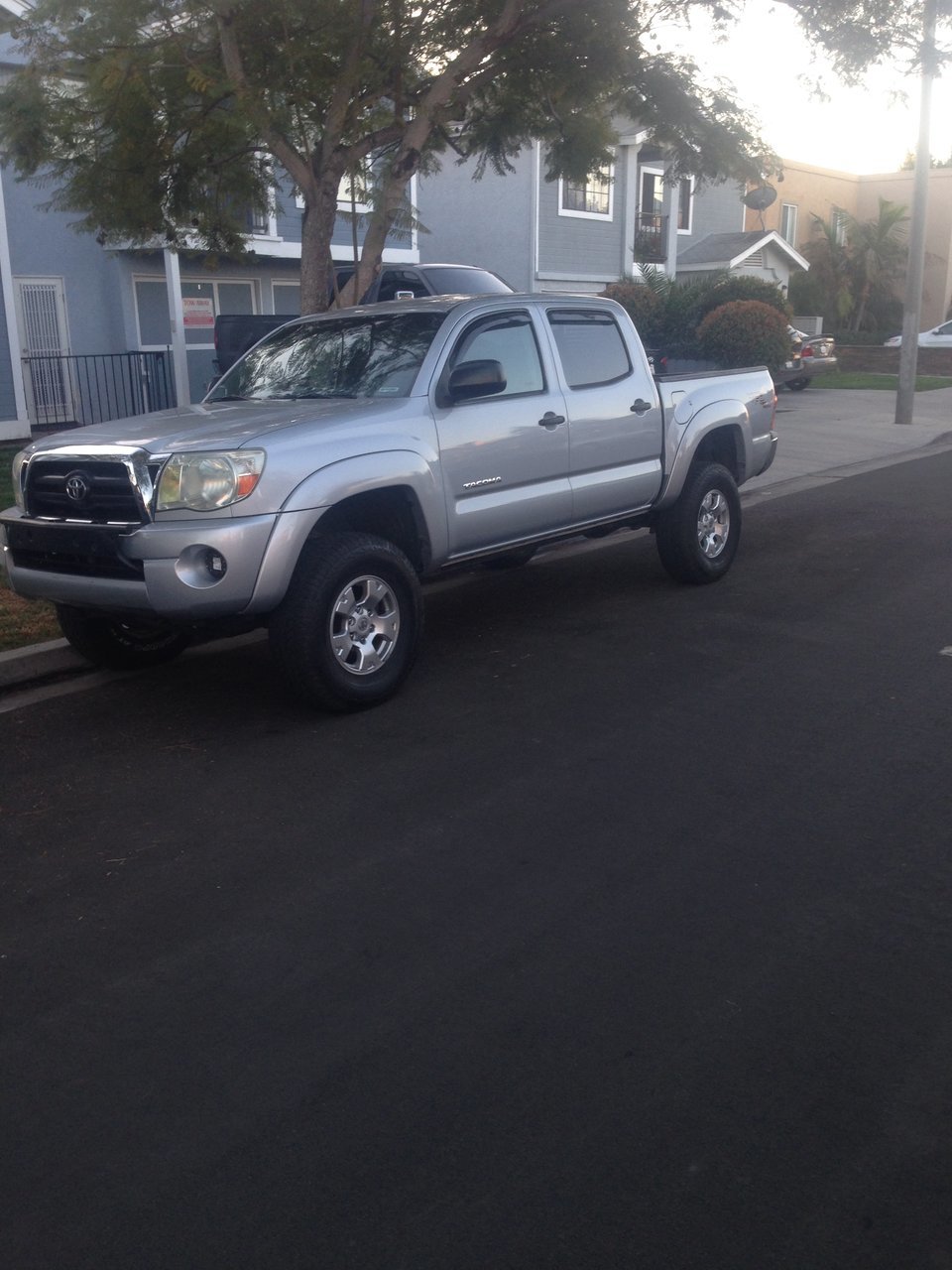

    3 in lift, 17x9 -12 offset Fuel Krank wheels,New decals, Bull Bar,
    65B96BE8-5069-46DF-9AE4-2E686AB96E55.jpg here is mine with 265/70/17

    I'm not expecting a response at this point lol... but where did you get that front "Bumper" from? Looks good on the taco

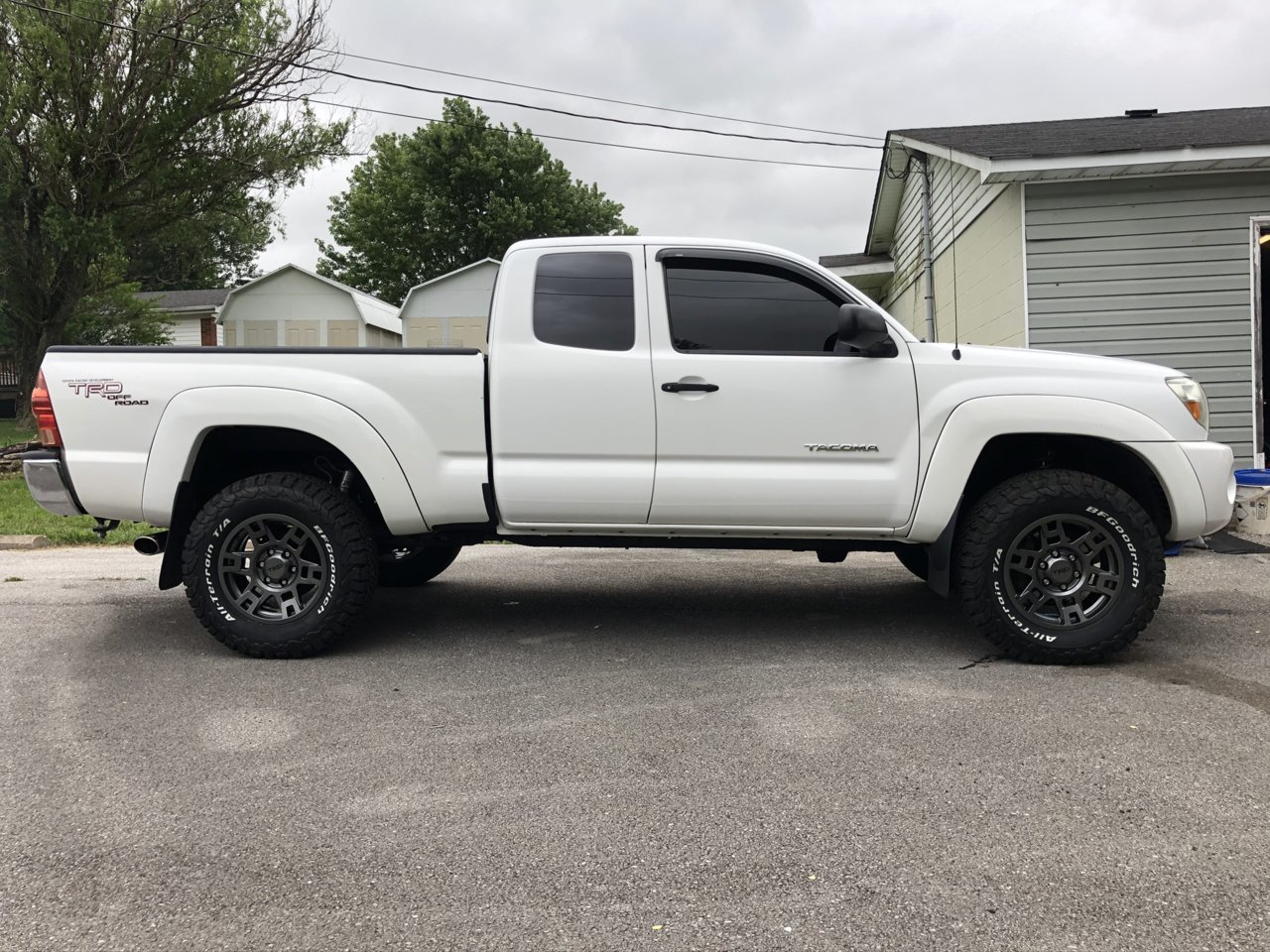

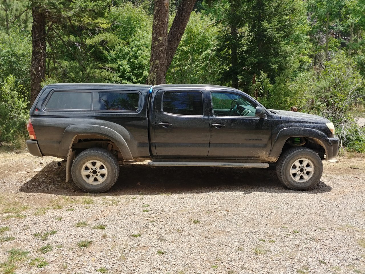

    2006 SUPER WHITE ACLB MT, TRD OR, TP, SR5

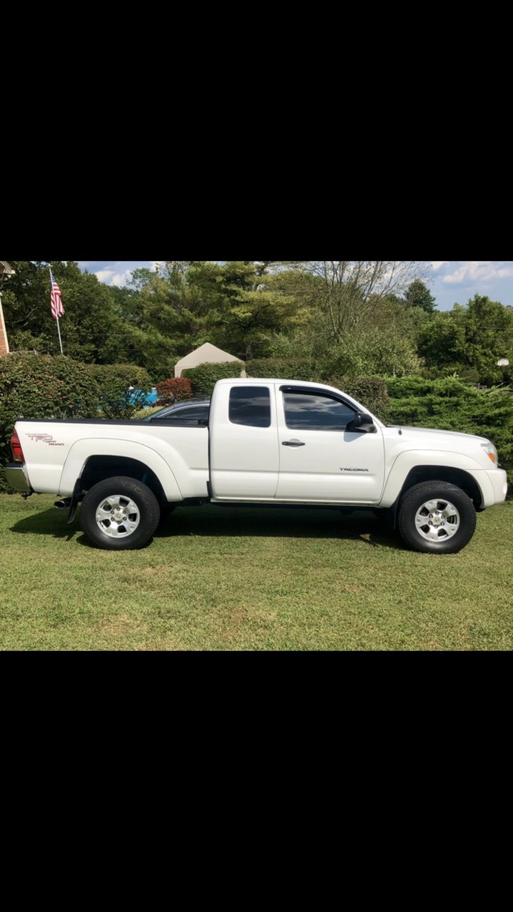

    Total stereo replacement, TRD Exhaust, Fox 2.0 coilovers, 2.0 reservoirs with an AAL in rear for about 2.5 inch lift, gunmetal TRD 4Runner wheels wrapped in K02
    First pic with stock wheels are 265/75/16. Leveling spacers with AAL in rear. Second pic with 4Runner wheels are 265/70/17 with fox 2.0 coil overs for 2 inch lift in front and 2.5” in rear. Tires are almost exactly the same height.

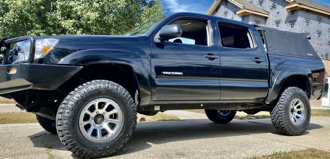

    Here’s a pic of mine with 5100s/OME 885/Icon AAL with 265/75/16 (downsizing from 285s) on stock wheels with spidertrax. I’m 90% street. I think this is the perfect set up for my needs. I debated going with 285s again, but I don’t want to rub. I couldn’t be happier with this set up.

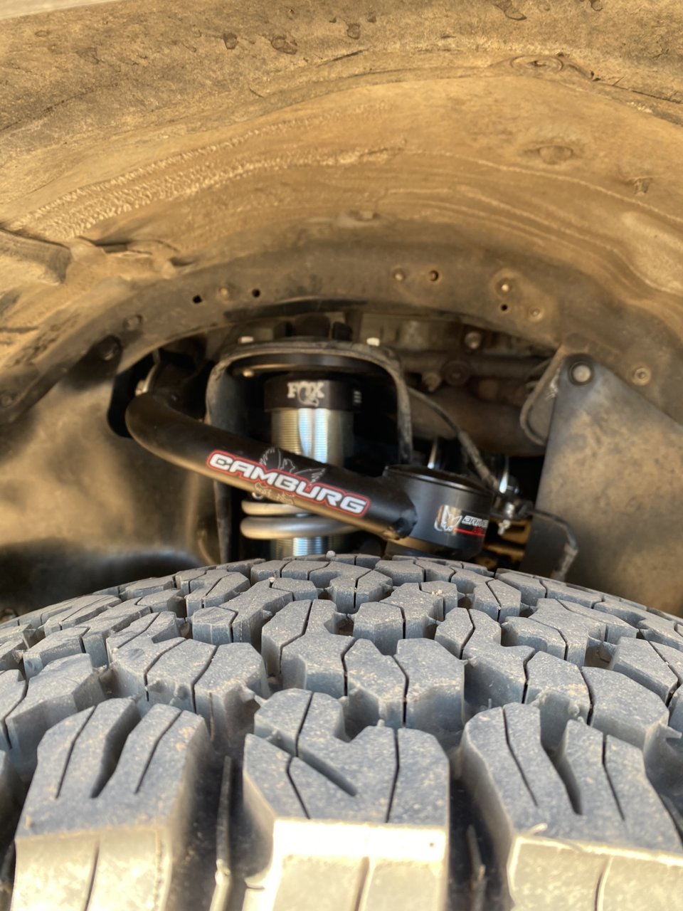

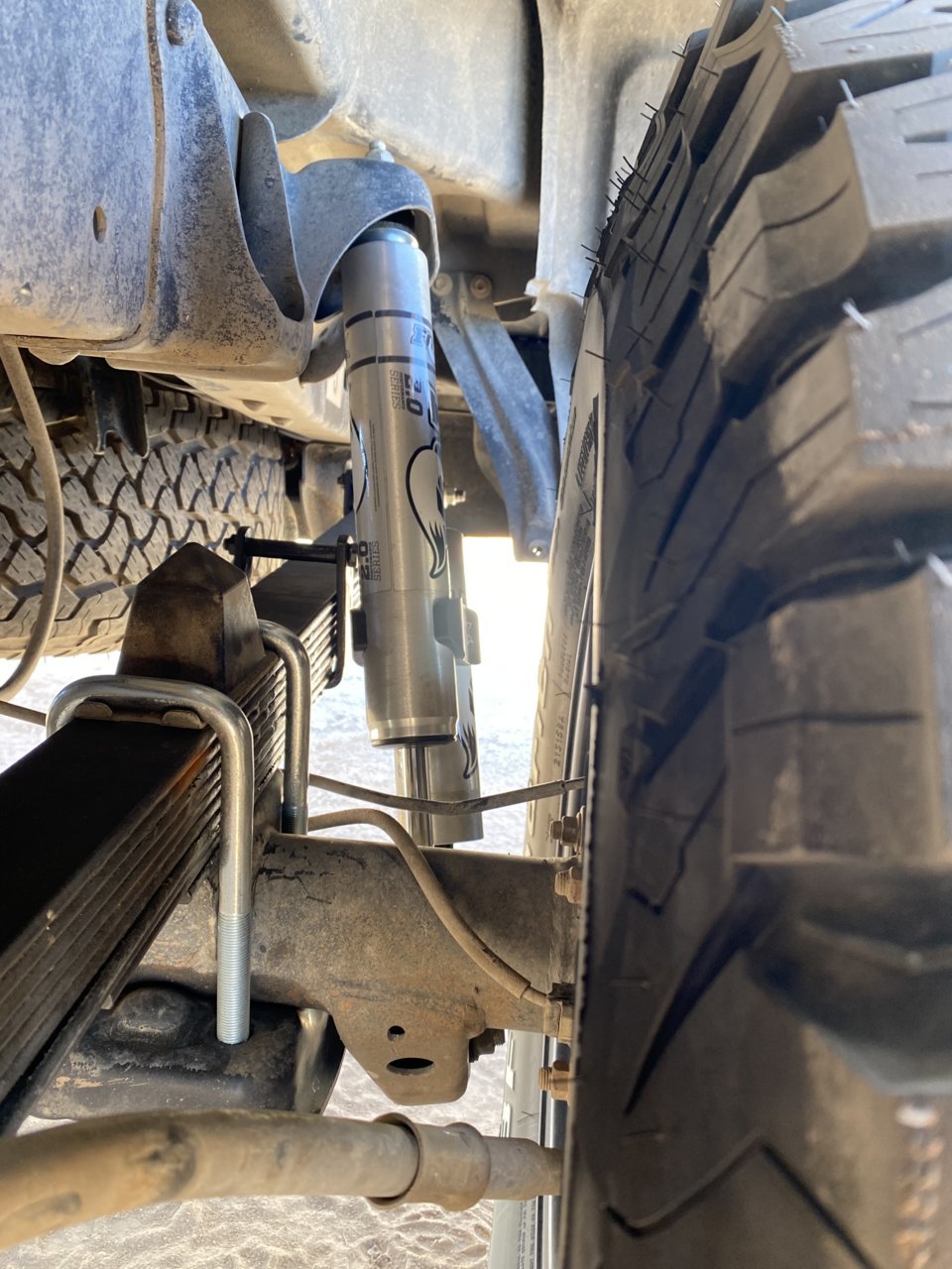

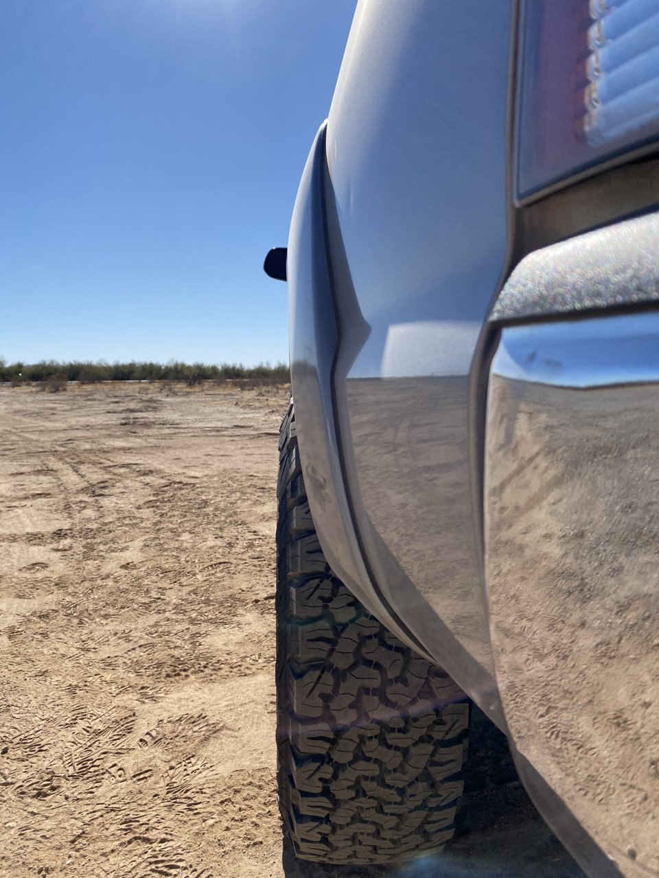

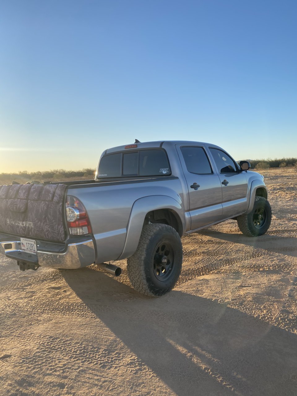

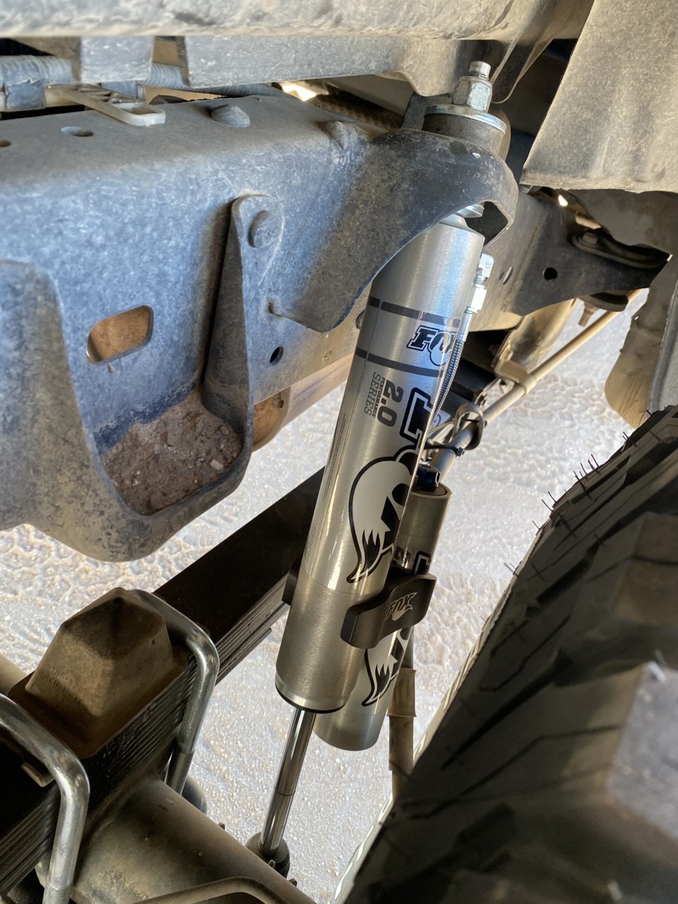

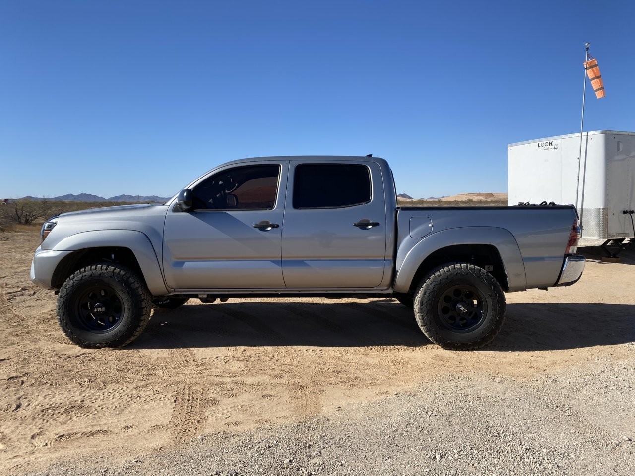

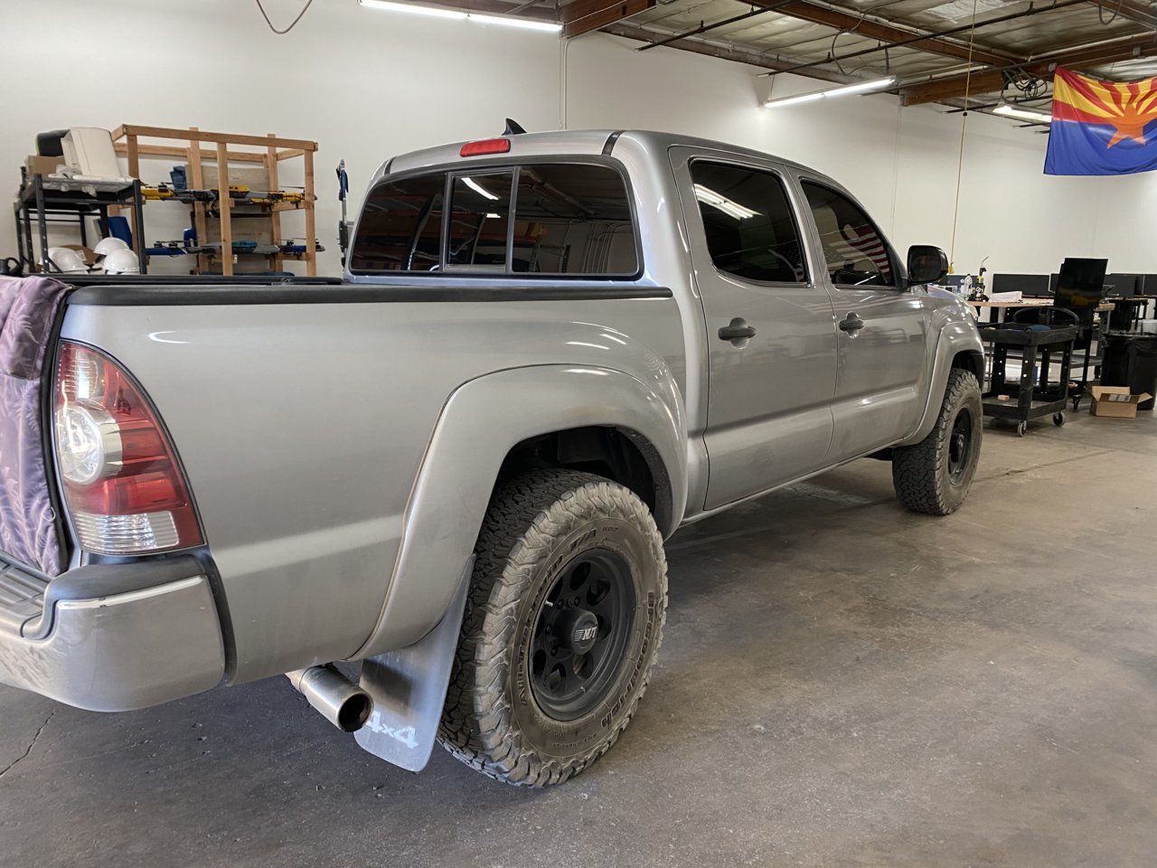

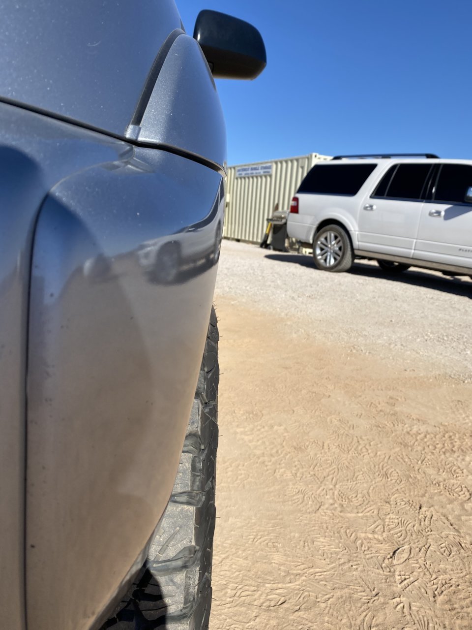

  16. Dec 4, 2020 at 12:04 PM
    #36
    nomadtaco
    nomadtaco Well-Known Member
    Mar 13, 2016
    #181081
    77
    Jeremy
    Tempe AZ
    ‘14 DCSB 4x4
    Camburg UCAs, Fox CO, fox rear resi, deaver 10 leaf

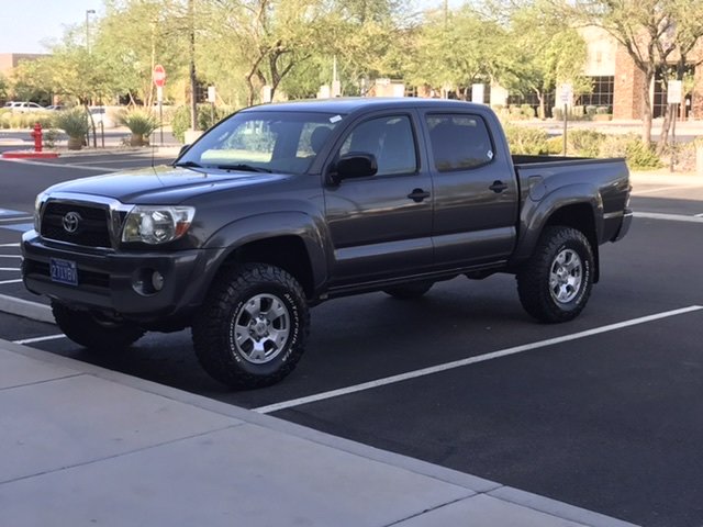

    My suspension was completely roached. Leafs were flat and shocks were beyond blown.
    I researched this topic for about 3 months before pulling the trigger on parts.
    2-3” lift with 265/75R16.
    Mickey Thompson classic iii with KO2 LT.
    FOX 2.5 CO
    Camburg ball joint UCAs
    FOX 2.0 rear LSC adjustable
    Deaver j66 10 leaf
    Plug and play. Install was a breeze. Penetrating oil soak and a cordless impact.
    I’ve put a total of 4 turns on the CO since install for settling. Currently showing 2.5” of thread. 2 turns gave me about 1.5” each time. I put 6 50lb sand bags in the bed to help settle the leafs.
    Before
    19.5 DF
    20.5 PF
    21.5 Rear
    After
    23 front
    22.5 rear
    Everything clears. Nothing rubs.
    ohcaltexscar and Minny Taco like this.

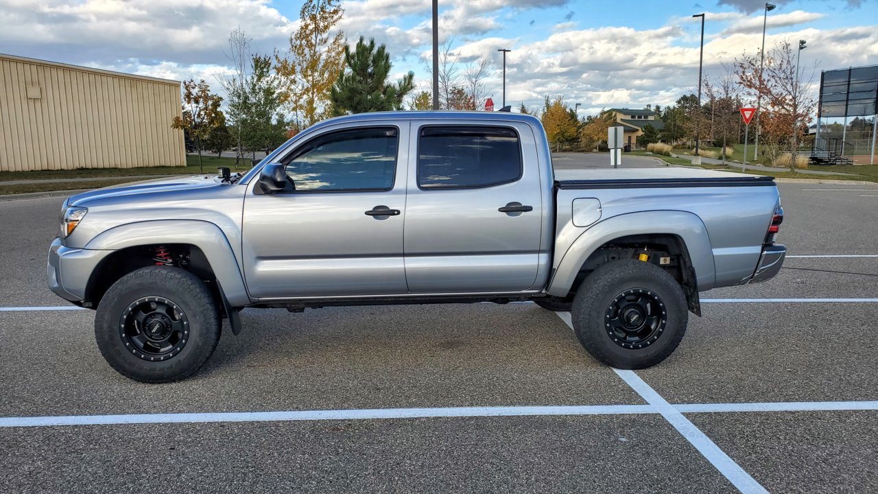

    - Dobinsons shocks and leaf pack - Level 8 MK6 wheels - 265/70/17 Goodyear Wrangler Duratracs load C - SPC UCA - Moog LCA - TRD Pro headlights - Bullet Proof Fab skid plate w/ Line-X - 3M Matte Black roof vinyl - Astrostart remote - Debadged - Black shifter bezel - Front window tint 50% - Color matched grill surround - MESO LED red/white map lights - Osram Super Bright H4 bulbs - Headlight Services upgraded wiring harness - Auxito LED reverse lights - Zulu Nylon Gear MOLLE visor cover - Truxedo Lo Pro QT tonneau - Weathertech floor mats - Weathertech vent visors - Redline Tuning Elite hood struts - OEM bed mat - AJT Design custom shift knob - AJT Design custom climate knobs - Center console organizer - Salex glove box organizer - 1" driver seat spacers - AntennaX 14" antenna - AVS door sill protectors - Trimmed OEM mud flaps - Candyapple red tow hook - Painted pinch weld and radiator frame - Custom radio knobs from Hondo Garage - Xtunes black tail lights - Black LED third brake light - Ruff Tuff Kryptek Typhon seat covers - ACEkraut license plate relocation bracket - Cali Raised Side Shooter ditch lights w/ lo-pro mounts - Subaru tweeters + Rockford Fosgate speakers - Thinkware F800 Pro dash cam - Stickers n shit
