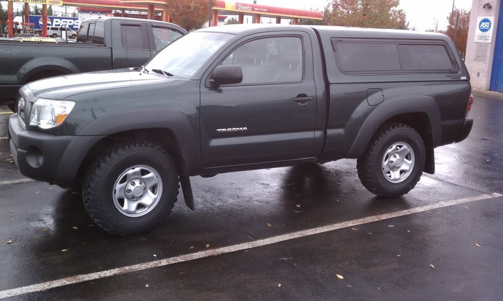

    Ok people,
    I have a 2010 4WD regular cab (he pauses as they applaud his short little wheelbase). I use my truck to commute 75 miles per day (round trip) but also hunt some pretty gnarly places 30 days or so a year. Recently natural gas exploration has made the roads/paths at the cabin more shitty and I'd like a bit more tire for next hunting season. I also want to swith to a black wheel.
    As of now, I don't plan on lifting but MAY level in the future. If what I've read here is correct I can run a 265/75-16 on my stock steelies. A shop down the road can powder coat my stock wheels for $250. Now that you have all of the background info, here are the questions. I've searched various threads but get a lot of conflicting info.
    1. Is it true that 265/75-16's won't rub on stock steelies/suspension?
    2. I'm not opposed to buying aftermarket steel rims. What back spacing do I need on a 16x8 steel rim to run this tire size? Anyone running that setup?
    3. I'm considering buying the new rims and selling the stockers w/ tires to offset the cost. What is a realistic price to ask for rims/tires with 20k on them minus the TPMS sensors? I'd like to price for a quick sale and give somebody a good deal.
    4. WHAT WOULD YOU DO?

    I'd put the 265's on there and call it good!

    Id paint the steelies, alot of people are happy with them, Im getting ready to do so my self, I have bought all the stuff and I think it was like $22. I hunt and get in knarly stuff as well so if you chip one you can respray as oppose to having to get repowdercoated which you have already said will cost 250 or 60 to 70 a wheel. I have Nitto terra grapplers which I like, but I am really liking the Hancock ats people are talkig about with a 50000 mile warranty for an offroad tire. And yes the tire you are looking at should be just fine in terms of size. Good luck and these of course are just my opinions, but the bigger tires will look great on your rig

    I installed 265/75/16s on my 2007 access cab with the stock alloy 16" rims and there is no rubbing. they fit great.

    I have a reg. cab and went with 265/70-16 and kind of wish I had gone with 265/75s

    I neglected this project all summer and now that hunting season is here I was kinda screwed. Roads are worse this year. This morning I met a fellow forum member and bought his stock steel wheels. Stopped at Pep Boys on the way home and loaded up some Definity Dakota MT's and couldn't be happier. No rubbing and road manners aren't too bad.
