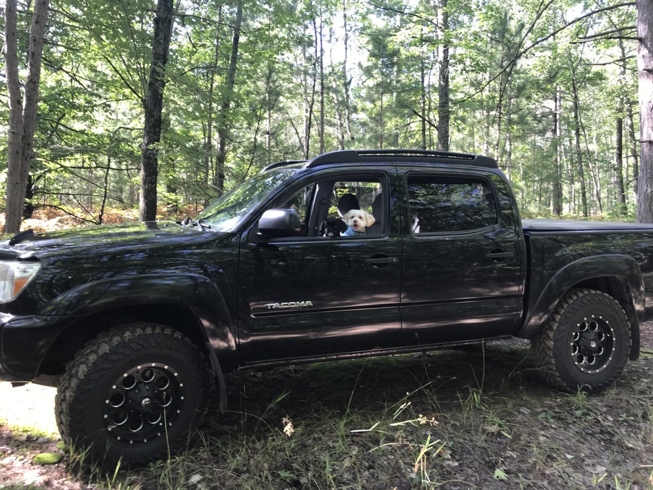

    I’m planning on this size on the kumho at51. I’m not doing a lift or anything just stick. Will post pics of course after install

    Question on the bull bar in the second picture, what brand and where did you get it?
    TIA.

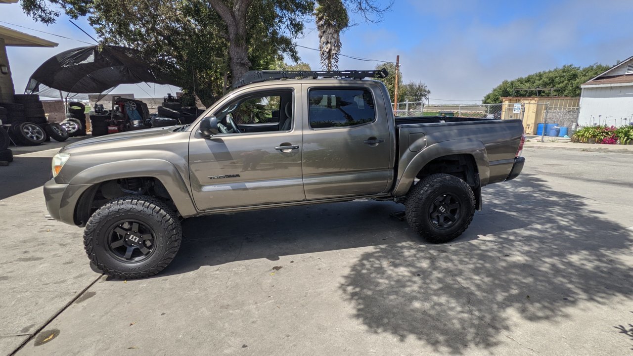

  18. Aug 29, 2021 at 1:24 PM
    #38
    Plain Jane Taco
    Plain Jane Taco Well-Known Member
    Apr 19, 2009
    #16179
    40,279
    USA
    I run 265/75/16 Firestone WinterForce tires as my winter setup on some stock steelies with zero rubbing.
  19. Aug 29, 2021 at 2:40 PM
    #39
    KOG89
    KOG89 Well-Known Member
    Mar 19, 2017
    #213725
    162
    Castroville C.A
    09 DCSB 4x4 6spd manual
    Ome 2.5 lift front and rear, 886 coils on 9k nitrochargers with hd rear leaf springs. Ko2s on level 8 mk6 wheels. Prinsu roof rack , Bakflip tonneau cover
    265 75 16 ko2s, with a 3" lift
