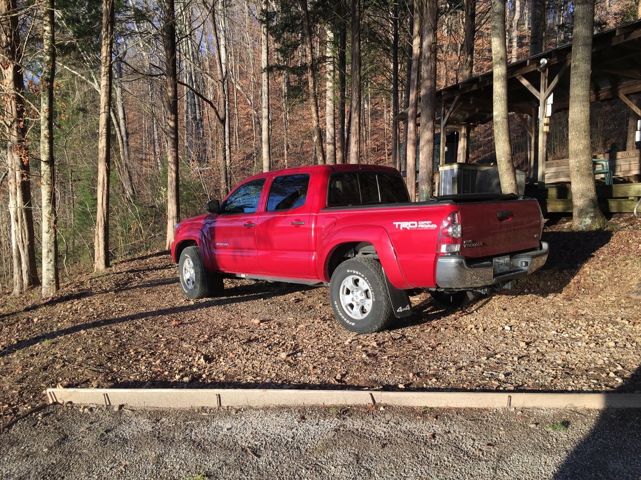

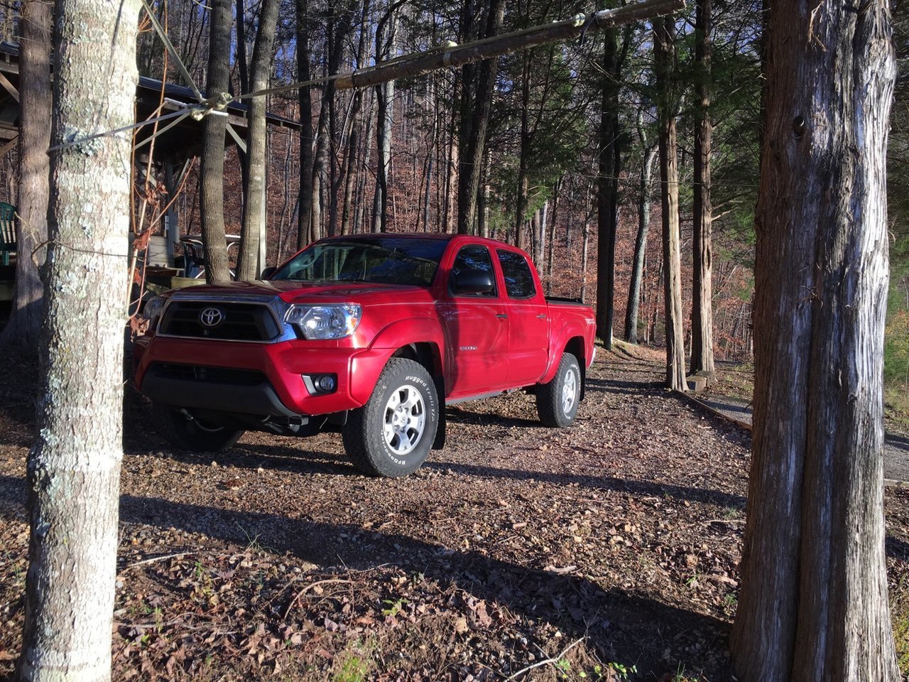

    Here's a few

  12. Dec 8, 2015 at 1:13 AM
    NMTrailRider
    NMTrailRider [OP] Well-Known Member
    Sep 28, 2009
    #23469
    5,291
    New Mexico
    Thanks. I've been wanting to see pics to help me decide on tire size.

    No problem. I threw another pick in there for you.
    NMTrailRider[OP] likes this.

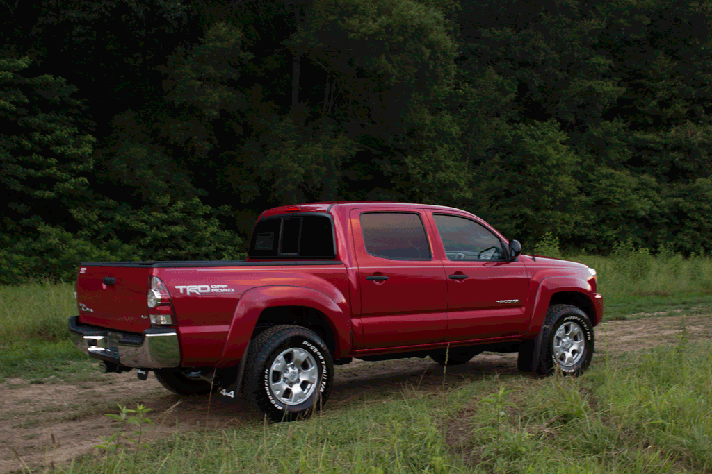

    @harpolith I've used both the 245/75r16's and 265/70r16's on Tacomas. The research and predicament you're in are exactly the place I was in before I swapped my PreRunner (245/75's) for the TRD (265/70's).
    IMO, 265/70 is the sweet spot for our trucks when running stock suspension. You get the look/stance of a wider tire, without any real negative effect. Moving up to a 265/75 has the potential to throw off odometer readings and hurt gas mileage depending on the tire you choose.
    After running both, the 265's hugged the road better and offered better stability in corners. I can't compare exact apples to apples because the 245's were Dunlops and the 265's are BFG's, but I do feel more confident on the road with the 265's.
    Also just an FYI, all TRD Off Road's come stock with 265/70r16 BFG tires, so any visual comparisons you're doing that should help you visualize.
