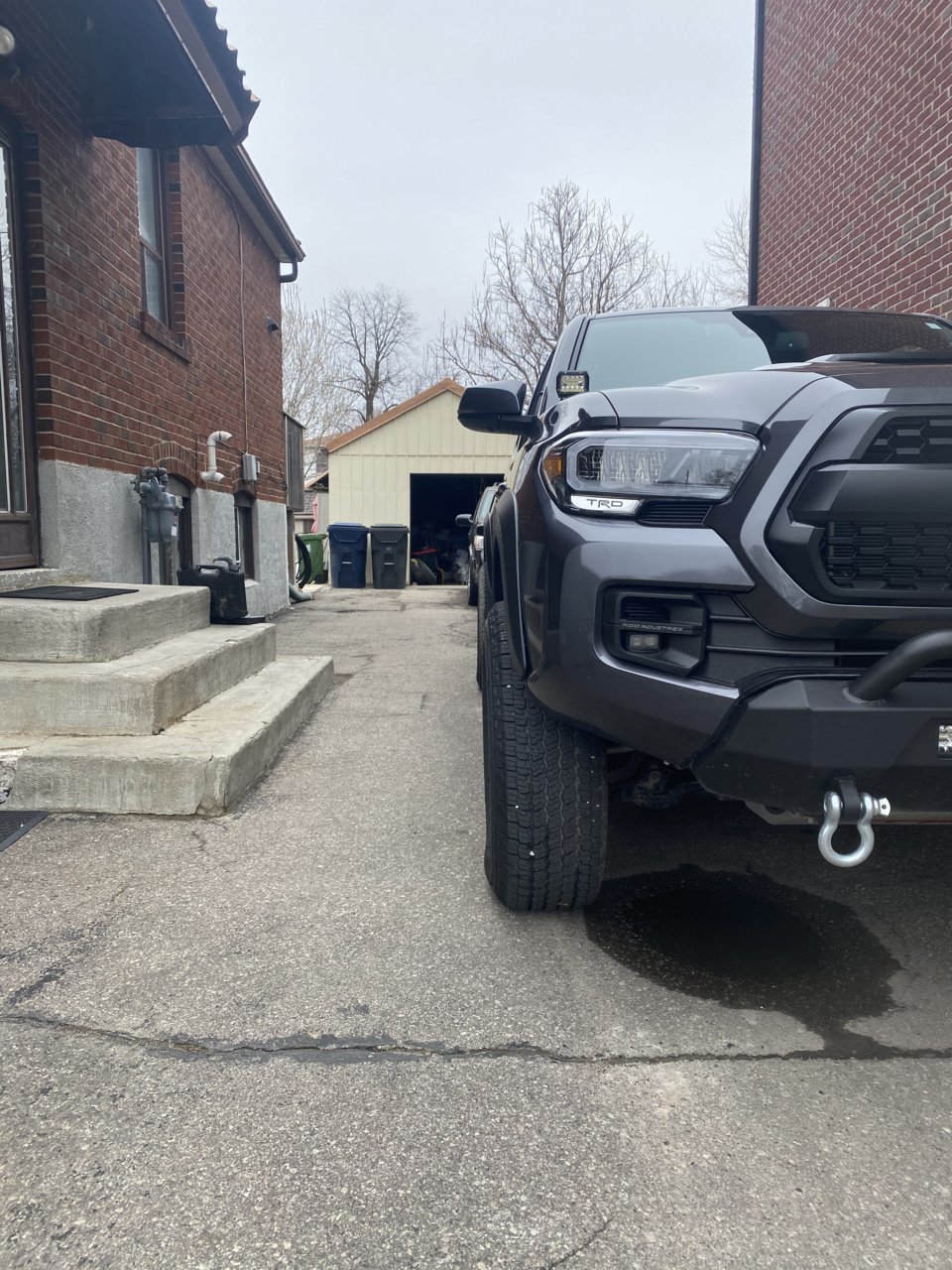

  10. May 7, 2021 at 4:59 PM
    #30
    Alexpro21
    Alexpro21 New Member
    Apr 20, 2021
    #363319
    2
    Alex
    2021 trd pro 6 speed
    265/70/r16 with 1.25 inch spacers, little rubbing on the drivers side at 3/4 left turn while going uphill. Mud flaps deleted*
