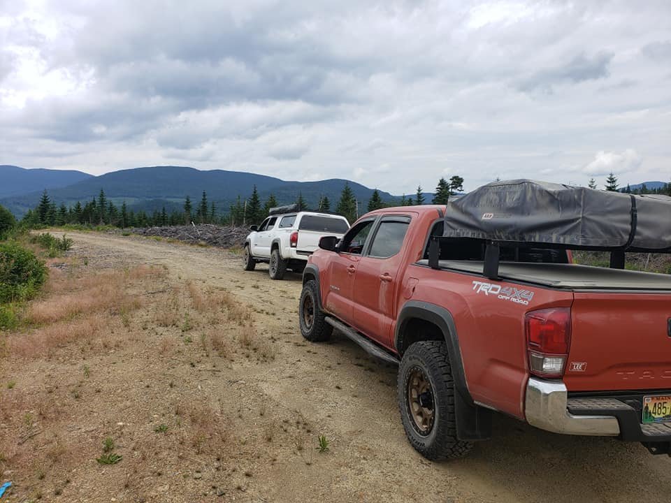

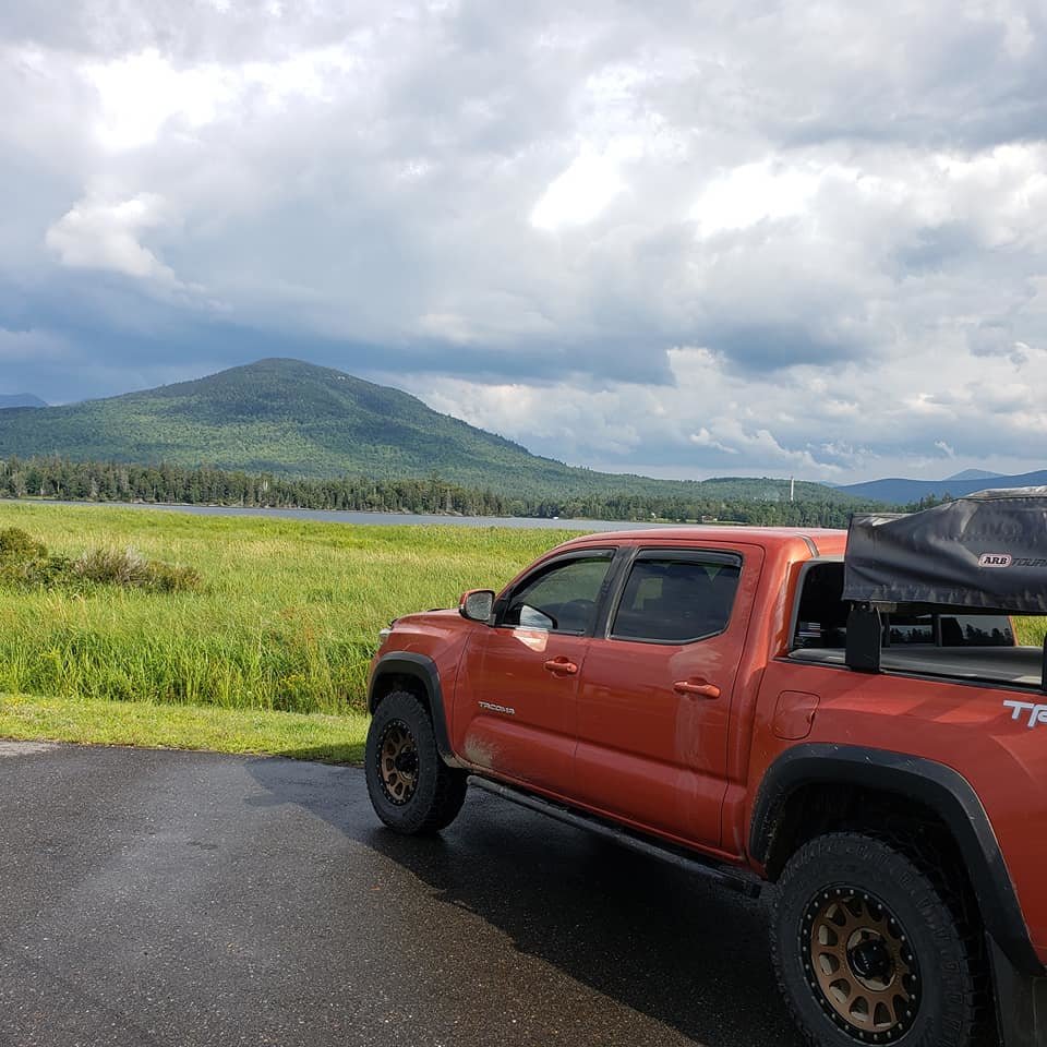

    thanks, she looks a little better in this pic...
    same wheeling trip... Rangeley & Eustis, Maine.

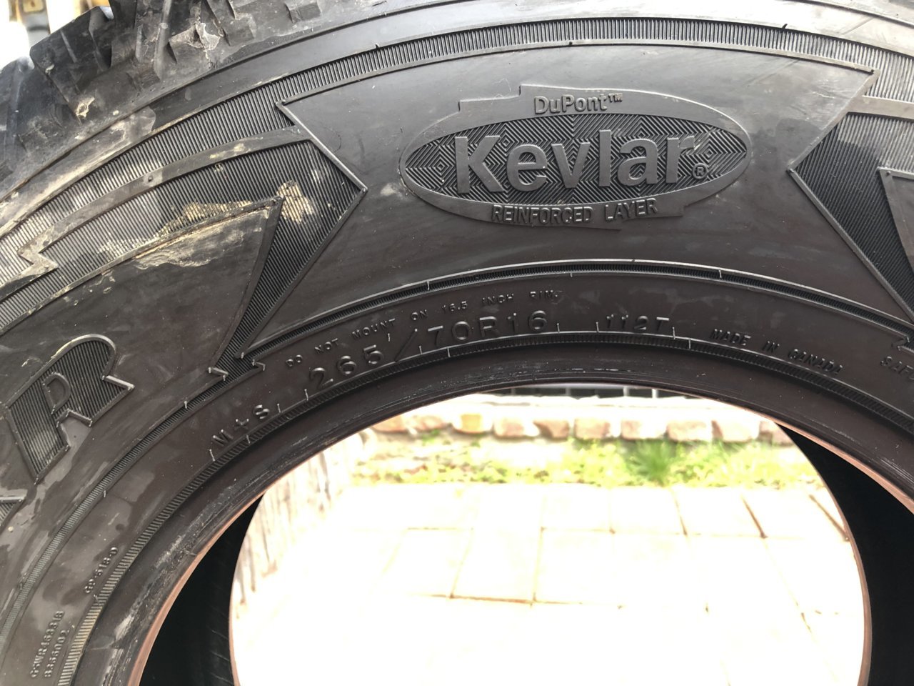

    Did you buy yours new? ......or maybe from a dealer who changed the real oem tires?
    Mine came with 265/70/16 wrangler kevlars, I’ll post a pic when I get home.
    I sold them and put on 255/85/16, that will give you just over an inch of ground clearance.
    So here's a pic of my original OR goodyear AT kevlars, 265/70/16.
    Going from that to a 265/75/16 is an inch taller tire diameter.....halve that difference for the ground clearance gained. It's 1" added diameter not radius.
    The 255/85 will give you a full inch plus of added ground clearance.
