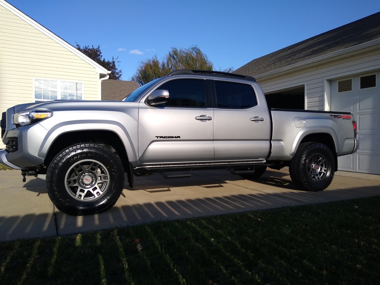

    IMG_20221027_162423449.jpg IMG_20221027_162400240.jpg I have the 5100s on the 4th setting and a 1 inch block in the rear.I ran 265/70/17 SL TOYO OC AT2s on the TRD 4Runner SEMA wheels and have about 30k miles on the truck now. I finally got tired of waiting and trying to find a light 275/70 or hoping for a 265/75/17 or a 265/80 and I believe GoodYear makes a 265/75/17 but they are heavy as crap and expensive. So I just had a new set in SL rated light 46 lbs. Toyo OC AT3s in 285/70/17 installed and they fit perfect. I tried a dozen or so times backing and turning sharp and gor a slight rub on the front guard on the pass. side now solved. All I did was loosen the bottom hole and slid the guard back some. I have about 3/4 inch at the closest points between the tire and the guard. I have the new KDMAX Pro tune and I can barley tell any loss of power. My tuner is calibrating the speedometer hopefully today and then I'm done. I just got tired of searching and yea I'm a fan of Toyo and Nitto tires. In fact I even tried the Terra Grappler G2s and drove home and just was not liking them so I returned them to the tire store and had the Toyos installed.

    That's with a LIFT, I take it?
    Any other changes that had to be made to prevent rubbing?
    I'm curious...the additional weight of each tire does make a difference in my decision.

    do u have a lift on this truck??
