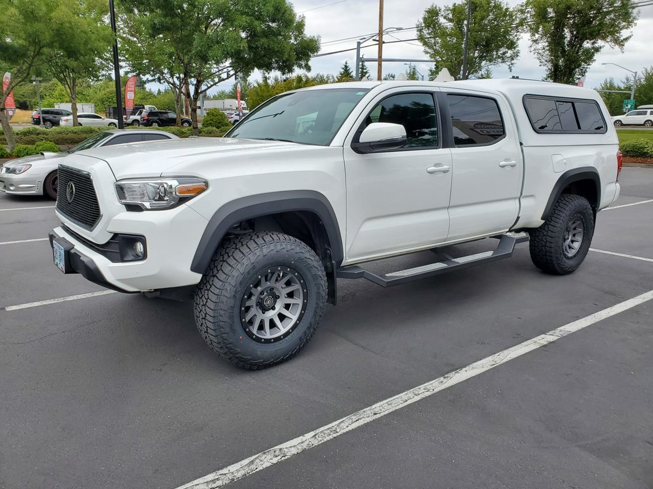

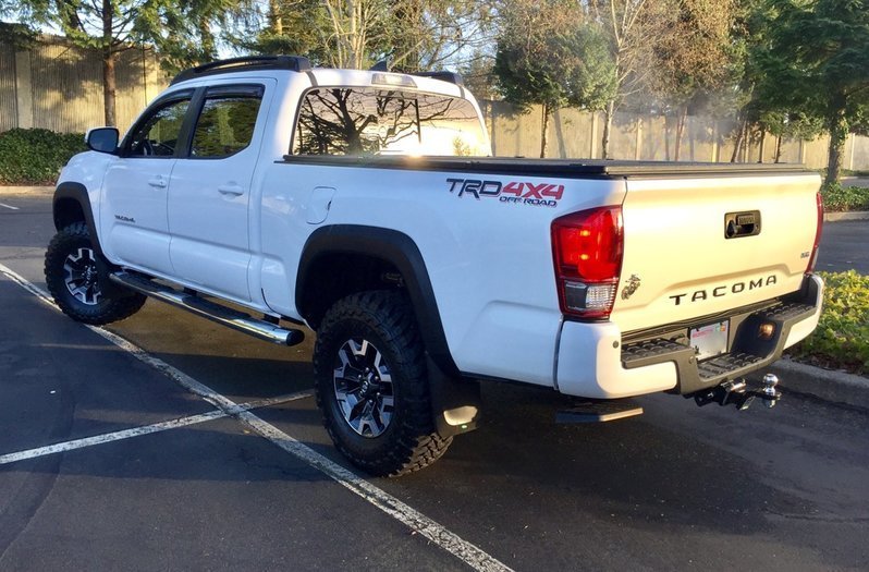

    Leveled with Icon Stage-3 suspension Toyo Open Country MT's, (LT265/75/R16) TRD Performance Exhaust TRD performance Air Intake
    I went with 265/75/16 Toyo Open Country MT's, on complete Icon Stage-3 suspension which gave me about 2 extra inches and leveled. Staying with the 265/75/16's allowed me to get the look I wanted, plus fifth tire spare in the same size and it fit perfectly under the bed...no issues at all. No cutting, a spare that fit under the bed, plus the looks I wanted was a win for me...

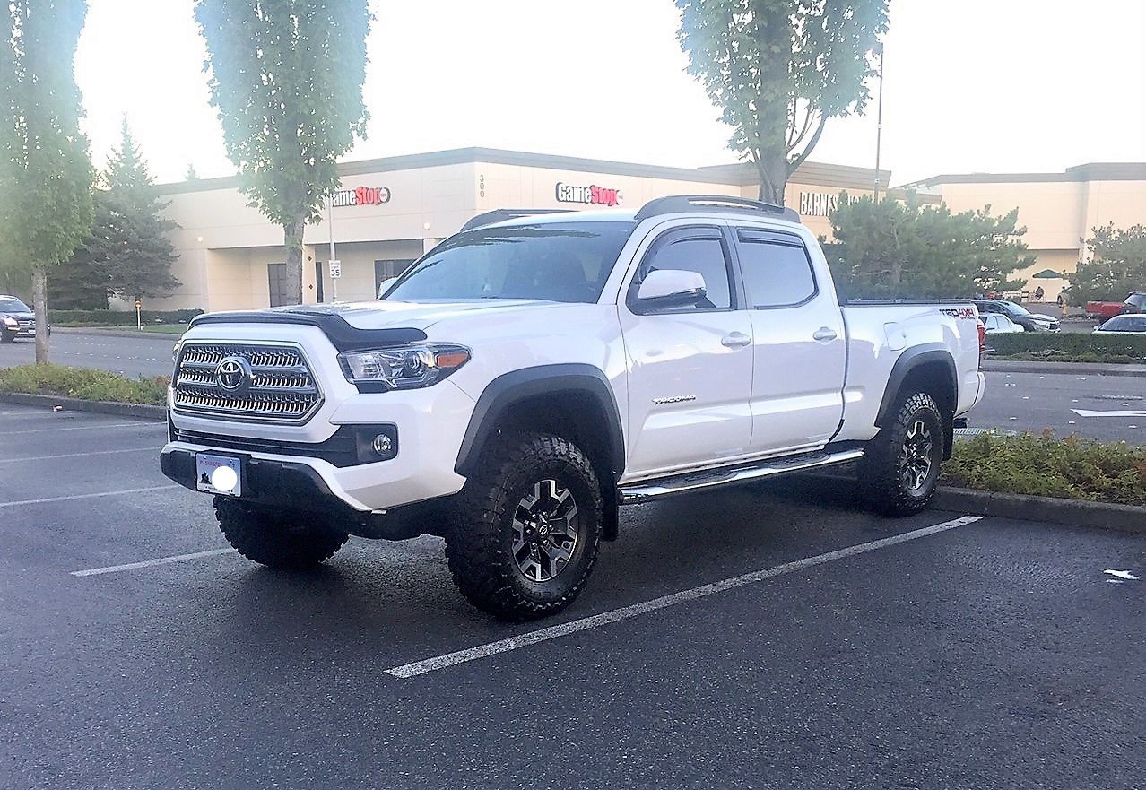

    2018 White Tacoma TRD Offroad
    I did the 285/70/17's with the Eibach 2.5 inch lift. the only cutting I had to do was the front bumper tab on each side, just moved the fender liner mount forward into another existing hole and it worked great.
    I do not seriously offroad the truck, mostly pavement with an occasional gravel fire road. I did remove the mud flaps, they rubbed slightly.

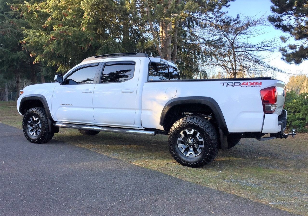

    2019 Cement Tacoma TRD

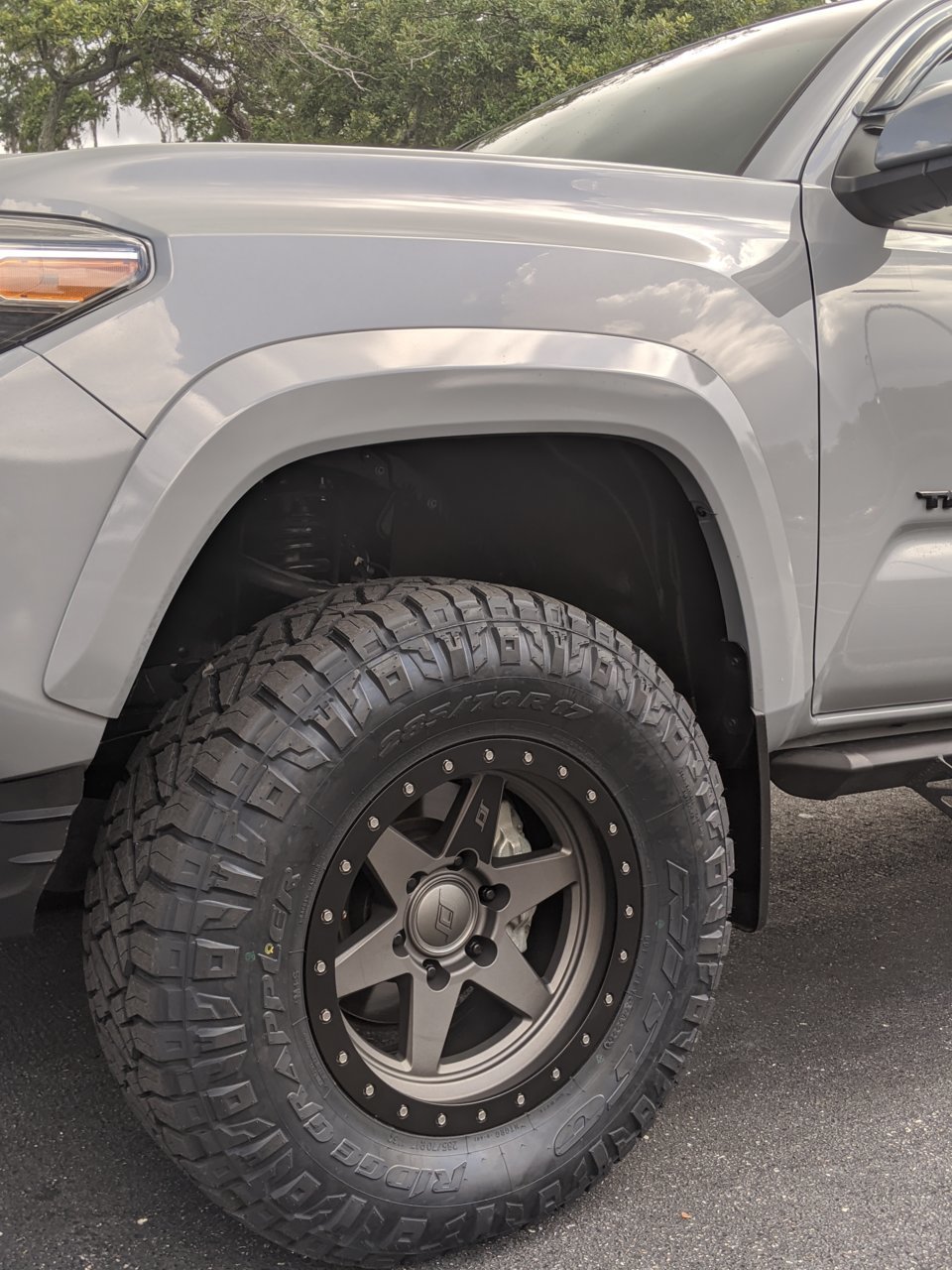

    Black Market Shaman and Law950 like this.

    Of course I was asking the same question for a long time but eventually went with 275/70r17 and am very pleased with the result. I have just slightly over 2" lift in the front and back.
    Don't get 285s and hope that you're in the lucky 5% that won't need new UCAs, CMC, trimming, etc. If you're going to go with 285s, factor in that you'll need some or all of these things. If you end up being lucky, well, so be it, but don't buy them and hope that you won't.
    My 265s looked good but maybe just appeared a hair too small after the modest lift, so I went with 275s. To my eye they look just right and I've had no rubbing whatsoever. I went from C-rated to E-rated heavier tires and couldn't feel the difference at all. Still drives the same, no hit to MPG noted and no acceleration difference that is noticeable.
    Sometimes 285s look great but at other times they just look a little too oversized to me.

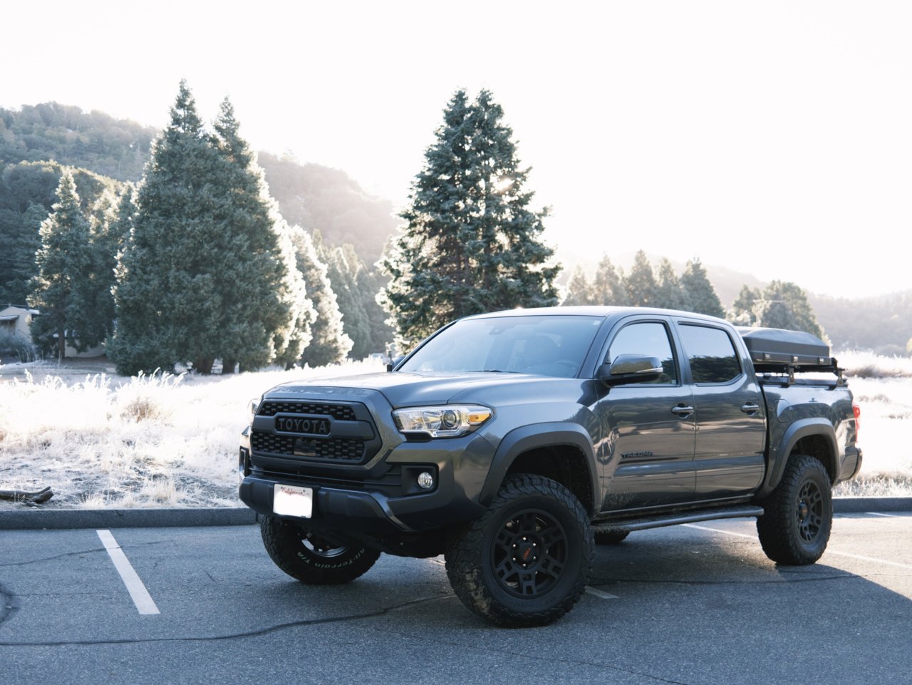

    285/75R16, CMC, trimming - no rubbing at all. 50/50 on road and off road.
    luked643, coma toy and Liv4Spd like this.
