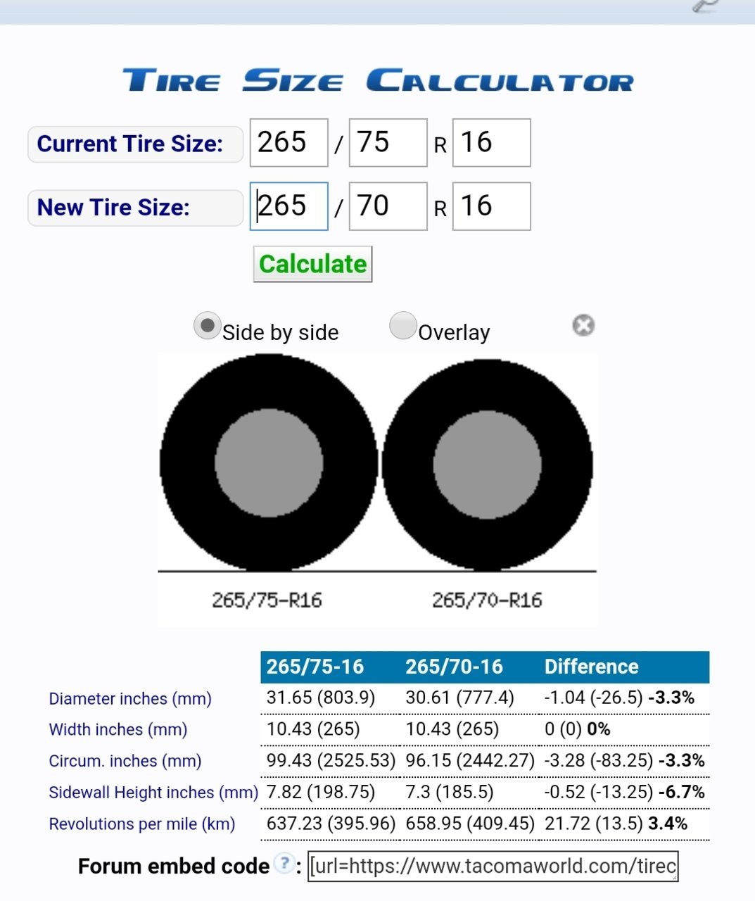

    265/75R16 is the same width and diameter as a 265/70R17...
    The 75 is about an inch taller (sidewall) in height. Other than that, they are pretty close in overall size.
