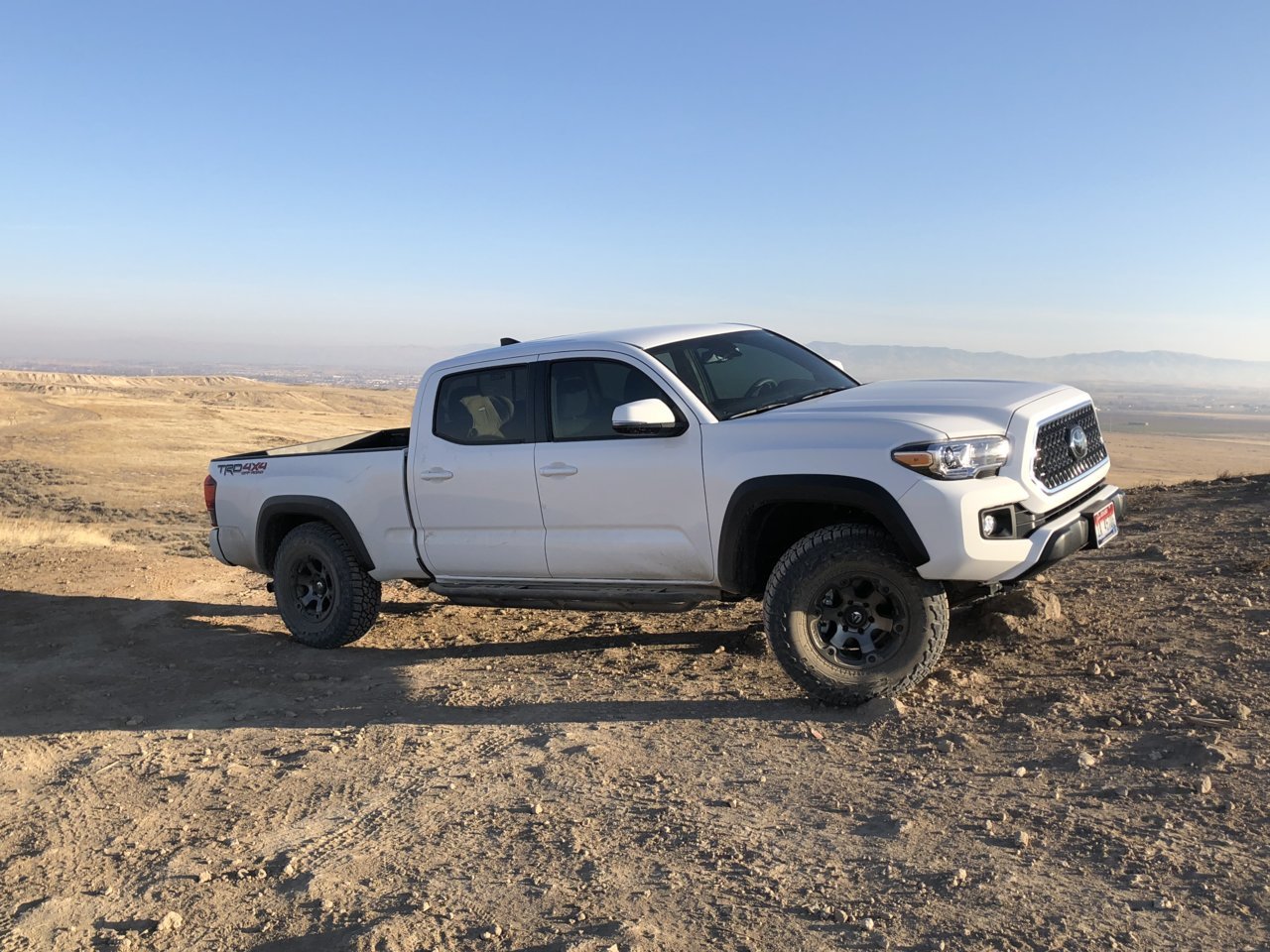

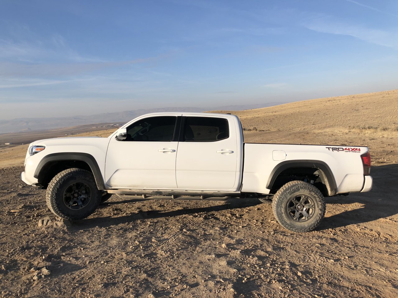

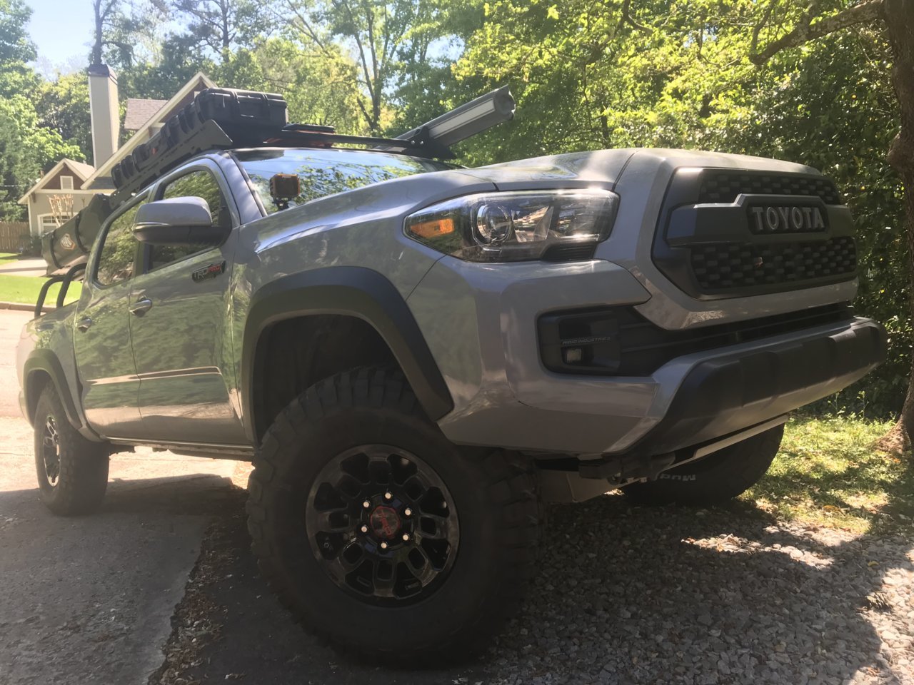

    16x8 FUEL BEAST 265 75 16 FALKEN WILDPEAK AT3 Tyger step sides 20% tint front to match factory tint bilstein 5100s on third notch PRO grill
    It’s your aftermarket wheels. What are the specs? 8 inch wide with 0 offset do not rub. If you have -12 offset, of course they can rub. If you have stock wheels or similar offset with aftermarket wheels you won’t rub 99% of the time
    Below is no lift and never rubbed.

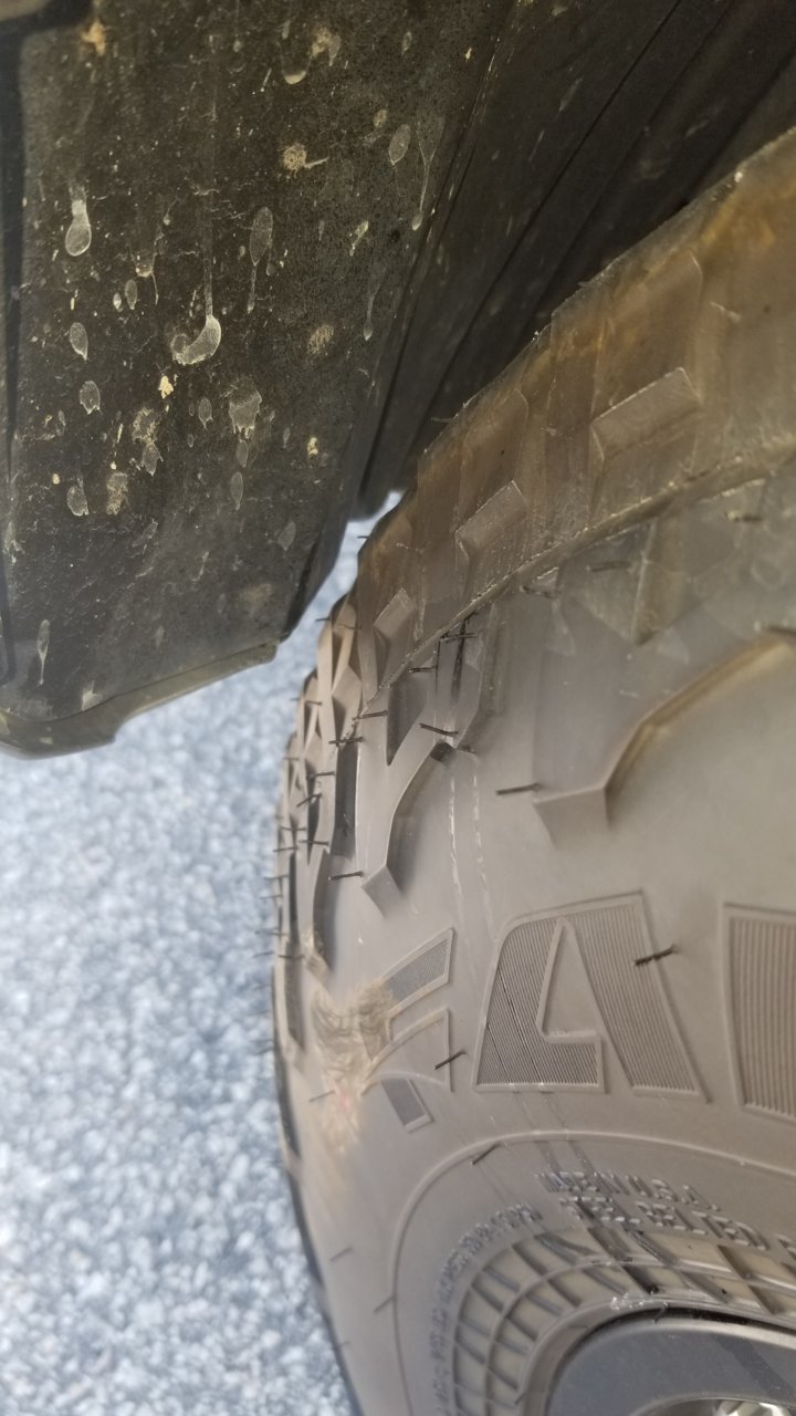

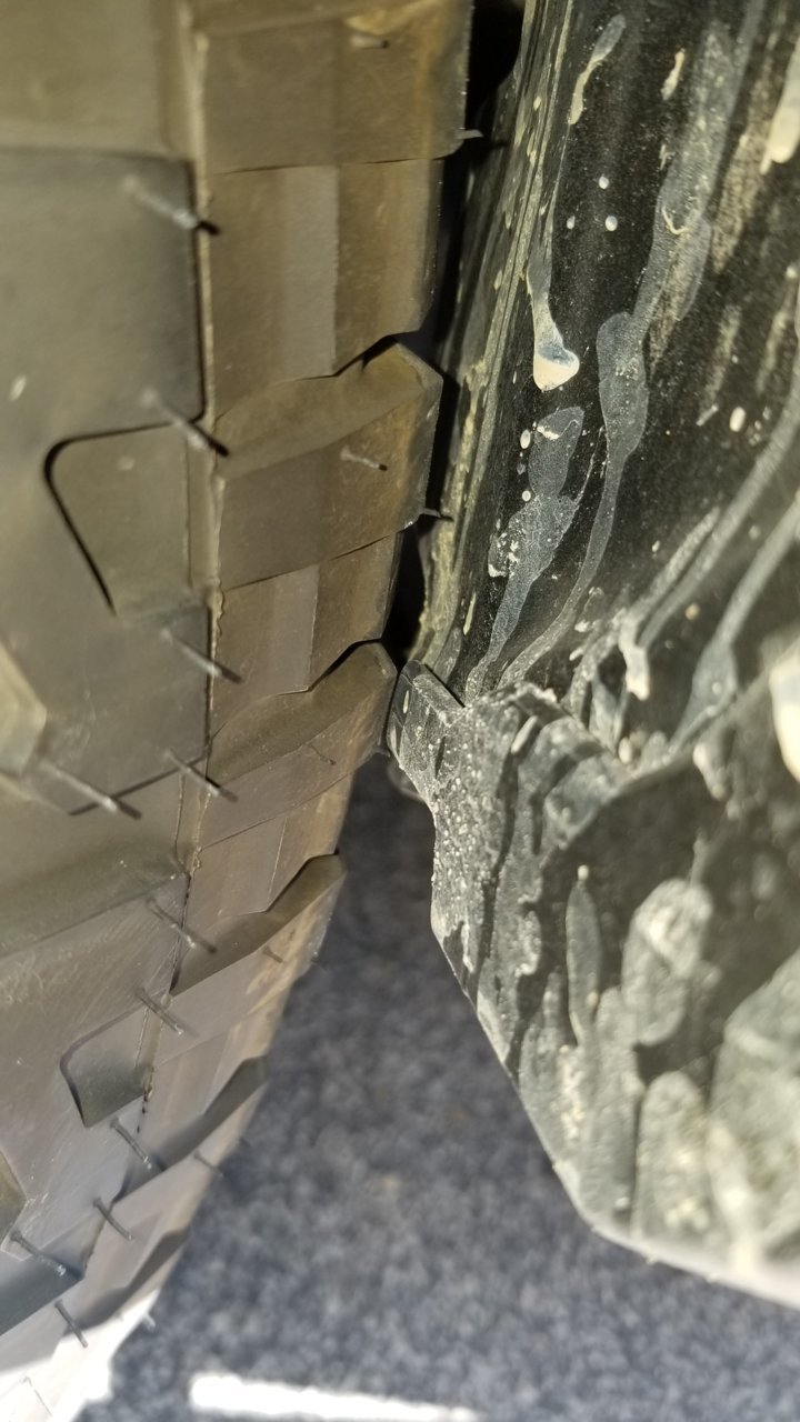

    I just got this size installed this afternoon on my 2015 DCLB SR5 on SCS F5 wheels, 16X8. Lots of rubbing. Had to remove front mudflaps and still have some rubbing on the little front flap. Not sure why some trucks claim "not rubbing ever" and some do. Perhaps its the variants of OR suspension setup vs SR5 set up? Only difference I can see.
