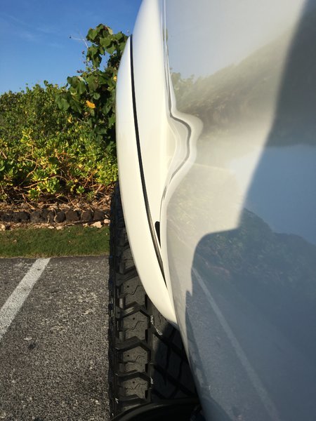

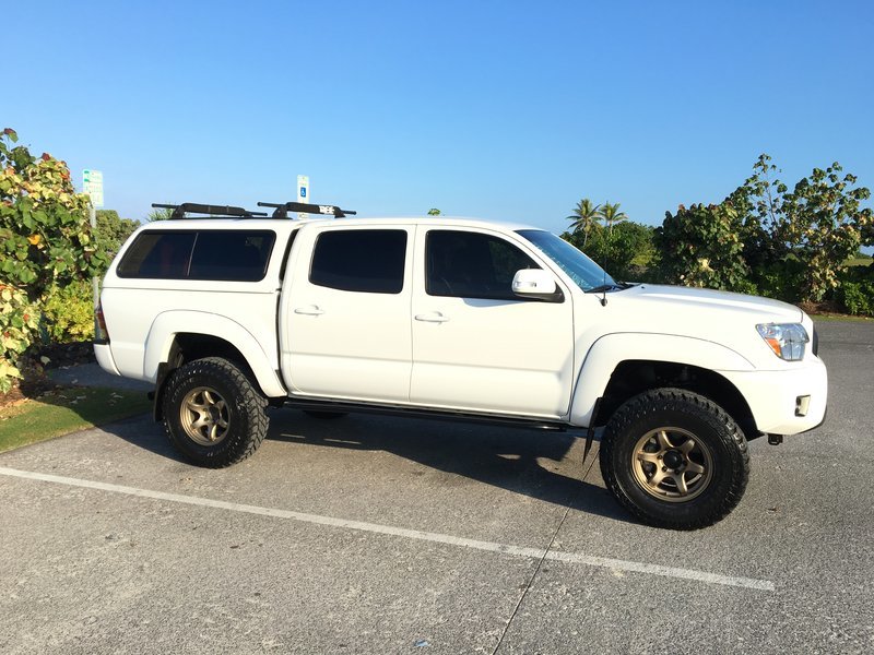

    here's 255/85 ST Maxx on FN Countersteers (16x8, 4.5" bs, 0 offset). I have ~2.5" lift in front, 3.25" in the back. only rubs in full-lock reverse, and haven't had any issues offroad yet.

    Would wheel spacers fix the rubbing issue for you?

    doubt it. probably easier to cut that plastic fender liner a bit, cause that's where it's rubbing. it's definitely not rubbing that hard enough to make me believe I would need a CMC though.
