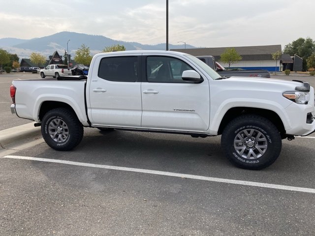

    Toyo is out of the black lettering so I had to order white lettering. Now the big question, white letters in or out?
    Here’s my truck with the stock tires.

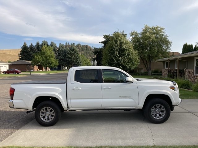

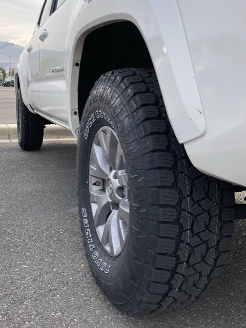

    Well, I went from this:

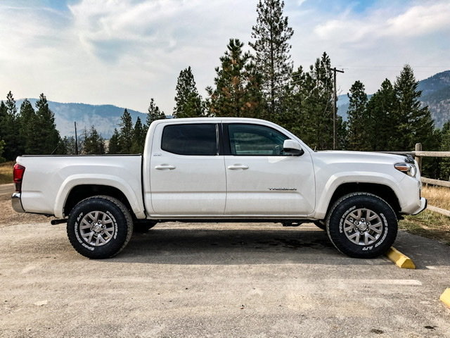

    To this:
    I’m so happy with the choice of going to 265/75 r16. The ride literally hasn’t changed and it gives the truck a much more appropriate stance.
    I also took a chance and went white lettering out. I’m really happy with the results.
    I appreciate all the great help on guiding me to this tire decision.

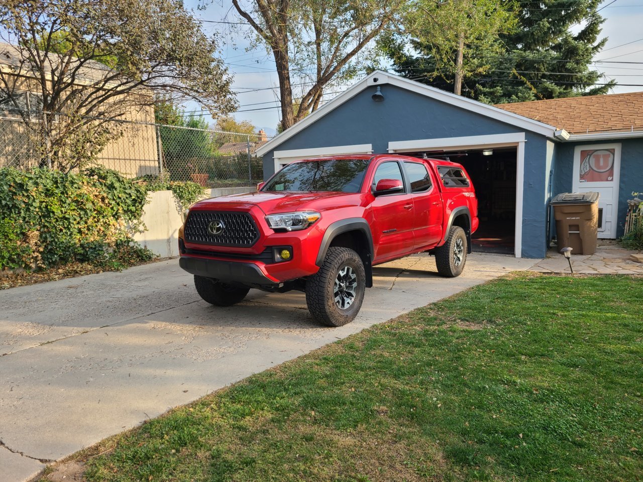

    Here's my 265/75/16's before my suspension:
    And after I installed my small lift this past weekend (Bilstein 6112/5160, Icon 3 leaf AAL, about 2" total lift):
    I loved how they looked before the lift, and honestly, I think they are perfect size after the lift. No need to go larger, IMO, just kills MPGs. Great size for off road driving.

    What clip setting did you go with on the 6112's? Looking at doing the same lift. Did you do UCA's?

    Clip 5 driver side/4 passenger side. Supposed to give me 1.5" in the front, but currently it's closer to 2". I'm guessing it'll settle a little more.
    No I didn't do UCAs. Haven't aligned it yet, but I'm guessing it'll align just fine.

    Nah, totally not my style. I don't like the wide "bro" rim/tire look. I also actually take my truck off road quite a bit, and don't want to ding up fancy expensive aftermarket wheels. My next set of tires will probably be pizza cutter skinnies also.
    However, I do like the 4runner TRD Pro SEMA wheels that everybody has. Especially in bronze....maybe someday.
