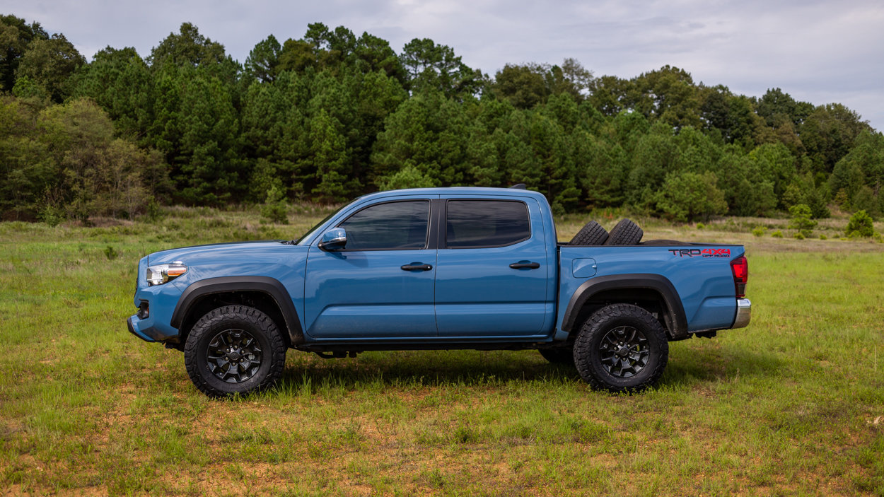

    265/75r16 - stock suspension - stock wheels

    Looks killer, what tires?

    Thanks! BFG KO2

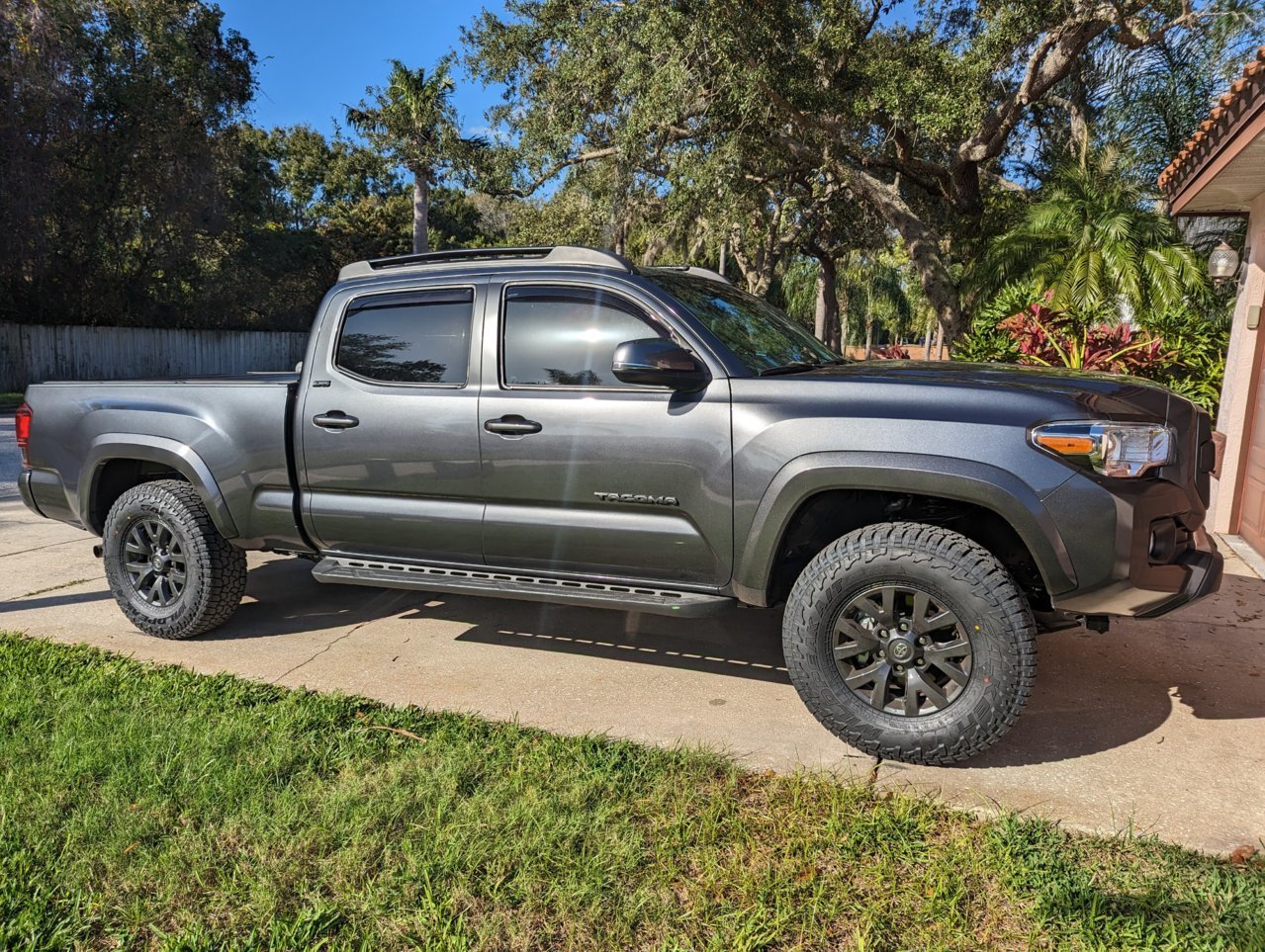

    265/75/16 Falken Wildpeak on stock SR5 suspension and wheels

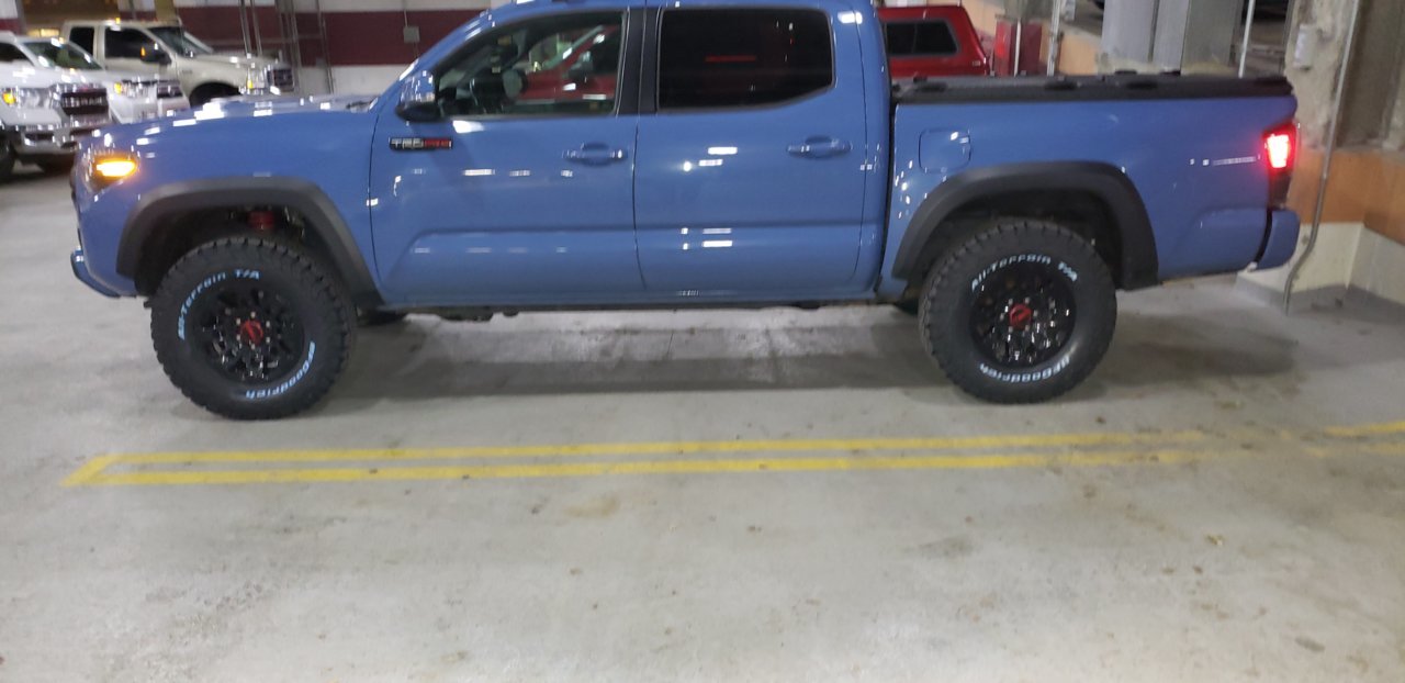

    My wife's 2019 Double Cab Sport came from the factory with the very light duty 265/65R17 tires, and the Sport wheels with 30 mm offset. Current setup is Off-Road wheels with BFG AT K02s in 265/75R16. The OR wheels have a 25 mm offset, so the centers of the tires on the ground are 5 mm further "out" and 13 mm further "down" than stock (~1/4" and 1/2" for you Americans) which means a few of her steering angles are very similar to stock, and the extra 25 mm of sidewall seems to compensate for the stiffness of the 10-plies.
    Personally, I think they look great and there are zero clearance issues. Highly recommend this as a nearly ideal setup for a driver who is mostly on-road but does some actual off-roading to get to a remote cabin, or just wants a bit more clearance above the snow. Not sure about US prices, but the 75s are a bit cheaper than the 70s here in BC...probably a supply/demand thing. (Update: the 265/70 size is often listed as being suitable for a SUV, and many of the tires have a higher speed rating ("S" versus "R" or "Q" for example) which might explain why they cost more than the 265/75 truck versions.)
    BTW: we took off her air dam and the "SPORT" decals, and added a TRD skid plate, so anyone looking closely is probably wondering how she got a DCSB MT with leather seats in Off-Road (not an option in Canada in 2019, nor now). With that "Look" and the Cavalry Blue colour, she gets a lot of people complimenting her on the truck.
