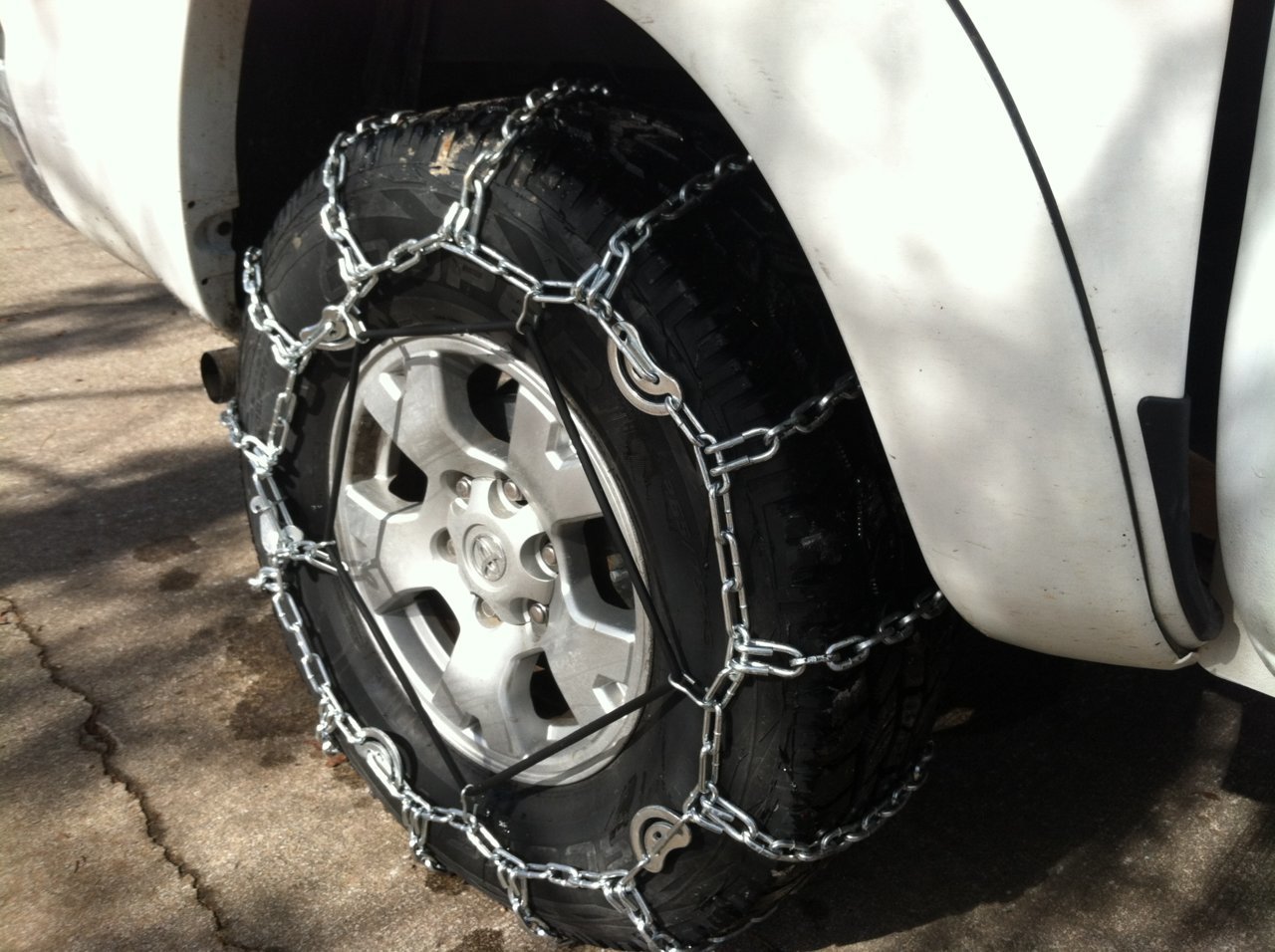

    I've been using 265/75/16's on stock rims for years, never an issue.
    Have room for snow chains on the rear

    No Mudflaps and a less aggressive tread are likely the reasons. The chains are on the back as well.

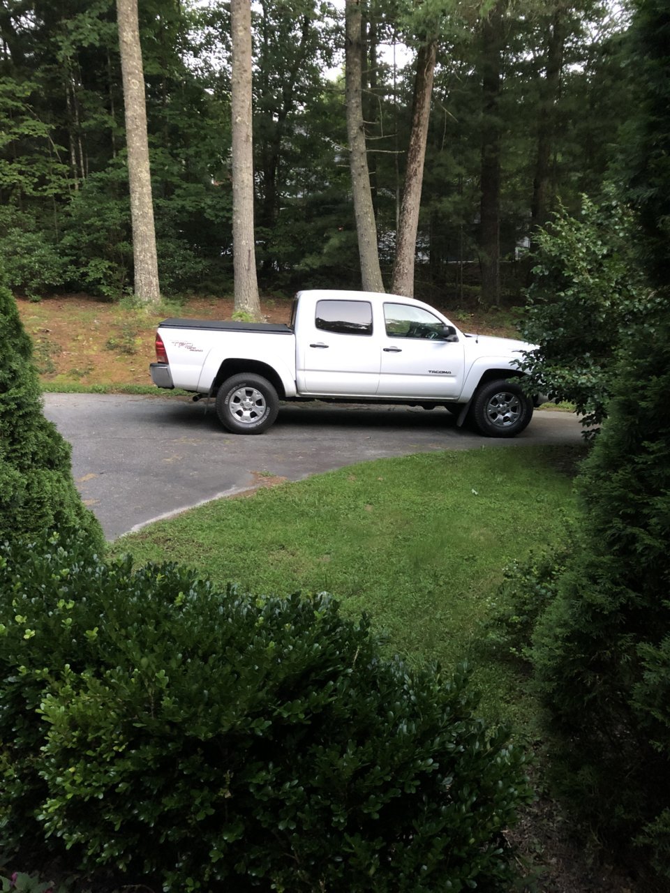

    Here’s my truck right now 2008 TRD Offroad with 41,000 miles. After this lift comes in and I figure out what wheels to run it’s gonna look totally different. Not to mention with all the light pod’s I also have on the way. It’s crazy this all started when I told myself I needed a “led light pod, fog light kit” then wheels and tires, now a lift. Thanks for the help I’ll post pictures to the thread if you guys want updates.

    Same wheels and size, same tires and size, no lift. Rubs enough to annoy you.
    Don't have a great pic showing them, but eh:
