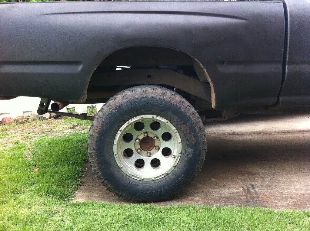

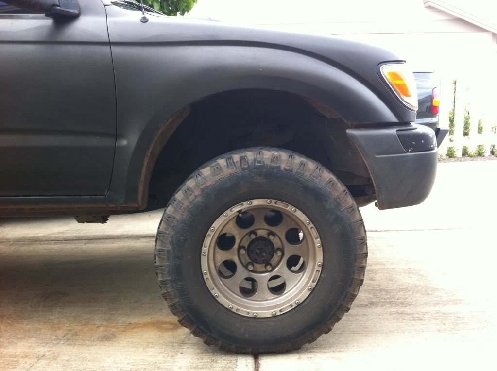

    Need your guys help. Looking to put new 285/75/16 on my truck. Currently have 265/75/16. Will it fit with a little cutting or no cutting at all? I took some pics just so you guys can see how it looks now with 265/75/16tp128_f3608e48a3f7d58c03d1940942cfbc6c9a3b7336.jpg

    how many inches of lift is that?
    the 265's look good in the front, but they do look a little small in the back

    What is the backspacing of your wheels, and how much lift do you have?

    I am not to sure I just bought the truck. I think the back is 2" with a 1" AAL. Not to sure about backspacing. Can I check with the rim on the truck?

    Yes, measure the distance from the back edge of the rim to the point that it mounts on the hub.

    It looks to be 4.5 BS

    4.5" BS is stock BS for 1st gens. you can fit those 285's, but you might have to trim a bit.
