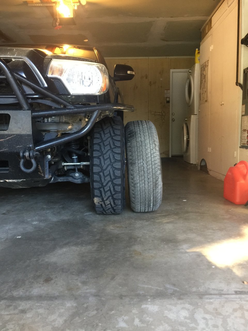

    I'm happy with my Toyo RTs, 255/80r17 on FJC wheels, no spacers, minor scrubbing at stock height.
    Compared to stock spare (265/60r18)

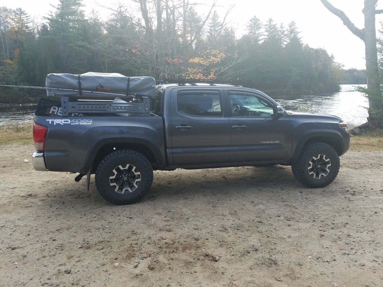

    20171015_091217.jpg 265's float just fine for me. Most of the places I fish/camp start off in low elevation farmland with loose topsoil / mud, turns to waterboards and creeks as elevation goes up, and then rock gardens at the top, about 1400'+ later .
    If it's for looks or a size that also gives height that matters to you, go for it. I think this is kind of a "to each their own" topic. Just figured I'd share my side.
    Ps best mod, the fishing pole holder. Pretty expensive but came with a free tent.
