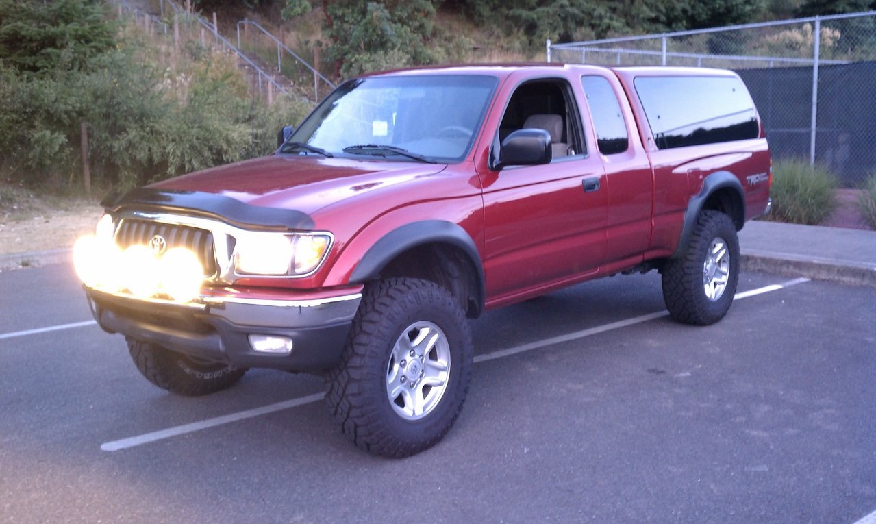

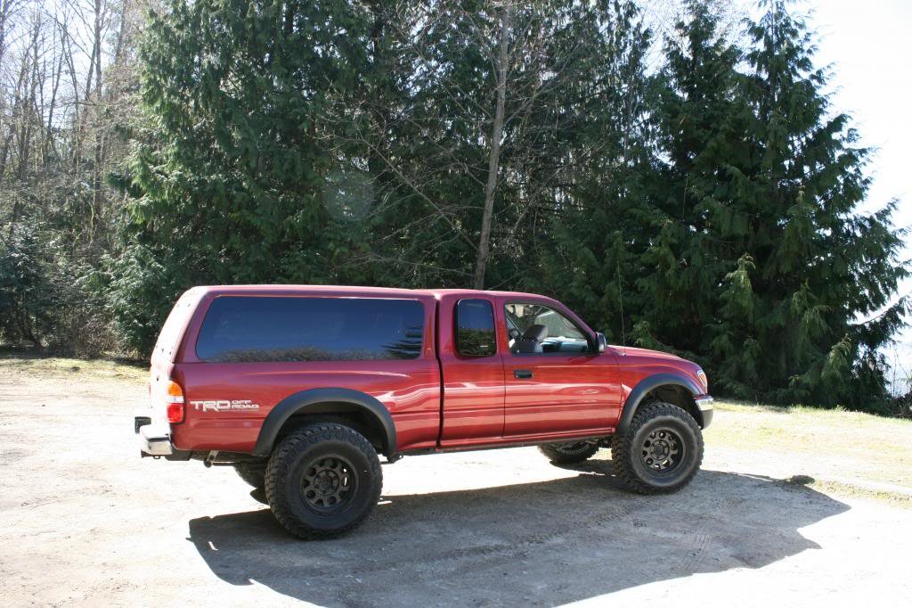

    I have 285's now with 881's and the 10mm spacer. Wheels are 4.5" of BS. The "look" of the truck with 265's always bothered me, could never really put my finger on what bothered me. I will say that 285's look awesome and I wish I would have stepped it up a long time ago.
    There are some downsides. The brakes seem a little mushy now, not horrible, but definitely noticeable. The truck is a little slower (I have stock gears), but I don't drive my truck like a sports car either.
    I didn't cut or trim anything to fit the tires and I don't rub, however, I have not taken the truck off-road since getting tires a few weeks ago. I am 100% sure it will rub if fully flexed, but I understood this before stepping up to 33's and I will make the necessary changes before doing any serious trails.

    Are both pics 285s.

    :confused: Not sure who you are referring to...both my photos are labeled with the tire size.
    On my post the top picture (black wheels) is w/ 285's, the lower picture (silver wheels) is with 265's.

    Oh I am on my phone and only see the 285 label. Thanks for clearing that up
