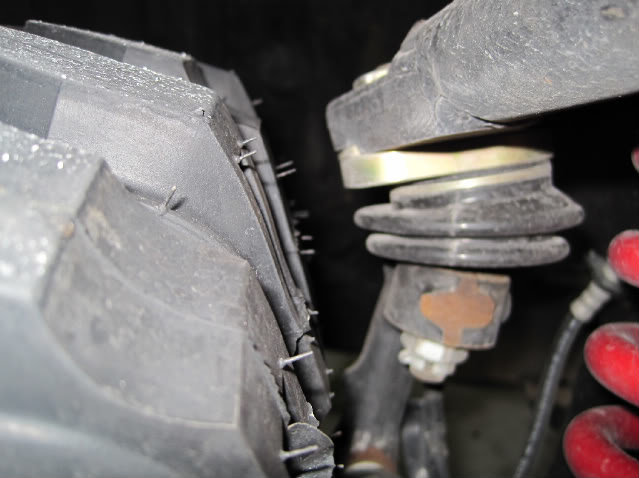

    I think you would need spacers, wheels with different backspacing, or aftermarket upper control arms.

    Yea, thats exactly what it looks like. I cant hardly get my finger between the UCA or spindle. I went ahead and ordered 2 sets of spidertrax for all around. Besides fixing this issue, it will make the stance look better too. Thanks for the pic!
