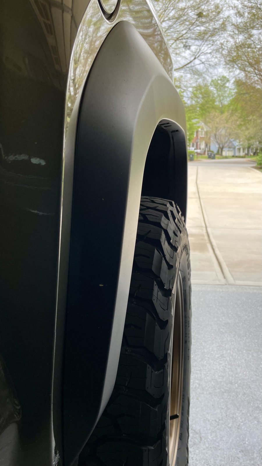

    Factory offset on Off Road wheels is +55. +25 is just about as flush as you can get with the rim aligning to the fender on an off road and sport (they have added fender flares). +35 would be closest to flush on SR5 without fender flares.
    photo below is Method MR318 18x8.5 +25 offset with 285/70R17 BFG KO3s (the tread with is quite a bit narrower in BFG tires compared to comparable alternatives. Perfect IMO…

    yea I love your truck. I think I’m going to get 316s and sell these
