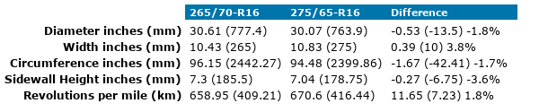

    Why would you? I searched around a bit and I didn't find any tires that come in that size.
    Here's the calculation over stock tires. You're gaining nothing. Except running some obscure tire.
