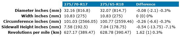

    TW member TeamFast put 275/70/17's on his stock sport wheels and they rubbed the UCA at ful lock.

    I think you still might rub the UCA because the 275/70/17's and the 275/65/18's are basically the exact same size.
