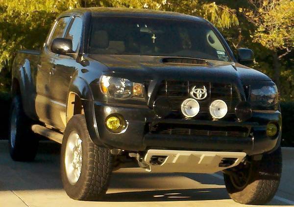

  13. Jan 19, 2011 at 9:21 AM

  14. Jan 19, 2011 at 7:38 PM
