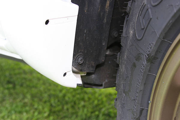

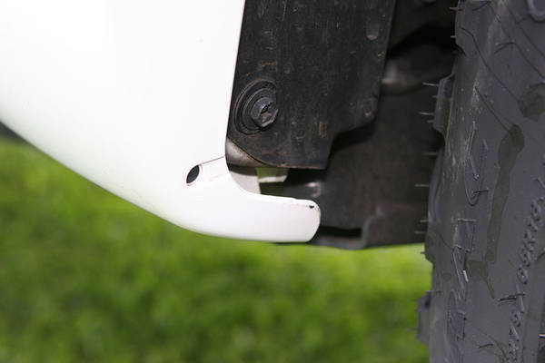

    Kidd, your pics just sold me on the 275/65R18. Looks tough! Do you have any pics of the trimming you did so I have an idea of what needs to be done? I appreciate the help!

    They're 1/2" more narrow than a 285.....best of all worlds IMO.
    Here's the pics of the trimming I did. The front inner fender is all clear. If anything I would have to trim more of where I already started.

    I take it this is the rear side of the front inner fender flare? Is the trimming you did visible/noticeable? It doesn't look like you had to take much off. What did you use to do it? Do you get any rubbing anywhere now that you've taken the 2inches of plastic off?

    Yep rear of the front flare. Is it visible? Yes. Is it noticeable? Not particularly. I used a dremel with a cut off wheel and a sanding barrel to finish it off. No more rubbing so far but I haven't put more than 20mi on it since I made the initial cuts.
