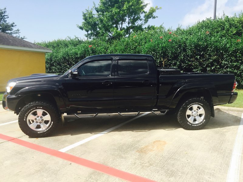

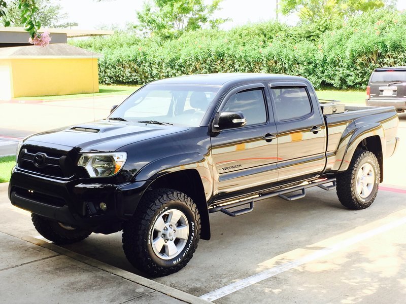

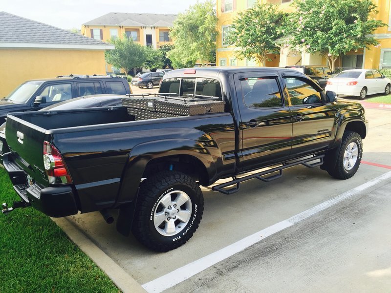

    jjptaco , what size are those tires, do you have a lift , any wheel spacers added. I am planing to buy 275/70 17 and i have your identical rims . I am adding fox 2.5 with reservoir DSC front 2-3"and rear 1-1.5" lift , and total chaos upper control arm. My question is , any rubbing to UAC or suspension part . thanks

    avh128avh128, Yes I have 275 70 17 BF Goodrich KO2 AT, I put a toytec 3" forward 2" aft add a leaf. Oh and yes at full lock there is slight rubbing on the UCA. not a problem to me, but if it really bothered me I believe wheel spacers would solve the problem. Again it is very slight

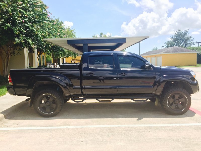

    The latest pic blacked out them wheel's

    Thank you. Your wheels look good
