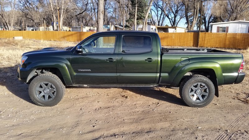

    A 275 spare fits fine under the bed.....just enough room. Factory sport wheels have a 30mm offset while the T4R Trail rims have 15mm offset. Here's my 2013 DCLB with 6112s set to 2.25" (3rd setting), dakars with the third leaf removed, 5125s, T4R Trail wheels and Cooper AT3s in 275/70-17.

    Did you remove your mudflaps because they rubbed or just for looks.
    This will be pretty close to the setup I will have.

    You know, I took them off before I put the lift on because the tires rubbed just slightly. I think I may put them back on now that I have increased clearance. We'll see if they fit anyway.....
