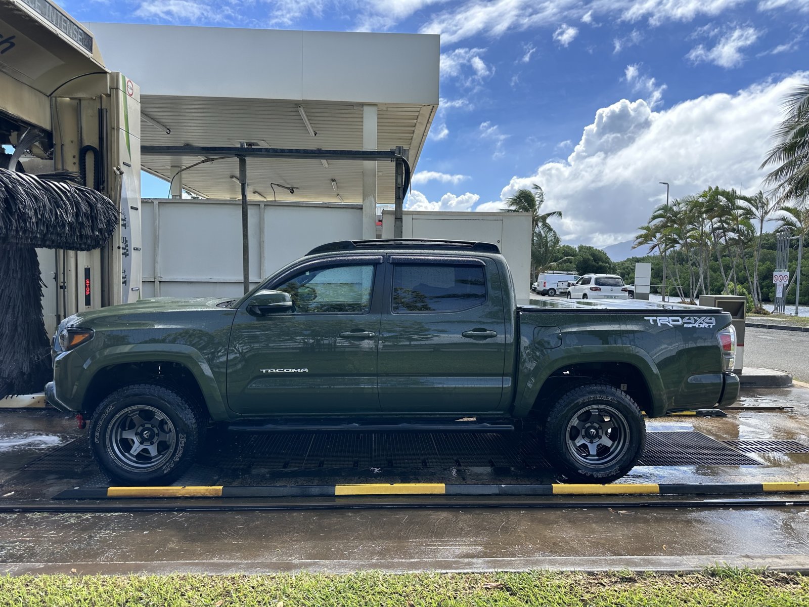

    Hi everyone! I guess I’m in the right thread so here it is: I’m planning to install the OME MT64 shocks front and rear, looking for 2" front and 1"rear (with a 1" block). I’m also trying to decide if I could put 275/70/17 tires as I have 17x10 -18 offset fuel wheels without CMC or should I stay at 265/70/17.
    NB: On the picture my truck has 265/65/17
    Thank you to the community if you have any advice!
