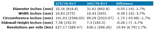

    I plan on ordering me a set of bilstein 5100's and trying to decide if i should get 265/70's or 275/70's. What kind of gas mileage would i loose gettin 275's and would it change my speed gauge? also id like to see pics of this set up. I drive alot and want things to be good.
