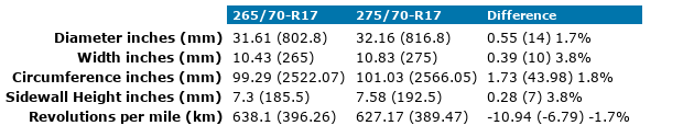

    There is exactly a half inch difference on the diameter, calculation wise. The actually size of the tire may vary. The other thing to consider is there are not a whole lot of 275's choices out there. I just found 5 on Tire Rack and Discount Tire direct.
    from the online tire size calculator
    I don't know anyone running them offhand. Personally I wish they had more of a selection in the 275.
