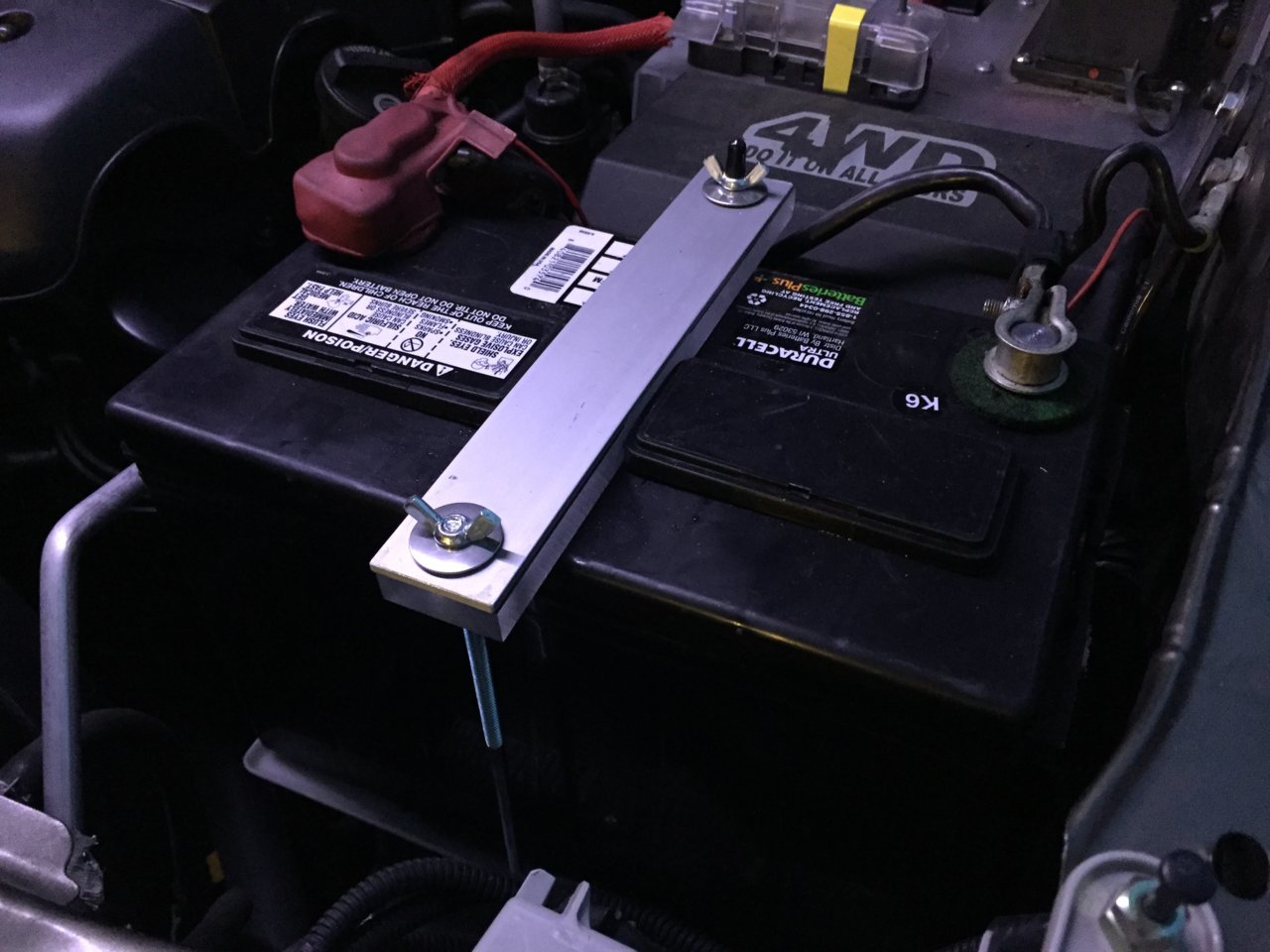

    If the battery is only maybe a half inch or inch taller then just buy yourself either a universal bracket, or you can get yourself a set of extended length J-bolts and make yourself a new bracket out of a flat piece of aluminum or something.
    I made a new tie down using a 1/2” thick piece of polycarbonate flat reinforced with aluminum flat on top.
    Like so:

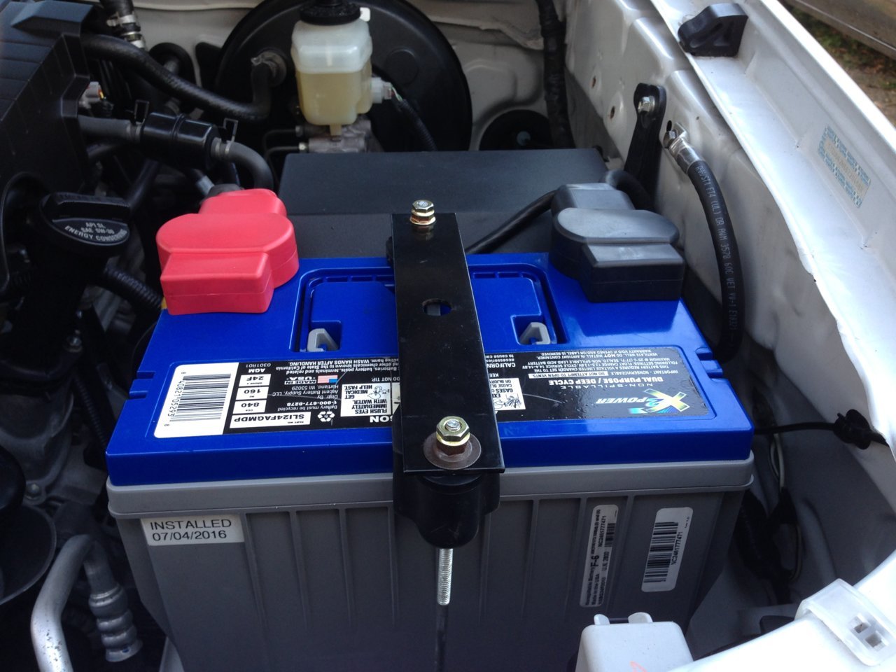

    I had to flip up the handle on my Northstar to get the bracket to fit. The bracket now runs through the handle. @Dodipooh , did you try that?

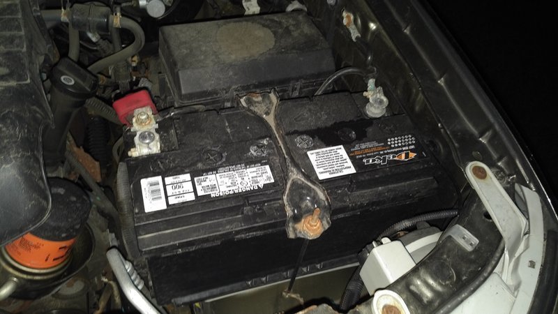

    You would think the stock battery hold down would be adjustable at both ends.
    I had to ditch my stock battery hold down bracket for this battery. I was planning to order the pretty $40 aluminum hold down but temporarily used an edger blade and some new J-hook rods with rubber spacers.
    (Two years later I still haven't gotten around to ordering the fancy one.)

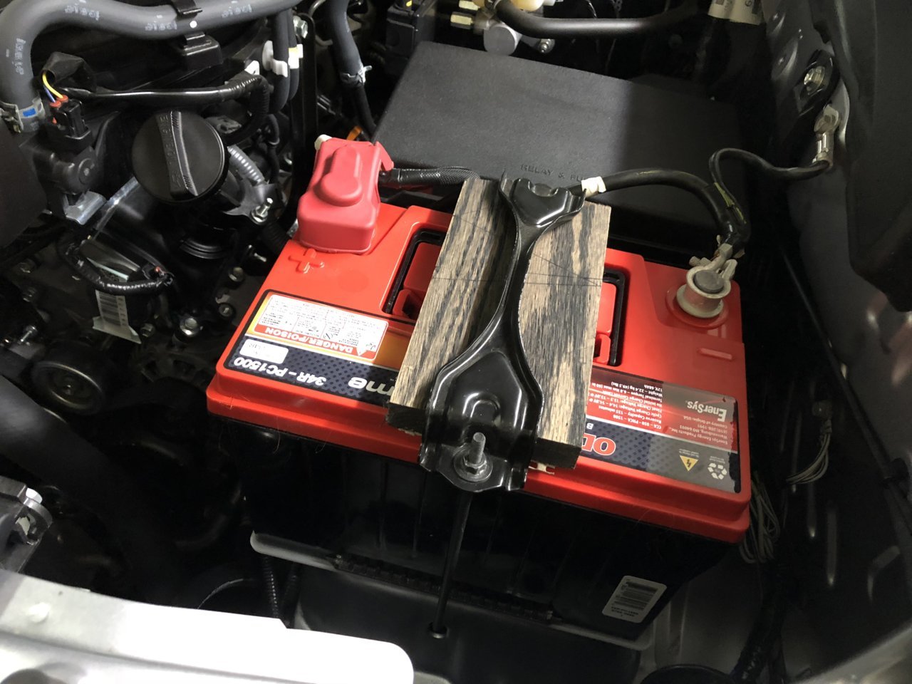

    I went with this which is about a 1/4 in shorter than stock. I added a wooden spacer under it
