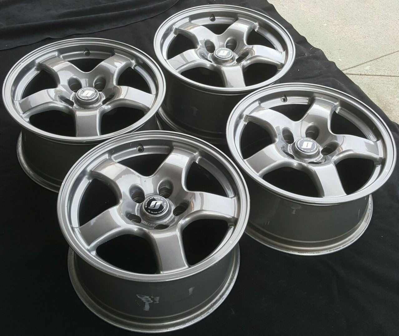

    What I bought - 16x8 +30 Forged AL 5 spoke Nissan GT-R OEM wheels.

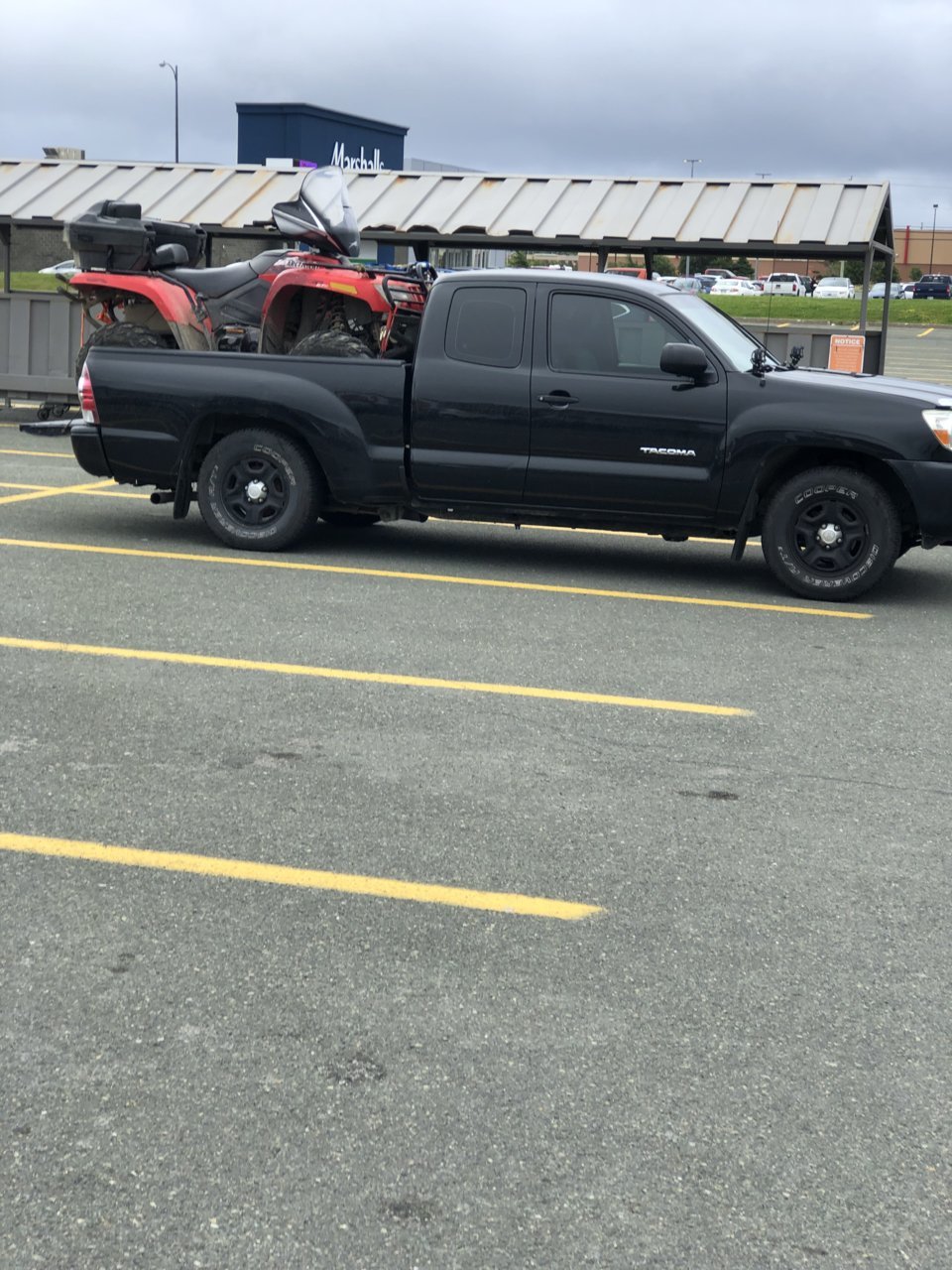

    I run 235/75/15 cooper discoverer at3. No issues when it comes to power delivery or gearing. Still tows around 4000 with relative ease. The rims I’m using are OEM

    Iirc the biggest you can go on these trucks without minor mods (blackbox or spacer lift) is 30 or 31 without rubbing. I can’t remember off the top of my head, but don’t exceed it unless you’re willing to slice open the wheel well to remove the black box

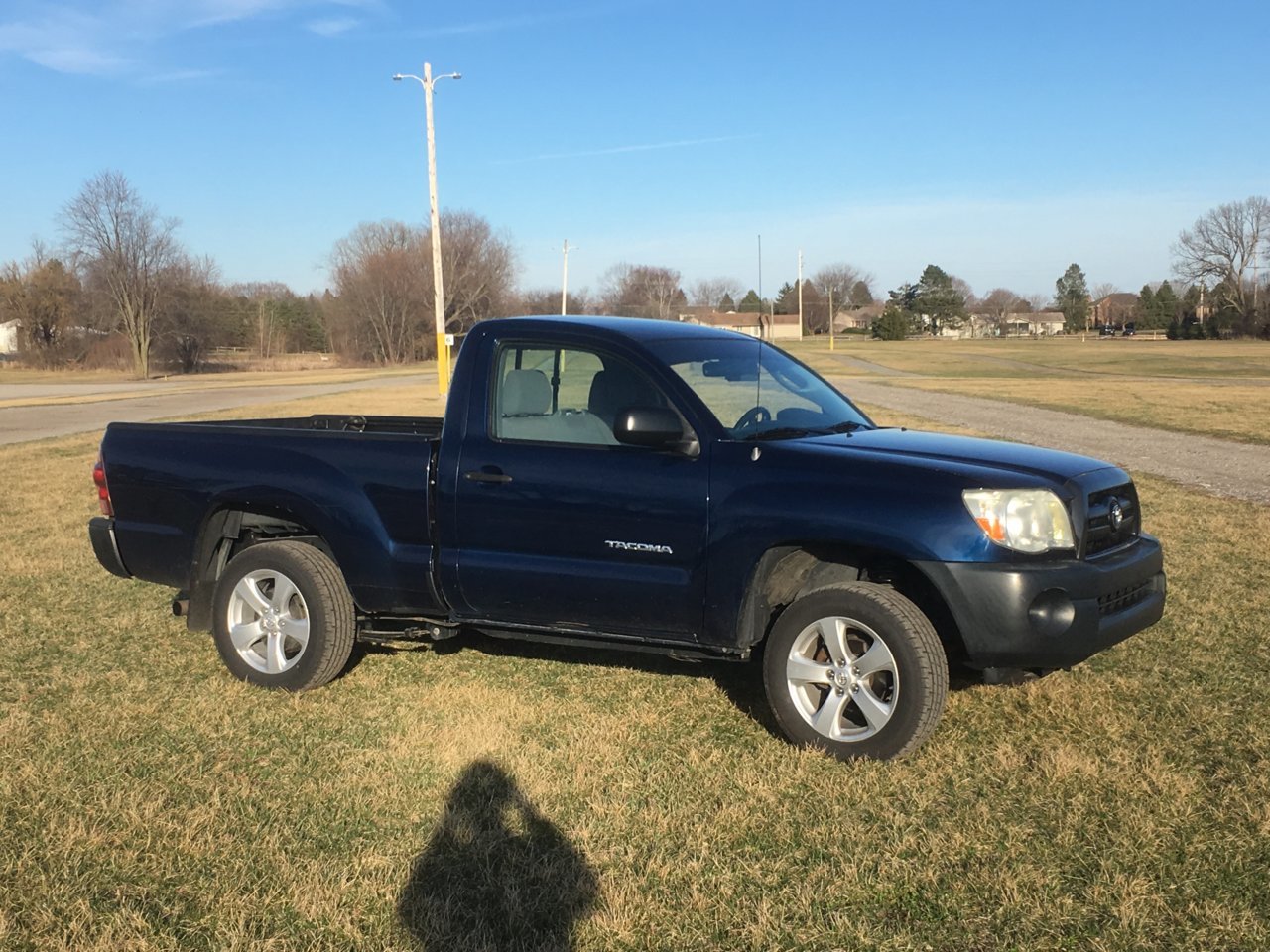

    I have an 2008 5-lug 2WD Regular cab with the same door jamb sticker axle code, A01A, which should make the rear gear 3.42 to 1.
    I found out quite recently that the truck actually has a 3.73 to 1 ratio. How? See the ** below.
    I ditched the stock 215/70/15 26.9 tall wheel and tire combo shortly after I bought it and use one of the 2 following wheel/tire combos depending on the season.
    225/75/16 29.3
    tall (7JJx16 ET38 it's a Discount Tire Winter wheel/tire combo I bought on craigslist) or
    225/60R17 27.6 tall (Sienna wheels 7JJx17 ET35, this is the Summer set, again craigslist for the wheels, I bought the tires in a good size, not too big, not too small)
    Both are taller than stock, the 16' winter tires are 2.4 taller. The performance is a little more sluggish (with them) but it's not bad, it's quite normal if you don't think about it
    It never really goes above 2000 rpm during normal around, cruising or driving, if I run it up to 3000rpm I'll be doing 100 mph. I plan on re-gearing it to 4:10 to 1 and throwing in an LSD at the same time. It will not be a drastic change at all.
    You can easily see the different gearing RPM and speeds using the link below, that's how I found about my actual gearing.
    I knew my speedometer was (and should be) inaccurate because I changed tire diameters. Using the 3.42 to 1 gearing in the equation (link below) gave incorrect speeds to what I observed for a given accurate RPM. Why?
    I knew my tire diameter, I knew the engine RPM and I knew my actual speed because I used a Speedometer app on my iPhone.
    I plugged in axle ratio numbers till they got closer then I plugged in a known Tacoma OEM axle ratio (3.73 to 1) and there it was, correct RPM and speeds for the speeds and RPM I was checking.
    It is a very useful "thing".
    https://www.blocklayer.com/rpm-gear.aspx
