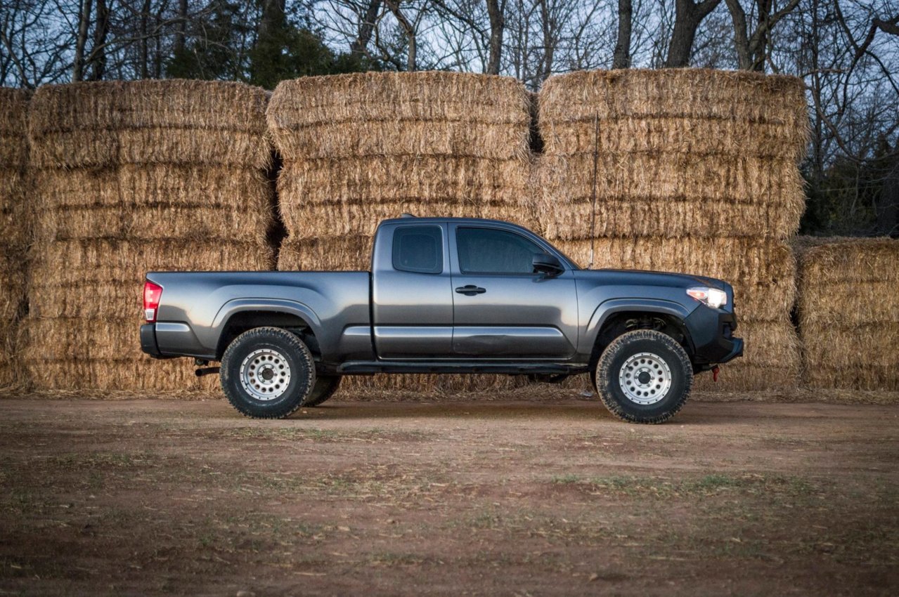

    I have 285/75/16s on my 2.7 5 spd. I have a 1 inch lift in the front. It rubs mostly in reverse, unless I get suspension articulation, then it'll rub a lot. I am running wheels with crazy offset though. I ran stock gears for about 2 years. It's slow as fuck, say goodbye to 5th gear. You'll be in 4th on the highway and will downshift to 3rd to accelerate. 4.88 gears are mandatory. Wtih 4.88s you're still slow as fuck, but the engine wont be killing it self trying to turn those tires on the road. It also puts the rpm in a good range in 5th gear so that you can maintain speed and accelerate slowly when you need to.

    what year is your truck?
  9. Dec 10, 2019 at 5:28 PM
    #29
    Sep1911
    Sep1911 Well-Known Member
    Oct 2, 2015
    #165670
    1,237
    2016 Taco
    2016
    pic for shits and giggles
