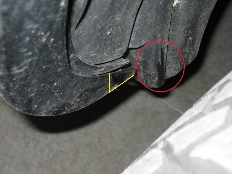

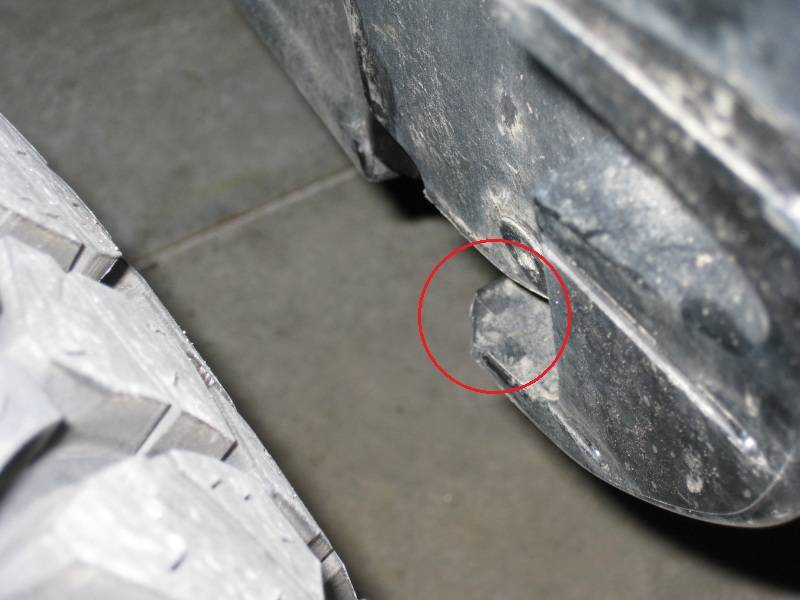

    Had to make a small 45 degree cut just behind the wheel...
    I will be making this cut (yellow). Notice the other area that is rubbing (red)...I think I'm just gonna let that continue. You barely hear it, and after the lift, it won't rub 90% of the time. But the cut has to happen...
