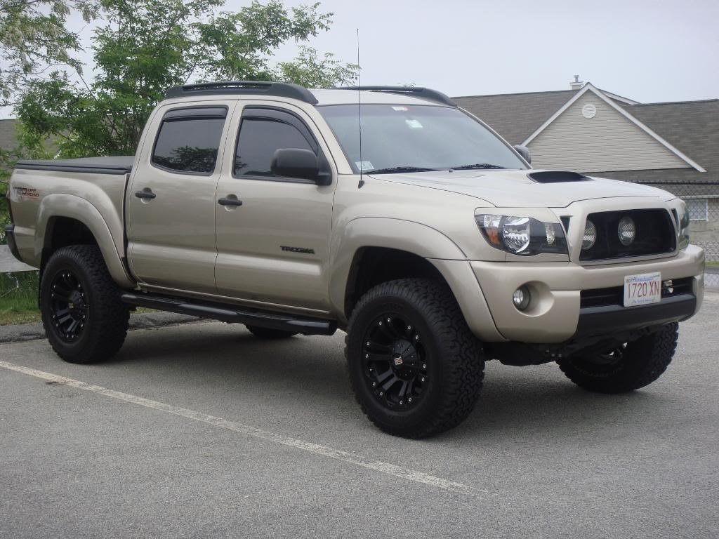

    take off the front flaps, sell them like other said. you need to lift it up, it will look even better, i got my monsters last june i believe, first one on toyotanation, i got so much crap for getting them in the 18" size, i love how they look, and now there are a one of them around the forums now, lol, i got them to be different, but with mine, i trimmed a ton in the front, i cut out the whole plastic part, so when wheeling, i will never hear that noise again, plus i have bfg a/t's they are boxy. i love the look of your truck, now lift it, you see what mine looks like, do it, lol

    Oh, the lift is already scheduled for 3/12. Mud flaps are gone...but I just want them back on. I want the protection they offer, but can live without them.
    This thread has transformed into an informative thread more than "questions I had" thread. There are others out there that are looking for answers to "what if's". Plus, there are a lot of people (myself included) that don't want to just hack the hell out of the fender to get it to stop rubbing. I only want precise and necessary cuts.
    Your truck looks great, BTW.
