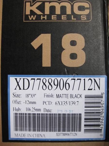

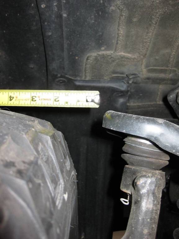

    I just went out and took a picture of the side of the box that my rims came in...
    This matches your info above, but it definitely measures 4.5" bs.
    Also, see the space between the UCA and the tire...
    If you're wanting yours to stick further outside the fender, and you like the distance mine show, then buy a 4.5" bs, with a 12mm os.

    Ok cool! Now I'm confident that yours are 4.53" bs and-12mm os. Thanks for the info! I'm still a little confused however? I guess my stock wheels have less bs because mine being an O.R. And coming with bigger tires 265's vs245's on the sporty's? I can't remember how much space I had before the lift? I guess the lift is pushing the uca closer to the tire?
