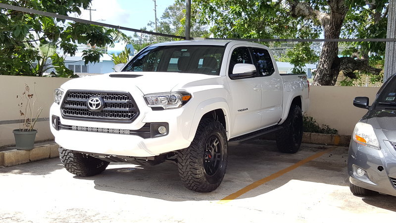

    Tacoma 2017
    Trd pro runner wheels, led lighting, 3 inch lift, trd exhaust, trd intake,subwoofer
    Will see .. next week i hope i can install them.. ill post whatever results i had then

    Got it! Im not planning to do extreme off roading.. i mean its a brand new truck but for sure if im gonna do real offroading a will need a better setup.. but thanks for the advise

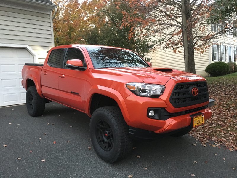

    I have a 3 inch Boss lift, new UCAs, and 285/70 17 with factory TRD Pro 4Runner rims. Its an automatic, so it kinda ran like ass before the lift. The tranny sucks. My MPGs went way down. I have not re-calibrated but it dropped by 4. I so it is probably more like 3.
    It rubs on sharp turns sometimes. I may try a 1 inch body lift and wheel spacers as soon as I clean the garage.

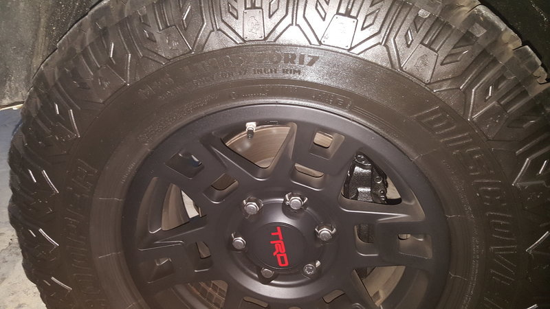

    What offset r the trd pro rims
