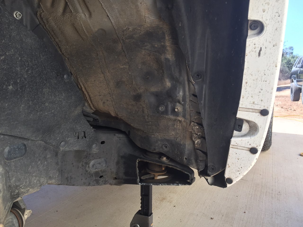

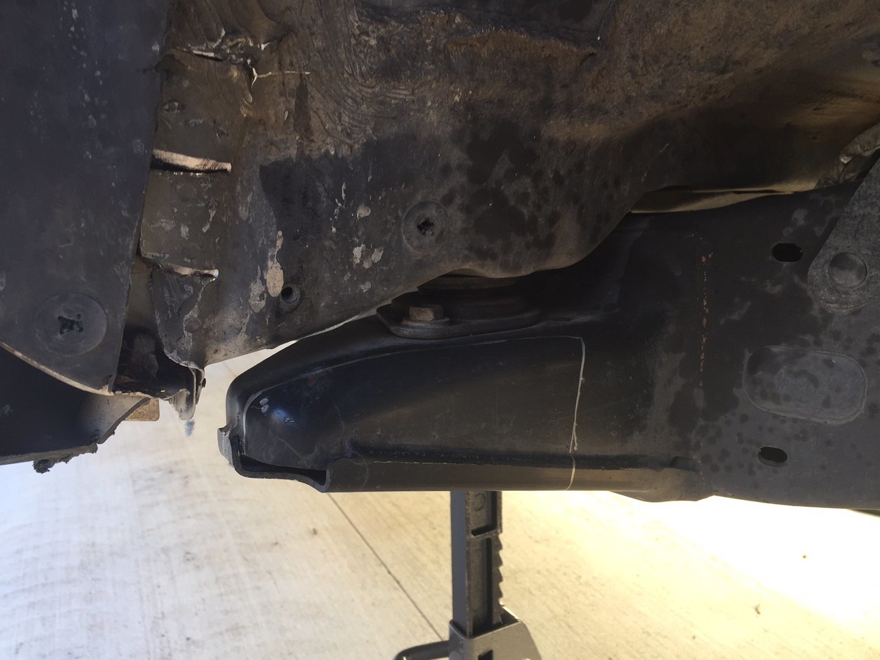

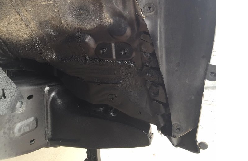

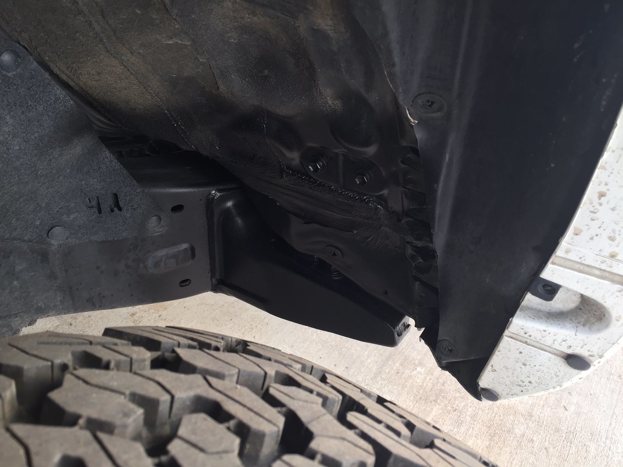

  9. Dec 6, 2017 at 12:58 PM
    #29
    FJ to Taco
    FJ to Taco Well-Known Member
    Mar 10, 2015
    #150578
    556
    Tony
    Lacey, Wa
    2015 DCSB 4x4 TRD Off Road,Snugtop Rebel
    Bilstein 5100's all around, OME 885's and OME Dakar CS047R Leaf Packs. Snugtop Rebel, pet screens,front slider drop down window. WeatherTech mats. Interior LEDS
    No worries, BMC, would be a Body Mount Chop, there is a section behind the front wheels that is taken out so the bigger tire does not hit when turning. https://youtu.be/0v2h6pBzIrs
    You will only need to replace the UCA's if you lift 3" or above.

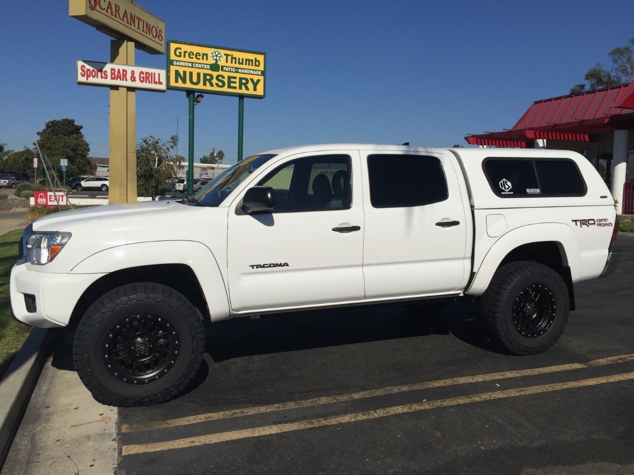

  13. Mar 29, 2018 at 11:19 AM
    #33
    FJ to Taco
    Mar 10, 2015
    #150578
    556
    Tony
    Lacey, Wa
    Hi Paul, I couldn't say on a 3rd Gen. Although t here are other factors that you would need to think about like Seth mentioned. Are you going to put on different wheels? (backspacing)? I would say a 2 1/2 would be best with a body mount chop and if you are going to put wheels on something with these measurements would work:
    17x8.5", 6x5.5 Bolt Pattern, 4.75" Backspace, 0mm Offset
    It should function nice for you.

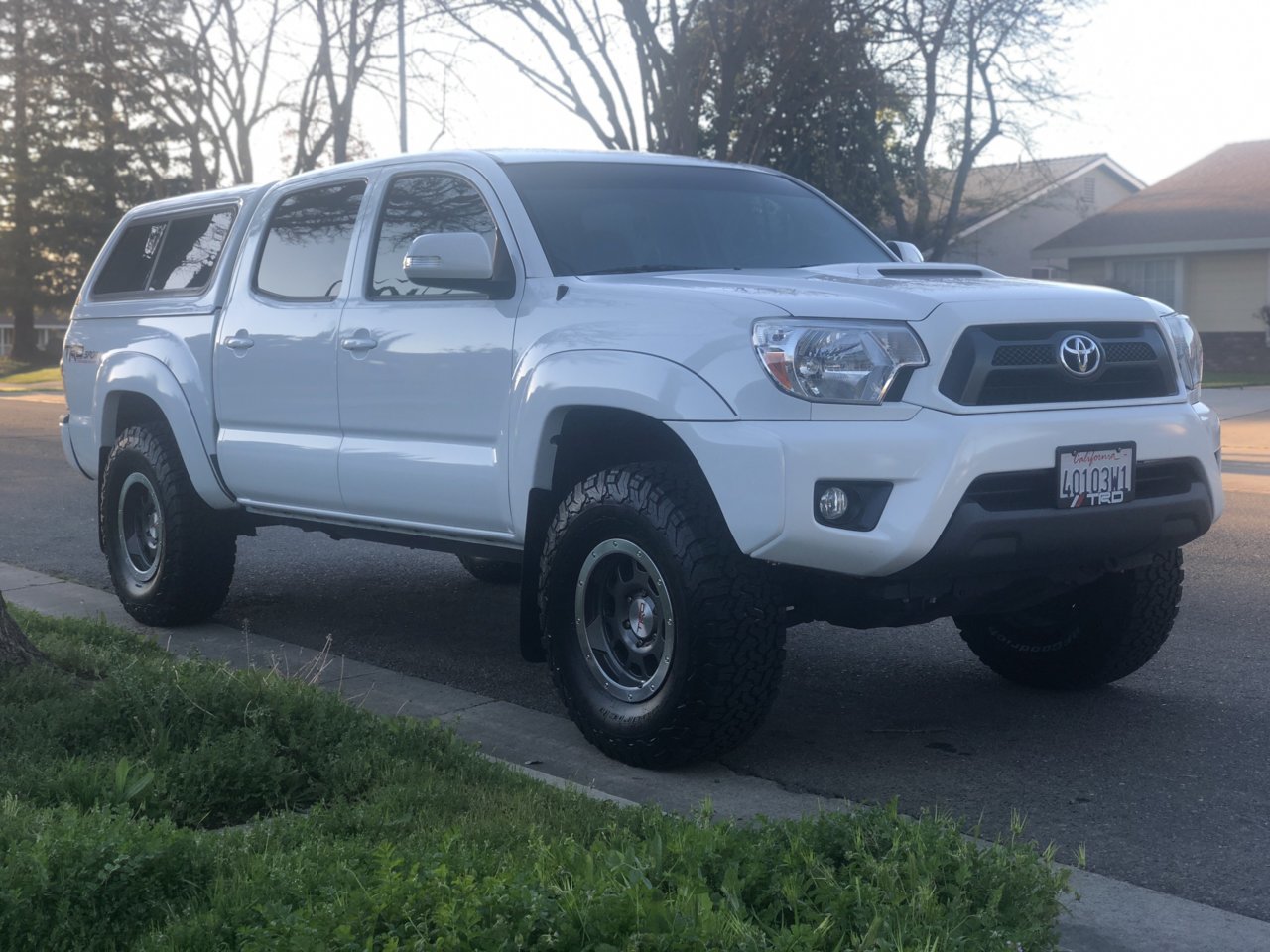

    #194711
    8
    2015 Trd 4x4 Tacoma

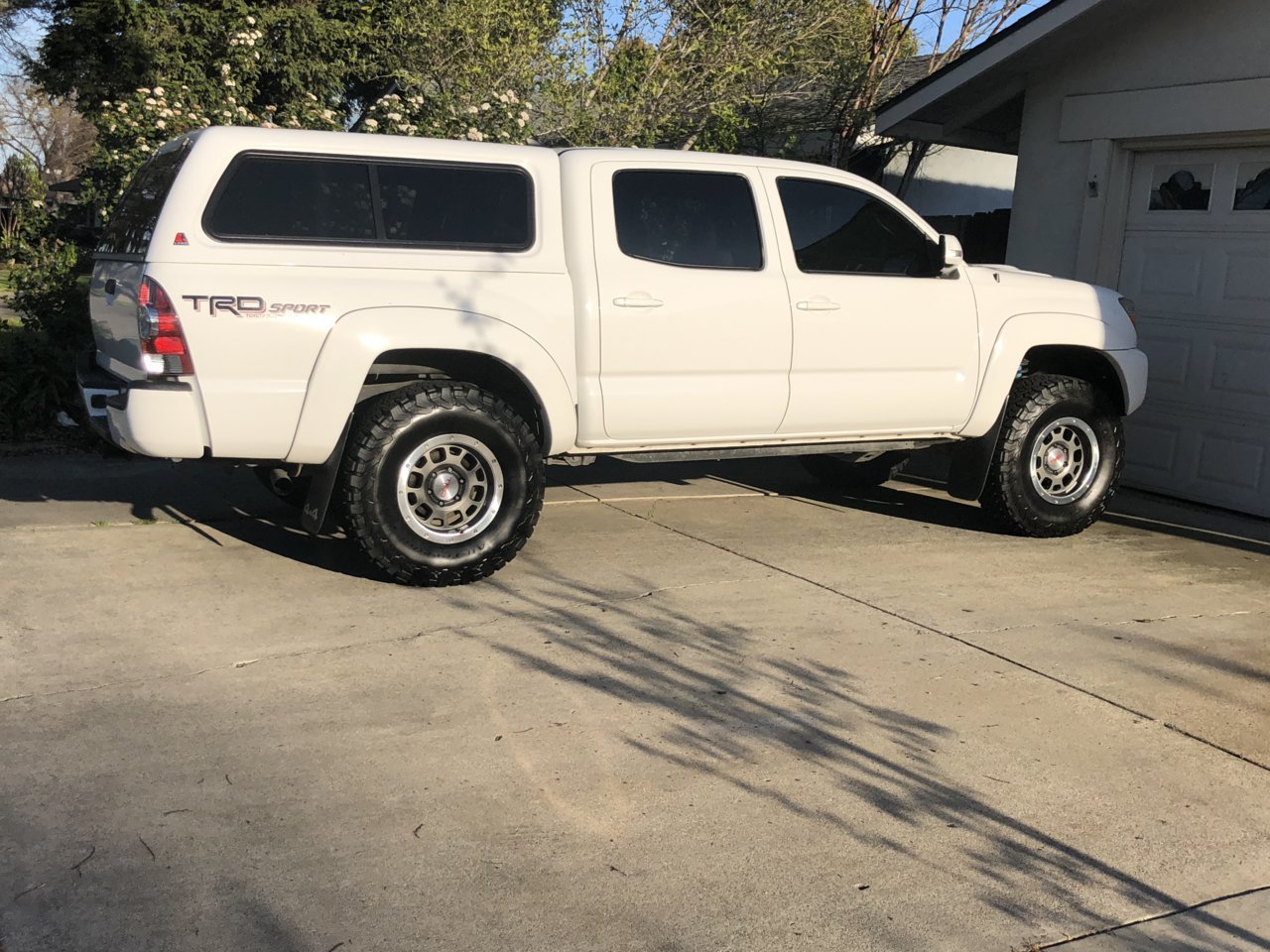

    17F2E643-A44B-489E-9A24-46AC2F749221.jpg 285/75/16 no rub on 3 inch leveling kit
  18. Mar 30, 2018 at 7:53 AM
    #38
    15yota
    15yota Member
    Aug 15, 2016
    #194711
    8
    2015 Trd 4x4 Tacoma

    Nice looking truck! What psi do you run with those tires? I have the same ones/same size. Just curious

    I’m running them at 33psi
