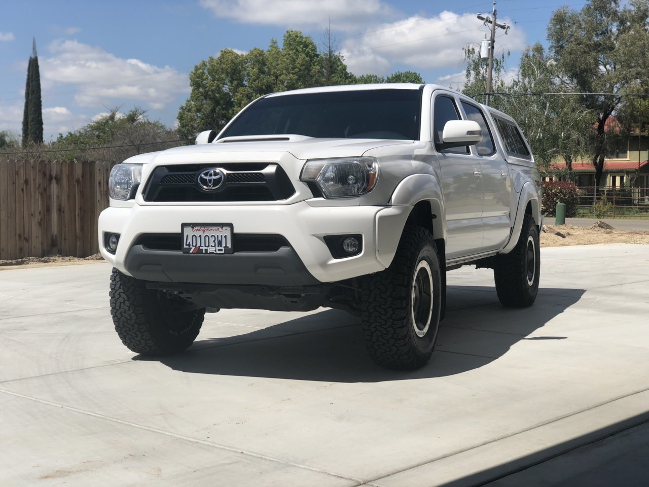

    594AB2CC-1D50-4E00-B607-D344FF867064.jpg 285/75/16 2 inch lift in front can pretty much turn all the way without rubbing but will rub at incline and decline a little. Truck floats on 285’s

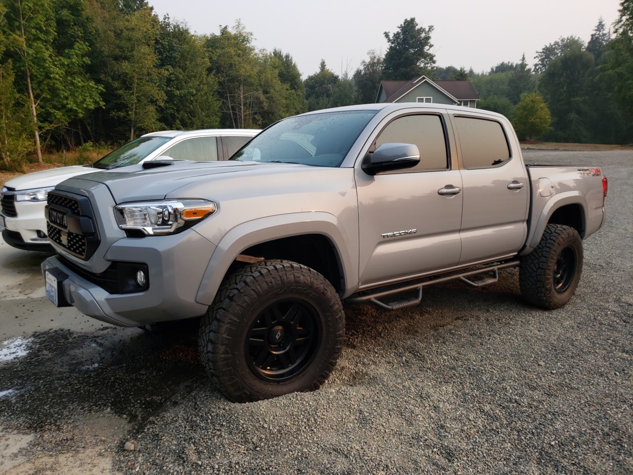

    Whether or not your tires will rub or not has more to do with alignment and wheel offset (and of course tire size) then it does with the amount of lift. The farther you push the wheel out (negative offset), the more likely you'll rub on the cab mount. Additionally, after market UCA's with built in caster will allow for more adjustment to prevent rubbing.
    More likely then not you're going to rub with a 285 size tire. If you have a positive offset, you might get away with not rubbing on fender or cab mount, but good chance you'll hit your UCA's. Even then, if you wheel offroad then it is probable you will rub, regardless of offset, when flexing.
    I run a 285 with aftermarket UCA's with extended travel coilovers and a -10 offset and it rubs really, really bad. 20180814_183728.jpg
