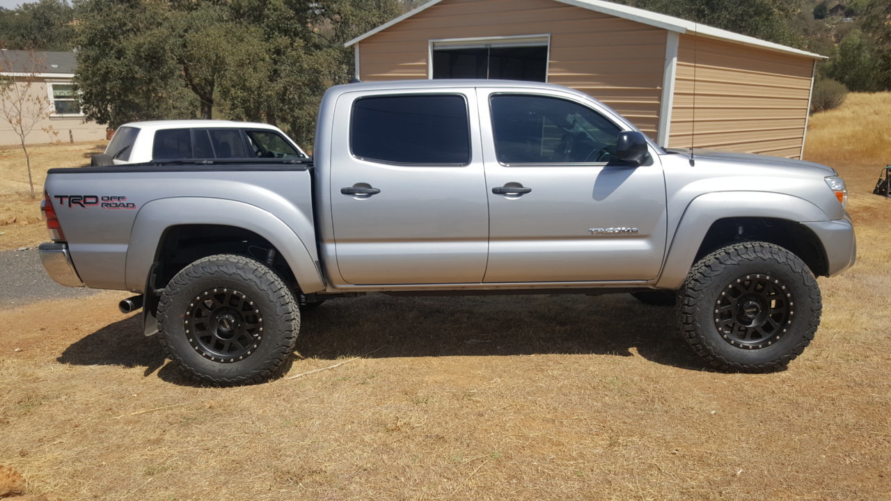

    Before the lift

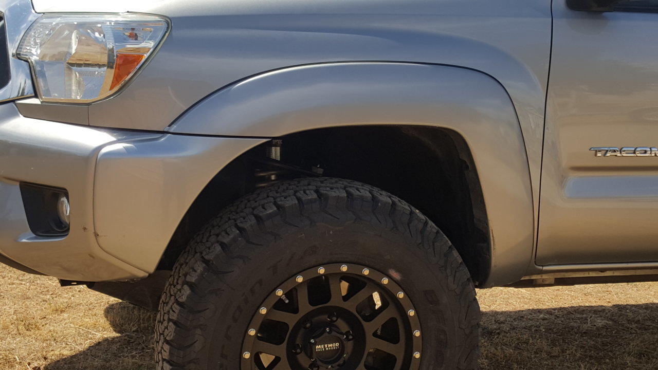

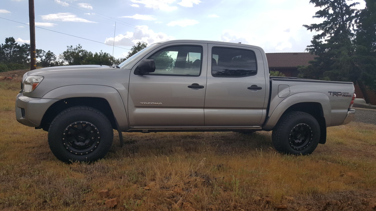

    AFTER it did rub a bit, so I cut and cut...
    Fox 2.5 lift
    Spc Uca,s
    Ome leafs
    17x 9, bs4.5 rims
    Bfg ko, 285 70 17
    Cmc
    Minor plastic surgery
    Pinch weld cut and rolled
    Kindadinosaur and FJ to Taco like this.

    Pretty much the exact set up I want to run.. how much did you have to cut?
  7. Sep 17, 2018 at 3:30 PM
    #67
    epiman500
    epiman500 Well-Known Member
    May 25, 2014
    #130566
    111
    ken
    LA grange cal
    2014 trd dc
    Cut the pinch weld about 2/3 of the way though and about 12inchs up then rolled it over, the flair was trimmed on the inside just to clear, same with the inner fender plastics. Not bad almost forgot also cut the cab mount.

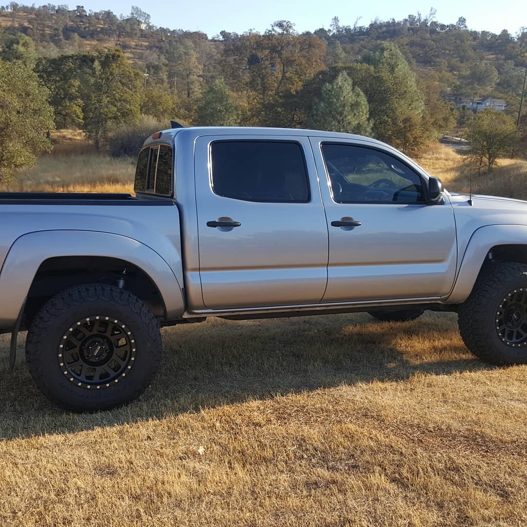

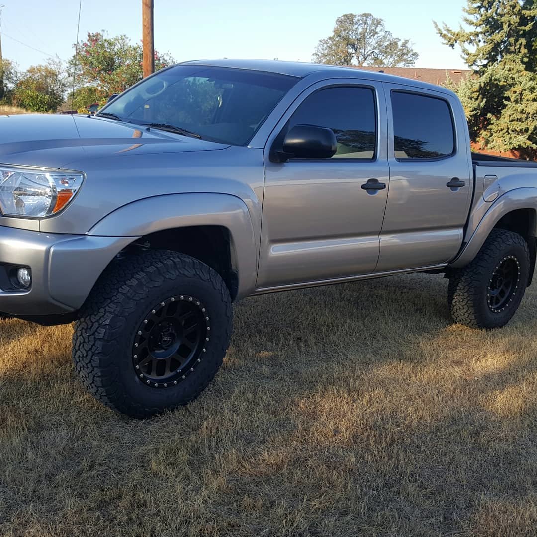

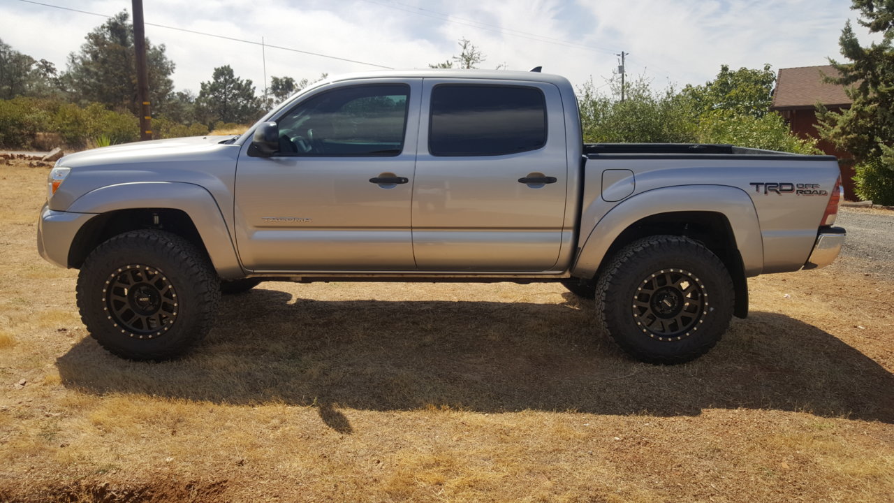

    Heres, a latest version IMG_20181021_092954_720.jpg IMG_20181021_092954_722.jpg

    I love the look and would like to beef mine up but I am afraid of losing the nice ride. It drives great now. Did your ride change much? Any shakes or death rattles with the lift? I'm mostly highway miles but like the look of the beefy tires.
  20. Oct 21, 2018 at 2:27 PM
    #80
    epiman500
    May 25, 2014
    #130566
    111
    ken
    LA grange cal
    2014 trd dc
    I got to tell ya ,I was sure that the ride was going to stiffen up, I do 200 miles a day on a two lane highway, and it rides better then stock by far, its unbelievable , handling is way better, not a single issue.
