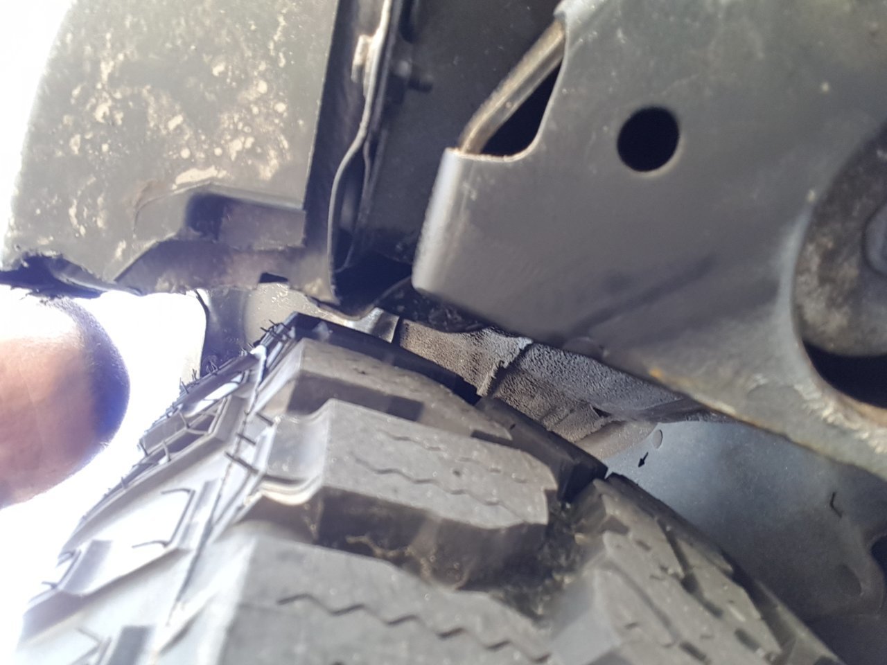

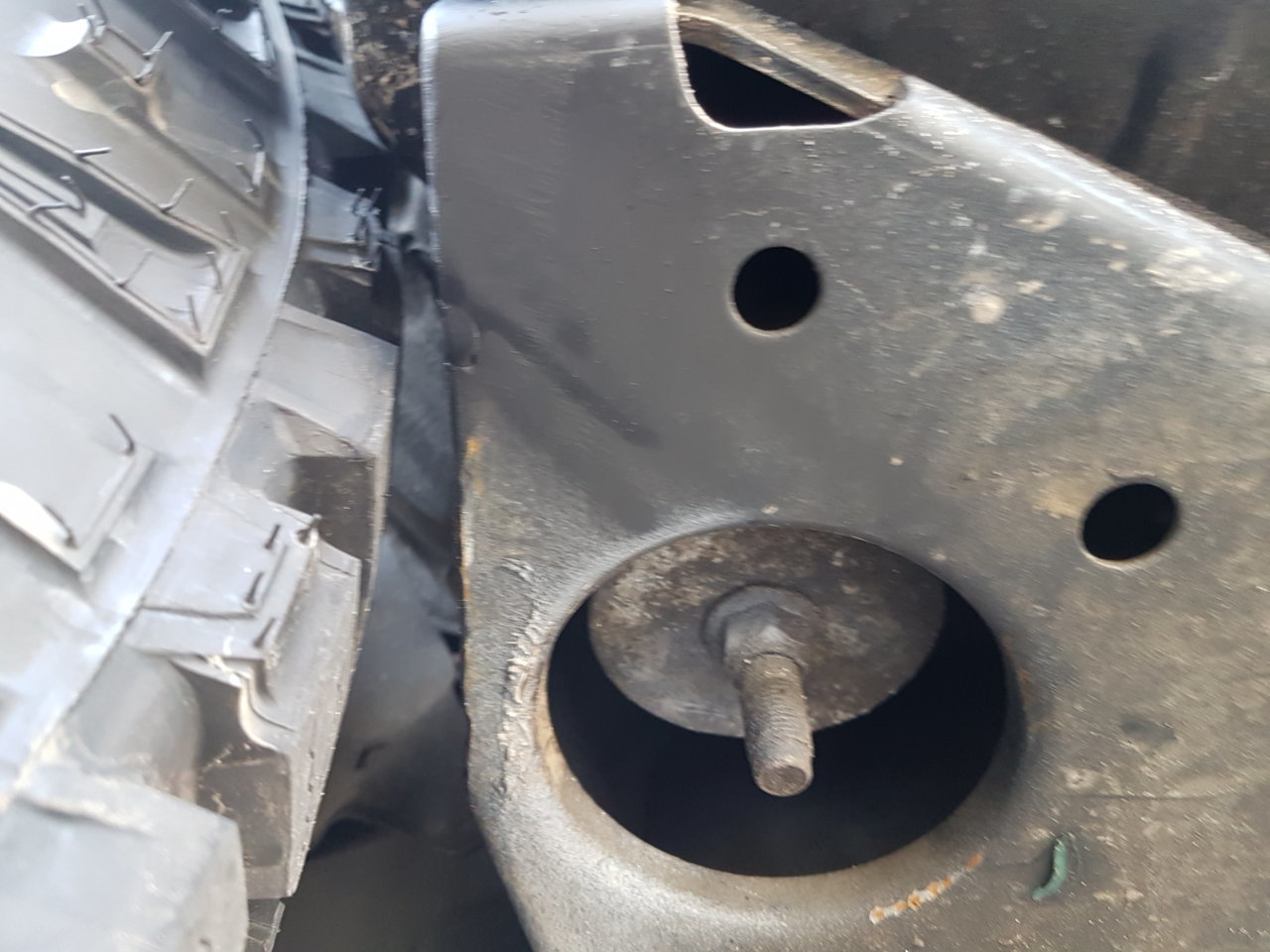

    With an extra bit of lift I can drive now but still have some rubbing when pulling out of the driveway rubbing on the fender.
    Body mount is relatively clear only time I have slight rub is in reverse full lock backing into the sloped driveway.
    Can't cut anymore as it's rubbing right near the mount itself so just need to deal with it.
  10. Apr 11, 2018 at 9:26 AM
    #30
    Joe23
    Joe23 [OP] Canuckistikian
    Oct 5, 2015
    #165909
    11,299
    The Great White North
    2017 TRD Off-road DCSB
