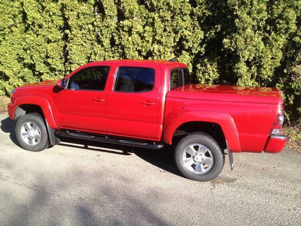

    You don't need to regear for 285s. IMO, I think if you go with 265s and see A Tacoma with 285s in person you will regret it.... Sounds like you want to get 285s... Might as well run 285s if you are lifting the truck. Here's what 265/70s look with a lift

    did u have to do any cutting on yours? and thanks for the pics
