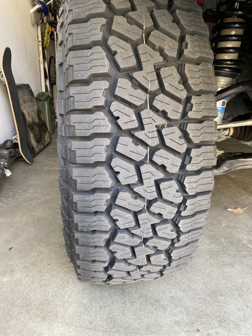

    Hello,
    Does anyone know the psi of 285/75/17 KO2’s? I just went to Discount Tire and put 38 on all 4 but I feel it like it bounces a lot..

    My 285/70/17 Ridge Grapplers are set at 35/36 PSI all the way around, and feel great.

    I’d personally chalk test the tires if I was you. There are enough variances in truck weight where you’ll benefit from a test specific to your vehicle.
    Not to mention fore/aft differences in pressure.

    Ply and weight make a big difference.
    My 285 70 17 8 ply duratrac is 40psi front 38psi rear COLD
    Although it is smoother at lower PSI chalk test put this PSI as my most even wear and it seems to help my MPG a little better because before I did the chalk test and ran 35psi all around I was getting worse MPG.

    This is the best way to know for sure and get the best tire wear

    I had never heard this chalk test but sounds the best... any idea of PSI to start the chalk test? you can use those big chalk from any store right?

    Here's a how-to for it. And yes, any childrens sidewalk chalk (or any chalk for that matter) is what you use
    https://www.intercotire.com/using_chalk_method_determining_psi
